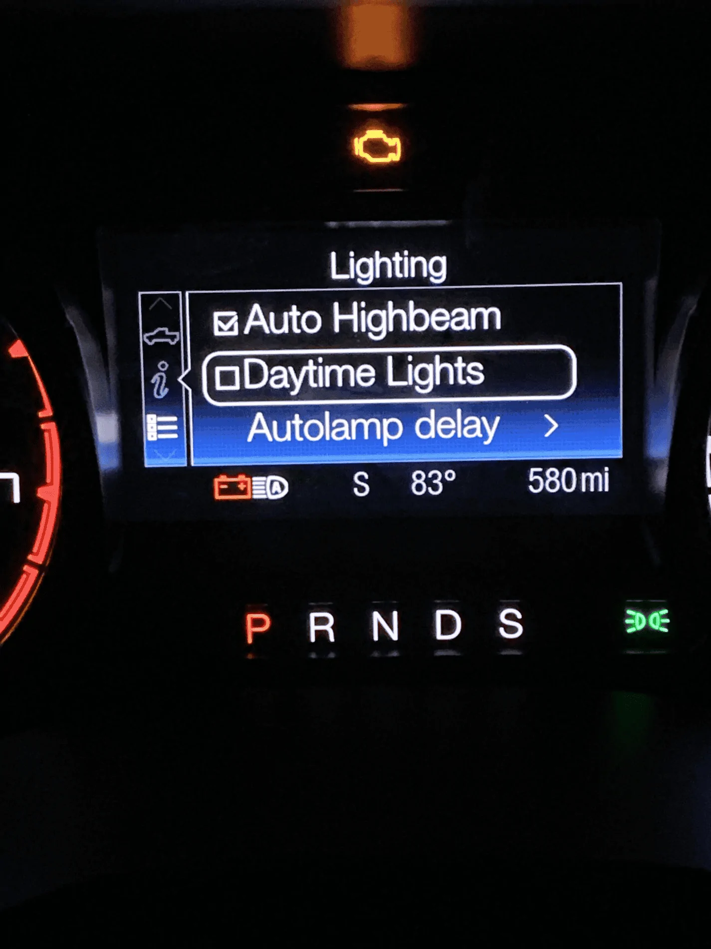

I'm stumped :confused:, I followed EVERYTHING, double checked, triple checked. The LED strip DRL does not come on. I set everything like shown. Checked the hex code, everything matches. DRL's do not come on when in drive (or neutral with hand brake) I've spent a couple hours messing with this so I'm just gonna step back for a bit and do more research.
Do you have DRL selected in - IPC settings-(Daytime Lights)
And
Are you testing in full daylight?
I don't know TBH, I just followed what you posted on the first page. Started in "allowed DRL" then went to "DRL" and then went into written to verify the "codes". I was in my garage with the lights on (bright LED's) if that make any difference.
I know the DRL's work per se, when I remote start the vehicle in the morning to let the truck warm up, they are on when I go in the garage, then turn off when I turn the key on. Everything else works fine, lights, brights, blinkers, no hyper flash or flicker. Just the DRL's don't come on while in drive. I'll check the IPC setting when I get home.

You are looking for a screen like this one: Make sure Daytime lights is selected, plus depending on how bright the garage is, they may not come on - that little clear bubble (sensor) on the center dash is the light sensor, it triggers the Headlights on, the sensor is very sensitive even a cloudy day will keep it from tripping DRL's on. if headlights are on, the DRL strip will be dim and when the headlights trip off, the DRL strip should be on Full Bright
Plus make sure Headlight switch is in - Auto, for DRL - Full Bright to Work
