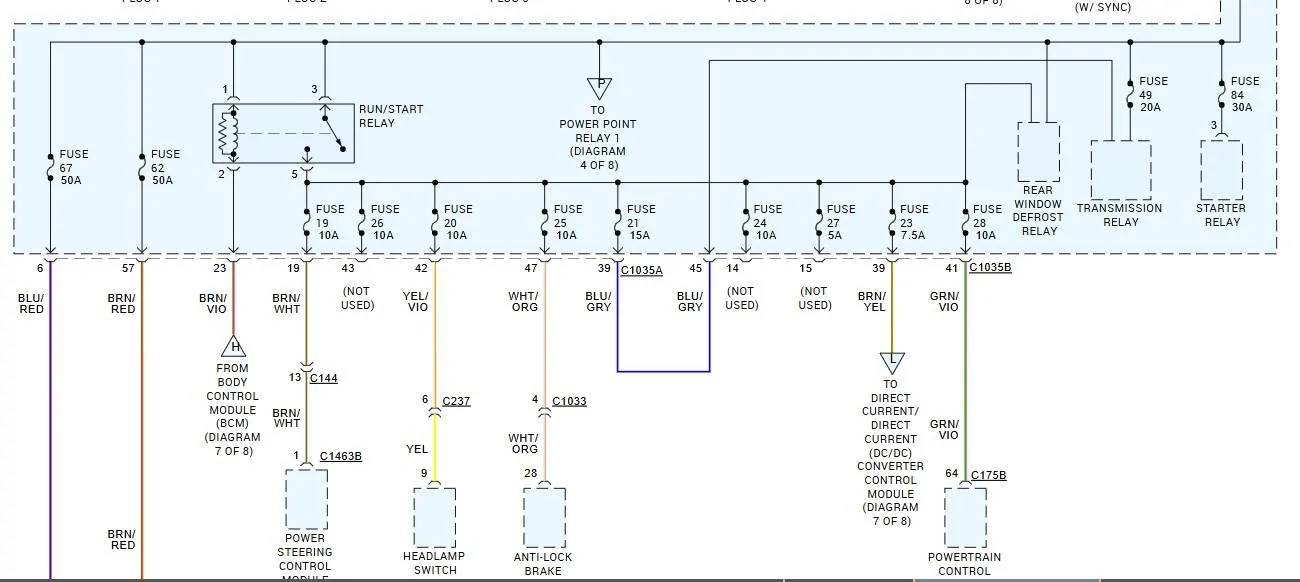

A visual view of the wiring diagram - Helps
So as far as I know (All US Version) Rangers have Fuse #24 listed as (Not Used)
The differences come in (2020-2021) time frame as to if the internals of the Fuse Box have the needed contacts (Mounted to the PCB) and then also if the fuse is installed - does it have both sides of the contacts or just (Input Side)
If both sides are present, then you have the option to install a (socket) in the connector (C1035B)
Pin #14 to tap the power source.
This gives you a cleaner install and tap point.
If you are do not have any contacts at all and no fuse installed, then if you are handy with soldering a PCB then you can find a (Micro2 Fuse) socket terminal and solder one on the board and then add the terminal to the connector.
Yes, some extra work just to get a tapped power source, but I am giving you options over having the (Fuse Tap) wire being pinched off by the cover or having to create a slot for the wire which leaves sharp edges than will eventually chafe the wire unless you slot it and add a wire grommet.
Yes, there are drawbacks to adding a fuse tap unless you take extra precaution to protect the wire.
