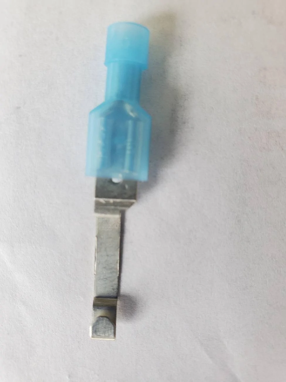

Anyone use a fuse tap like this?
Are there problems with using this type of fuse tap?
Does it damage the fuse socket?
Thanks for the help.

I have used this type of Tap on previous vehicles and actually had this type for my (Head Unit) (RAP) Power where it held all the presets/ clock etc.
I did have to (reseat) the fuse on occasion as over time the contacts in the fuse box were spreading from the extra thickness that is added by the tap.
So yes, they work, but they will eventually require you to spread the tap end out to take up any gap created as time goes by.

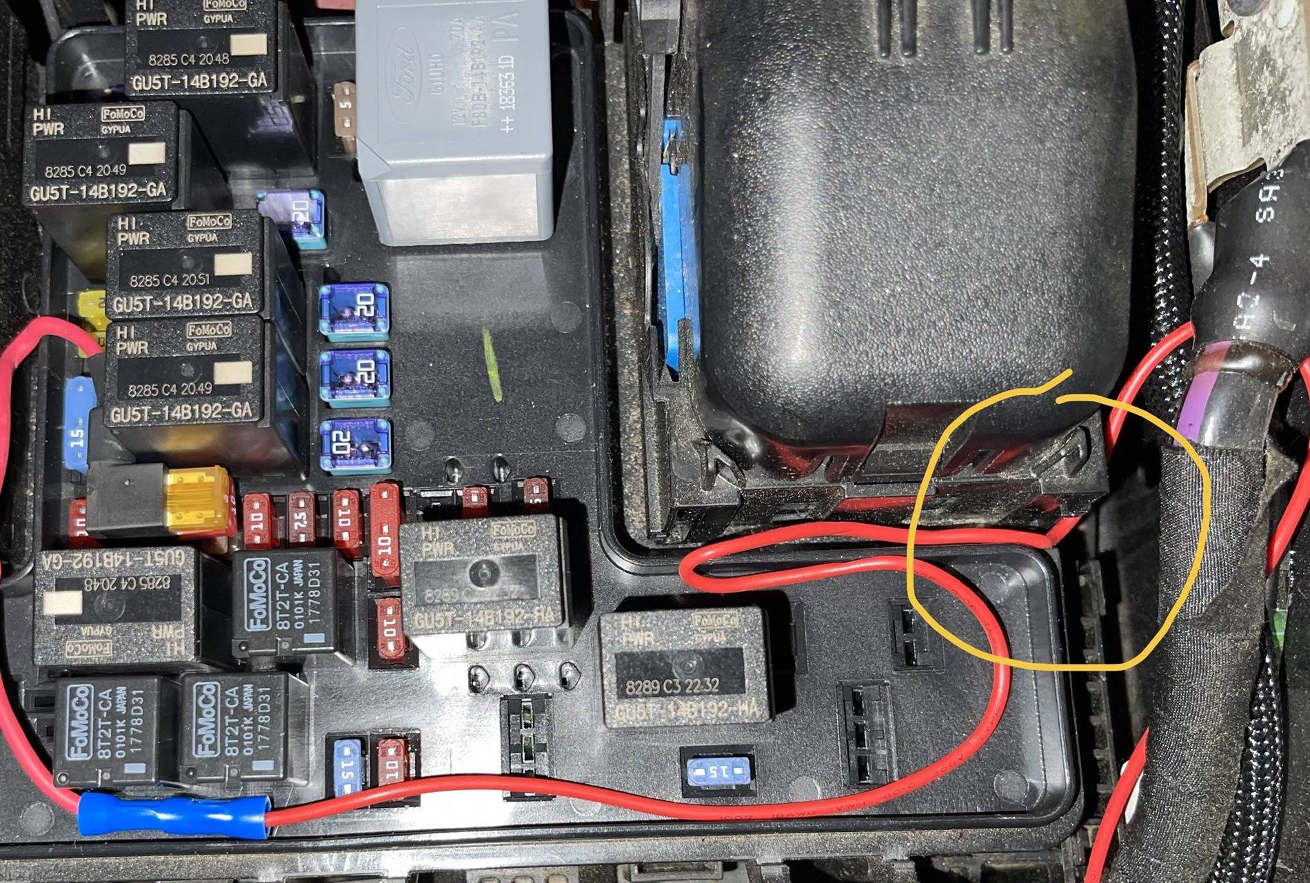

I did not know this about this style of fuse taps as I never used them but in order for them to properly protect (2) circuits they must be (Installed) in the correct orientation.
The picture below shows (IMPROPER ORIENTATION)
Reason: The side that the (wire exits) is the (Output Feed) side of the fuse
This is tapped into Fuse #19 Slot
With the (Vertical) Fuses (pictured) the (Source Feed - Contact) is on the (Most Forward) Pin or the one closest to the cab.
So, with the below install the lower fuse is taking the current of both fused circuits
So, if improperly oriented (like below) if there is an issue on either circuit the Bottom Fuse could Blow and take both circuits vs separate circuits as the tap is intended.
I find it somewhat amazing that this is not highlighted in the install packaging or instructions from most of the manufactures of these taps and I only recently noted this from the latest posts about taps and locations, I never thought that these were (orientation dependent) but they are to get the (Full - Intended Usage) of the tap.
Intended Function:
Two Sperate Circuits - Protected By (2 Separate) fuses.
Improper Function:
The Lower Fuse (OE-Circuit) is being used to power 2 separate circuits, so you have an amperage draw across the fuse before it reaches the (Upper -added circuit) fuse, so depending on what you are adding this may create issues with the device you are adding, and it is dependent on the device power requirements (it may not like the reduced power) that is actually being feed to it.

So Real World since I think all owners who have tapped (Fuse #19) with a fuse tap have not experienced the (fuses blowing) but however there are reported issues with (Headlights) and this tapped source, and this would Highlight some of the various intermittent issues with them as a possible (Fuse Tap) orientation from the tap (MAY) be the source of the issues.
Too much amp draws for the 10-Amp fuse feeding 2 outputs.
But other than that - it appears the circuit can handle being tapped improperly; it works but it's not as it is designed for.
