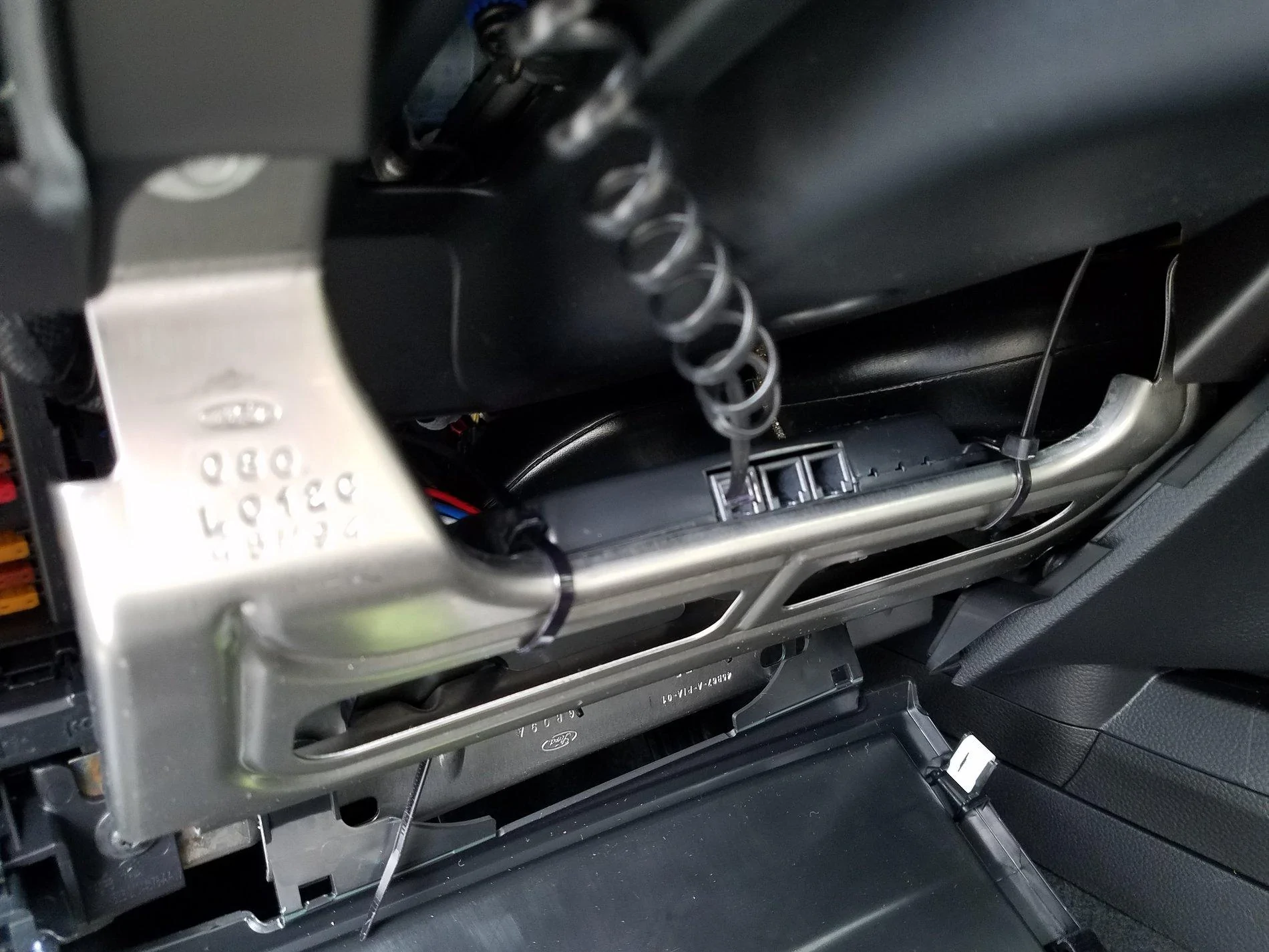

Remote Unit installed in the dash:

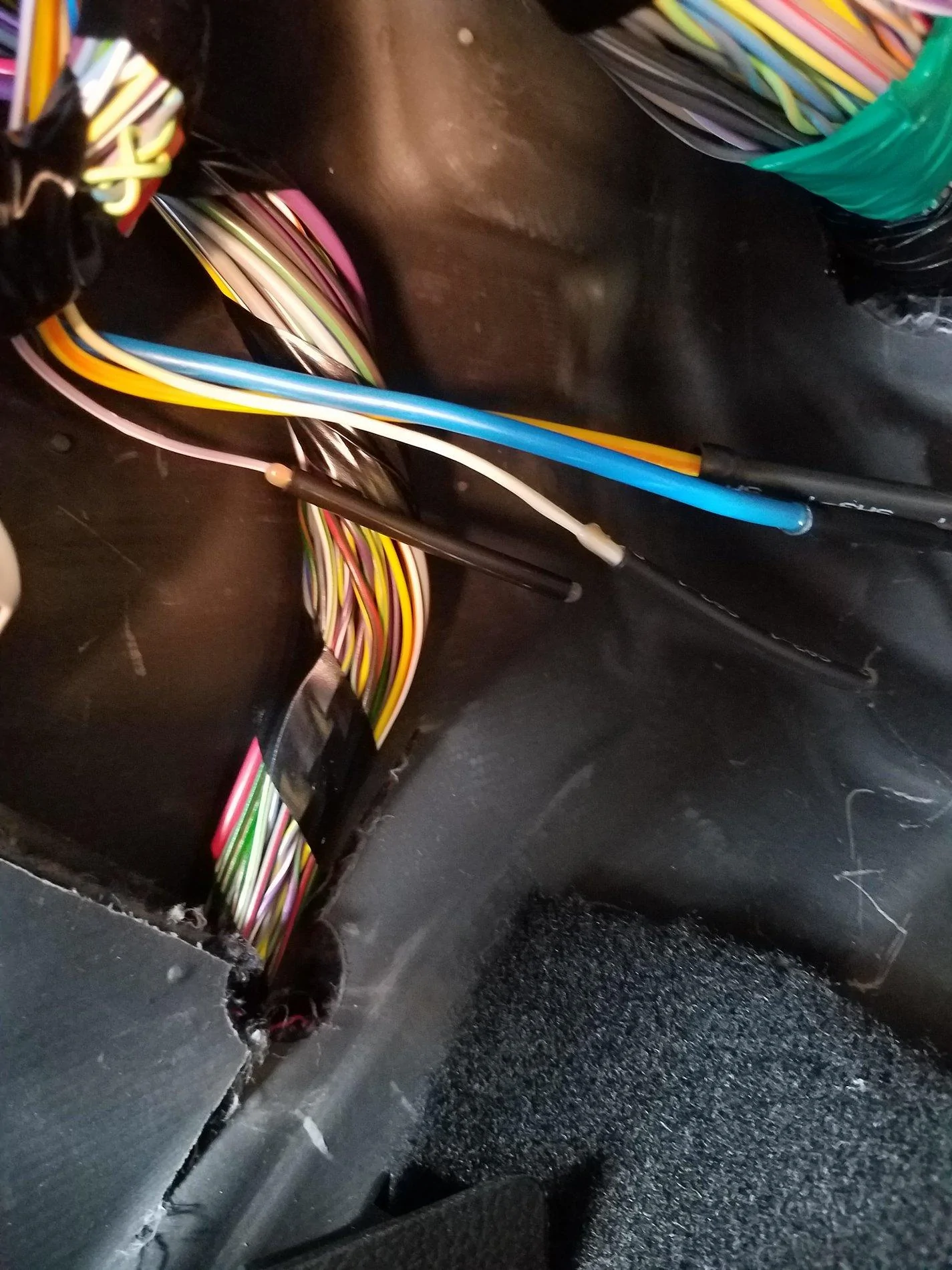

The newest Rangers are coming with blue trailer brake wires now:

Today I installed a Tuson DirecLink Trailer Brake Controller, model DL-100. I had originally planned on installing the RedArc, but couldn't get past the little button and the different colored LEDs, after towing for years with controllers that had the information screens - I'm getting old and like the info screens.
What I liked about the DirecLink, while researching, was the additional OBDII plug that allows the controller to monitor the vehicle's computer. I figured this was the closest I was going to get to what I had with my factory installed controller on the F250. That system was far superior to any aftermarket controller I ever ran, as the braking was much smoother. One added feature that I really like on the DirecLink is the ability to set BOTH high speed braking AND low speed braking. As good as the factory F250 system was, my only complaint was that I always had to dial down the gain at the end of my trips during the slow speed portion, to keep the trailer brakes from locking up. With this system, I can set up both the high speed and low speed braking adjustments initially, and then forget it.

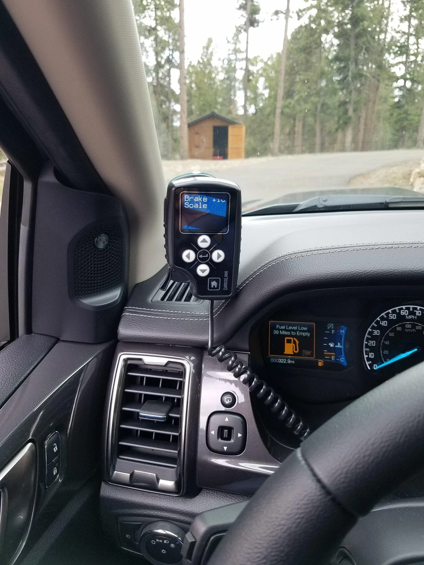

Controller Unit, mounted where it's easy to view the screen information:

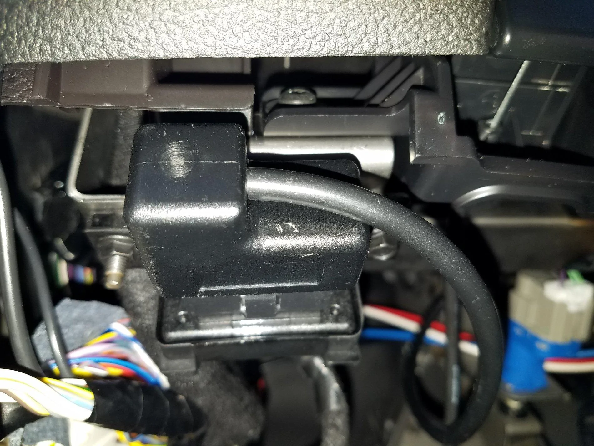

OBDII plug:
Interesting, we might need to check build date comparisons to see any correlation
My build was 1/31/19 w/ Blue wire.

I have not road tested yet, but did driveway test it, and braking seems to be working fine - both the signal coming from the pedal and the signal coming from the manual brake override lever. It gives me a real time visual bar graph and numerical braking percentage of the trailer brakes on the controller screen. Also, DirecLink makes it pretty easy to use with a full array of onboard diagnostics, including 7-pin trailer wire connection/no connection, and will alert me to a number of potential issues regarding wiring problems, wiring disconnects/shorts, etc.

Pretty easy install overall. Biggest issue is contorting yourself under the dash to get the 4 factory wires spliced into the 4 harness wires.
The OBDII plug reading vehicle computer information is also pretty cool. It utilizes the computer information on vehicle speed, rates of deceleration, etc. to assist in properly applying the trailer brakes to keep the trailer braking as smooth as possible.
