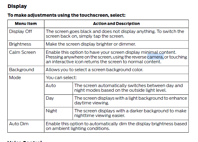

I think there's an option to turn display off, and then to turn it back on you just tap it anywhere, I haven't tested this as of yet.
My display isnā€™t touch screen. I have a button that turns the display off and on but it doesnā€™t work when I put the truck in reverse, the screen comes on full bright and I canā€™t turn it off until I go into a different gear.
