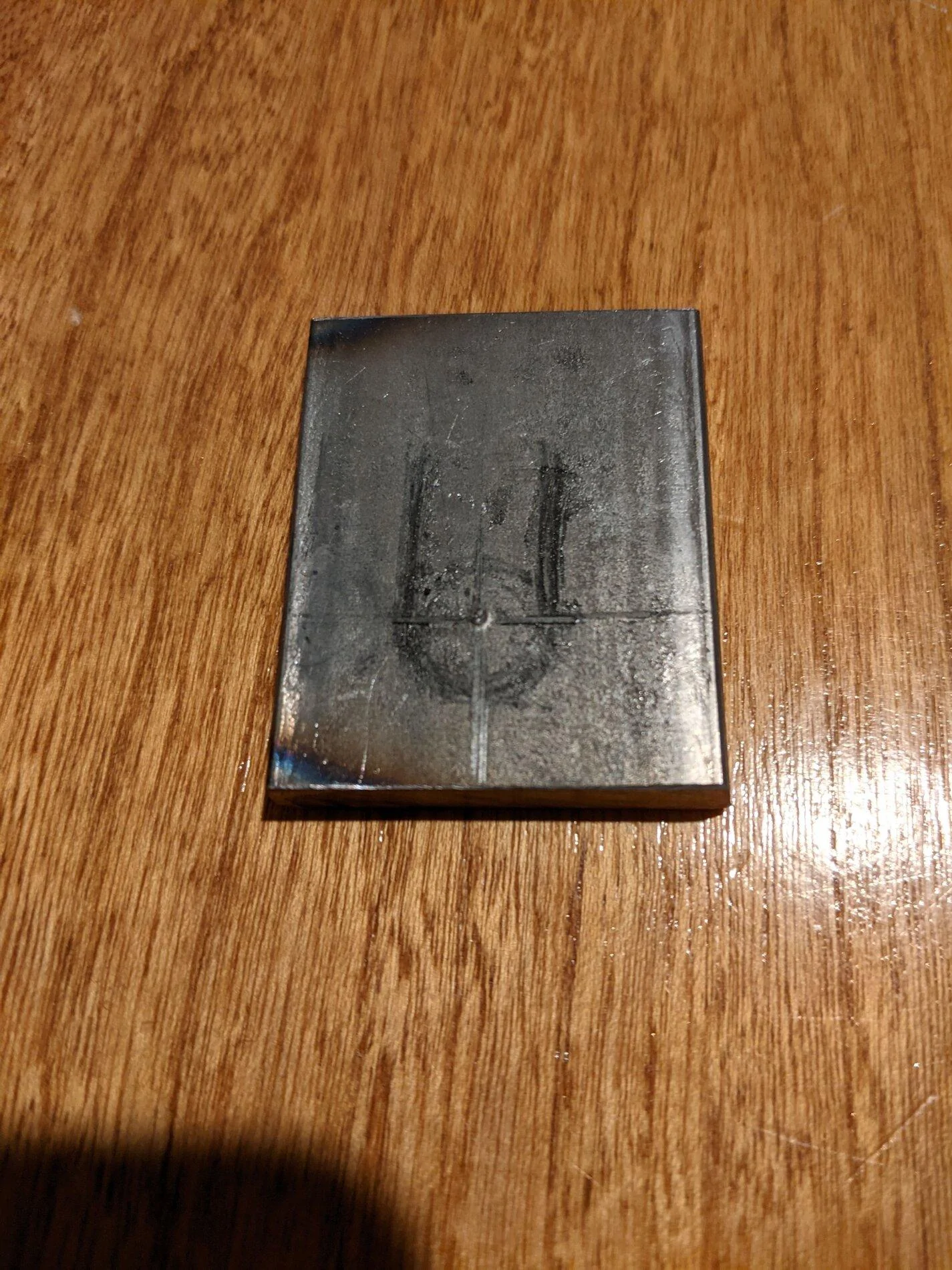

So knowing 3/4 of an inch was good for my truck I purchased the following flat stock from Lowes
Hillman 1/4 x 1-1/2 x 4ft flat stock
I cut the stock in 1 3/4 lengths. Then placed one on the center bearing bracket to create a template.
Transferred the center point to the other shims
Center punched them and drilled the holes on a drill press and installed.
Truck is silky smooth now..
