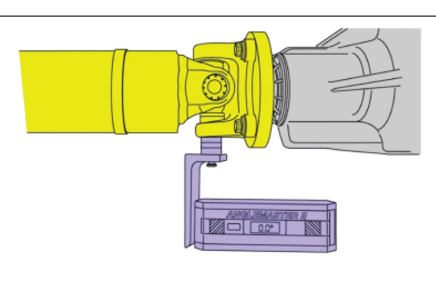

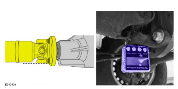

Just an update, folks. Swapped out the 1 degree shim to a 0.5 degree that I had machined from an extra in the kit. Shudder is still there on occasion and when there its about the same as the 1 degree shim. Still 100% convinced its the out of phase 2 piece shaft. I bought this truck to go to 200k and I just don't think a shudder like this will bear well for the carrier bearing and u-joints over time. I am on the fence on re-indexing the shaft.
I will say, I think I know why dealers are installing this kit wrong. The factory service manual mentions measuring pinion angle by removing the u-joint clip and inserting a device into the cup that is attached to the inclinometer. This is in fact different (even by illustration) to the procedure outlined in the TSB for measuring. The TSB did help. So make sure you go over this specific detail with your service technician.
