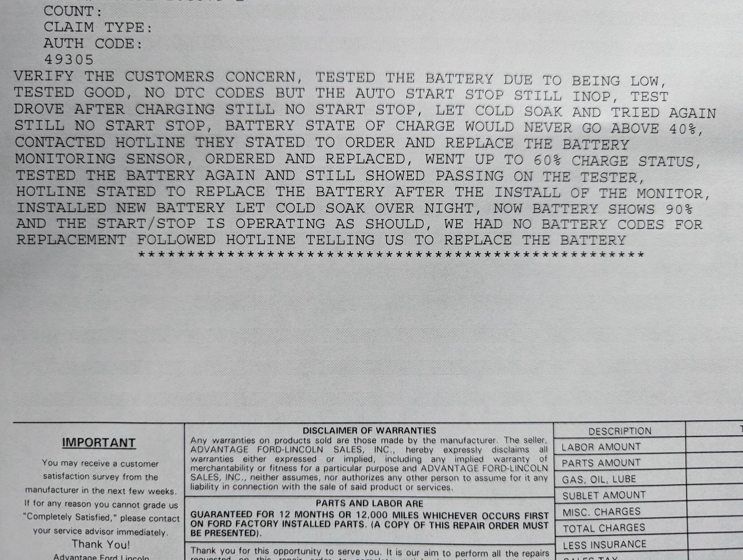

I never made it back to the dealer as I've needed my truck since I last posted. What I did figure out is after a full charge on a battery charger I'm only seeing 12.34 volts. It does test "good" on the part store tester but I'm pretty sure there is a dying cell.
Like I said I don't feel like hassling with a dealer on a truck that I technically don't own right now. Maybe I'll try a different dealer eventually

I finally took my truck to the dealer. They had it for 10 days. Battery tested good multiple times. Feild engineer looked at. They finally had to call Ford. BMS and battery replaced. Seems like a faulty BMS which then weakened the battery.
