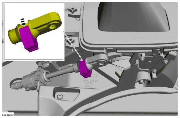

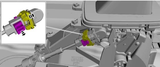

It will need T-Shot to pinpoint it down, Selector Lever Assembly - Knob Assembly - Cable Assembly or Internal Transmission but a good place to start is to ensure this clip lock is fully seated and secure.
Pull the console panel up to reveal the clip and also attaching hardware.
This has been known to become unlatched.
It appears the above is a redesign and below was the original design which had issues.
IDK for sure but the manuals have these varied pics.
There is a adjustment on that cable and its posted here - Post #22
