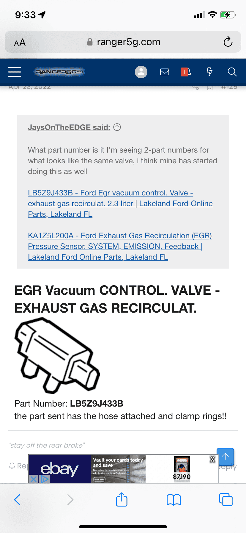

I pulled this from the other thread. Can you confirm this is the part? Just want to loop the two threads together for future readers.

I purchased part LB5Z9J433B
