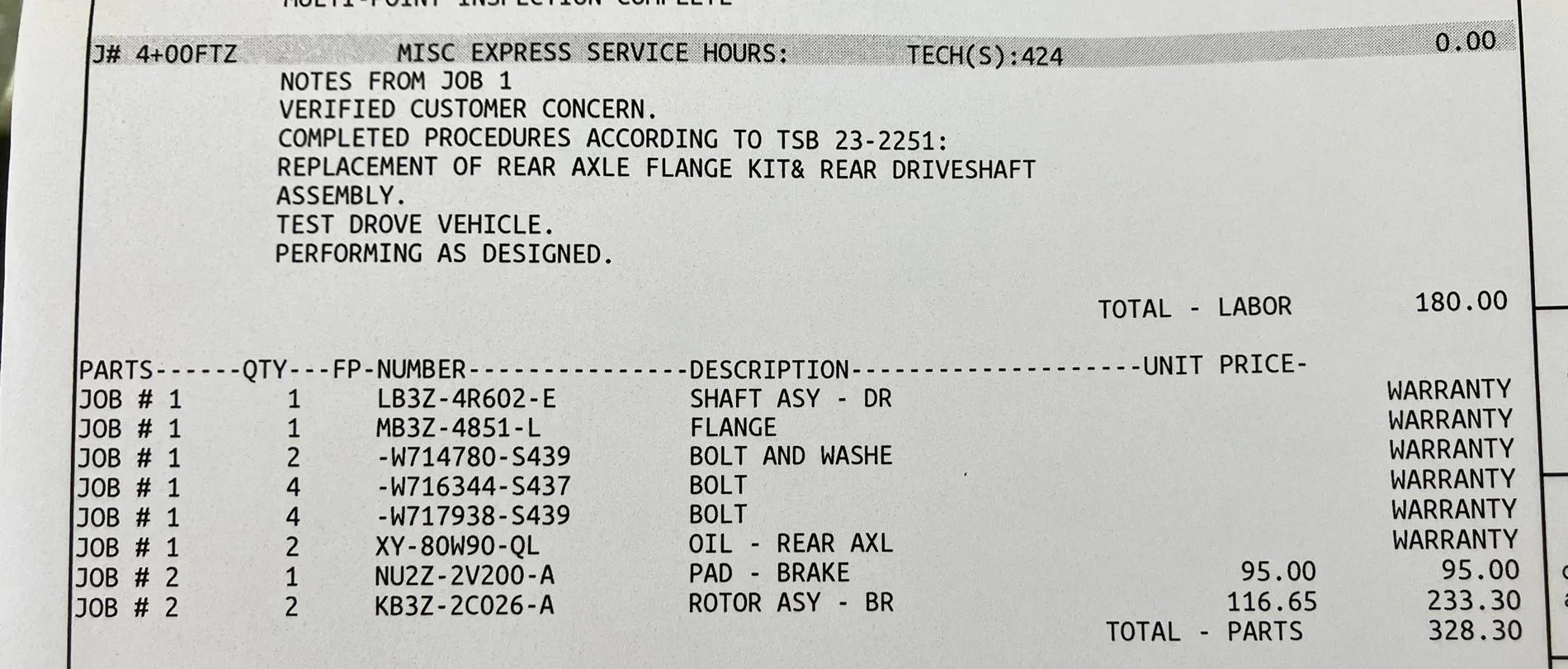

Update: dealer called after lunch...now they say its the Slip Joint TSB and pinion. All covered under Ford ESP. Looks like several business days on parts. I'll be making use of a loaner starting Monday.

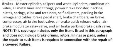

A TSB should have nothing to do with your ESP. Don't let them charge you a deductible.
Good to know. I’ll remember that and check it once they get it done.

Update: picked it up today. They have redesigned the driveshaft assembly. They replaced the entire assembly and rear flange under warranty and listed the TSB#. I attached the parts list. No thunking or shuddering as of now.
Now at my tire shop getting new shoes. Will update that thread with pics in a while.
It’s technically not a redesign. It’s the driveshaft that’s in the Tremors. Uses a Rzeppa joint at the differential instead of a ujoint.
