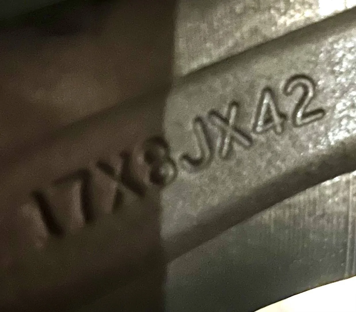

They should be stamped on the back side of the spokes.
One spoke might have say 17x8 or 8x17, then another spoke might have the offset. It could be ET42, or whatever.
Confirmed they are 17x8x42

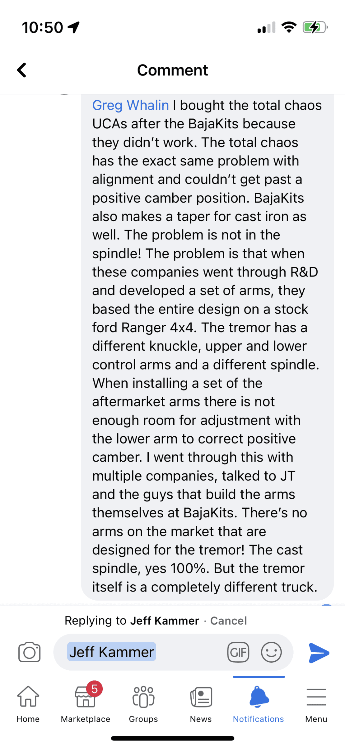

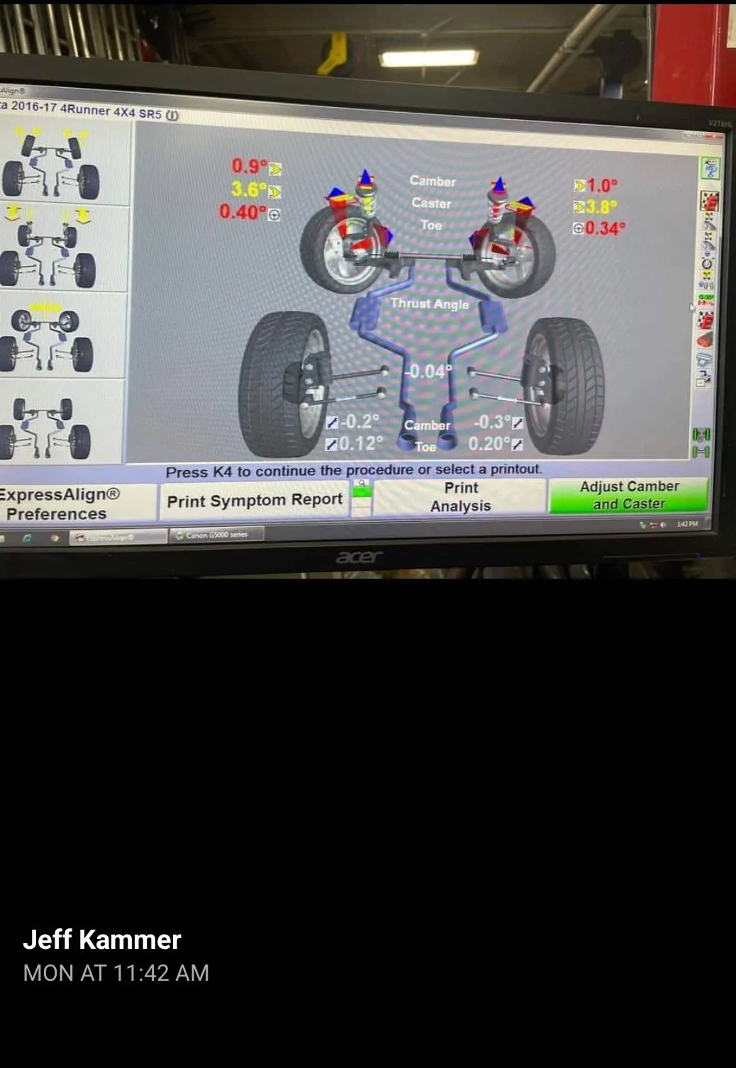

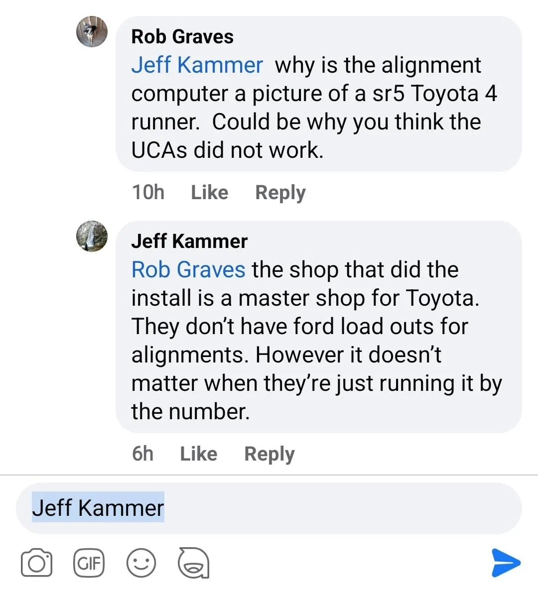

Some guy on FB is saying that no aftermarket UCA works on Tremor. Saying impossible to align. As some of you on here clearly have aftermarket UCAs curious what you think about this?
I read this his comment on the Facebook page. Something is a miss. The pictures in the post are a mix of a ford tremor with Toyota SR5 on the computer alignment machine selected.
I'm pretty sure the Tremor has the same control arms. The knuckle does require the tapered ball joint.
There are several people here rocking aftermarket UCA without any issues, so I don't believe that FB post.
And a few companies make them as well.
Maybe his shop sucks.

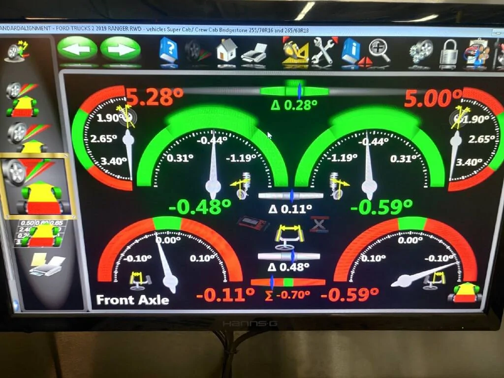

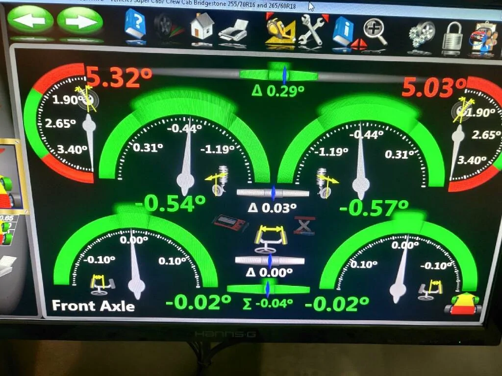

Here's my before and after alignment with the bajakits long travel. Got my camber and toe in, but had to keep positive caster. That's the only "out of the normal range" thing I can report on.
Positive caster is a good thing on a lifted truck.
I ran 6 degrees positive on my lifted jeep.
For those of us that do not know how to read this screen. Can you break it down?
Camber
Caster
Toe
Superdannyboy
Jan 1, 2020
1,099
1,373
75209
Of course.
The top 2 are caster.
The middle 2 are camber.
The bottom 2 are toe.
Heck I didn't know either until I asked the mechanic.
Edit: I had the middle and bottom mixed up and I corrected it above.

Here's the response from Facebook.
I did say someone call the bluff, lol I was referring to the Facebook comment if that didn't make any sense earlier. What's exactly different about the knuckle? I know in general there are aluminum and cast iron, but does the tremor have a different geometry of the knuckle altogether?
Here's the Facebook response
I don't understand the issue, which alignment spec can they not get to?
Camber and caster look fine. A little extra positive caster is helpful for lifted trucks on bigger tires.
Toe is set with the tie rods.
