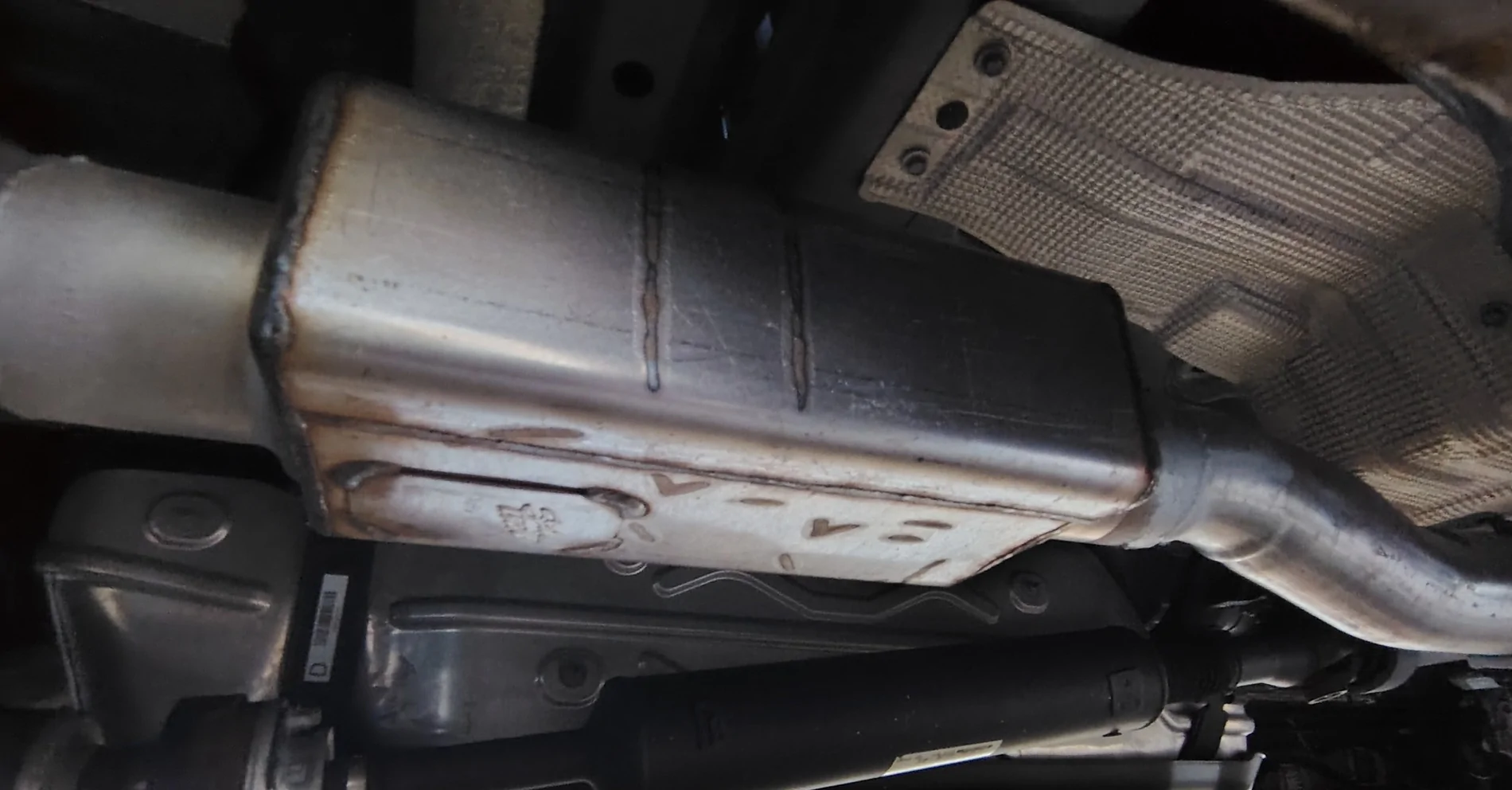

If you're really happy with the MBRP exhaust, something to consider is installing a aftermarket Resonator like a Vibrant Ultra Quiet 3" as close to the cat as possible or anywhere you can fit it before the muffler. It Should tone things down without restriction.
They make Resonators in 3" for your set-up.
Coming from experience
Good luck!

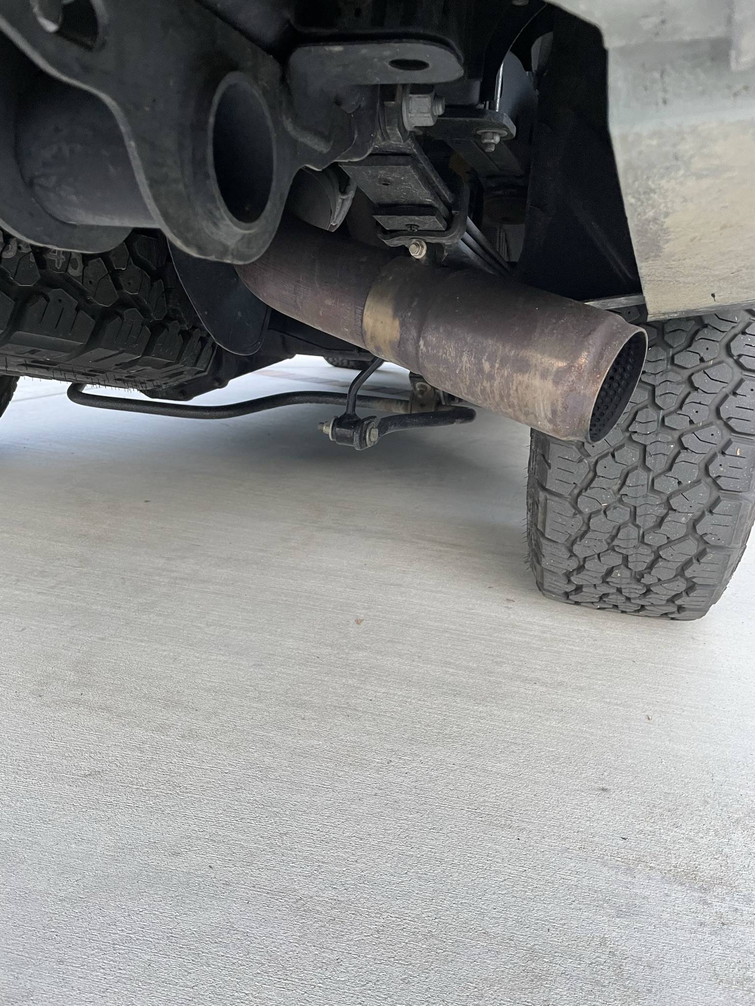

Before you do anything, and I don’t know if this is because of the tremor or it’s because of the towing bar/receiver/etc., but I’m pretty sure it was the MBRP and the guy had to in the tips downwards.
The only other option was Gibson and I’m pretty sure it was MBRP.
If you search around, you’ll find it I think.
I wouldn’t have been happy if that’s how it turned out for me it was notable.

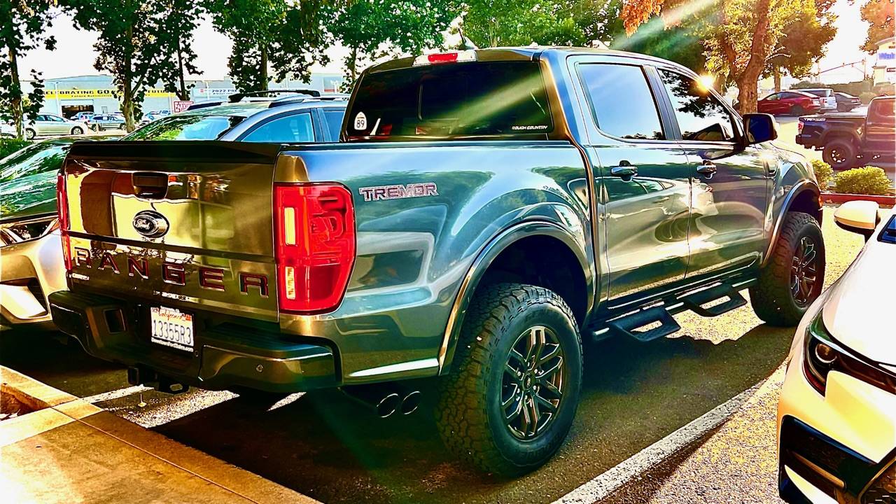

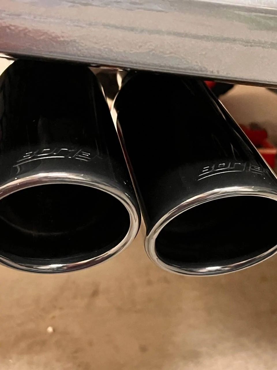

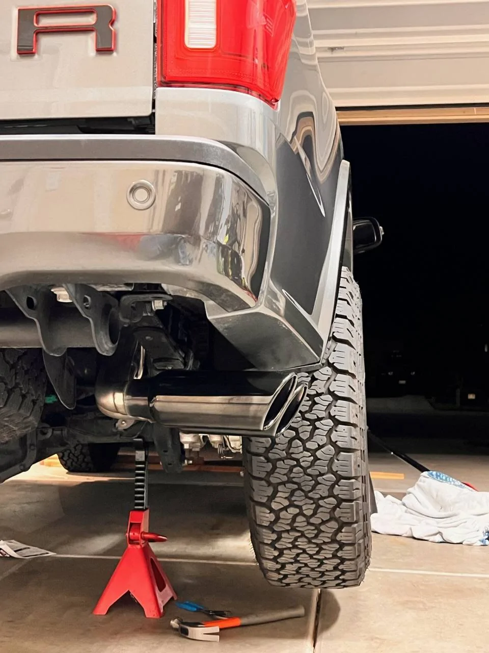

21 tremor with borla exhaust. Not to loud , and I love the cackling. Took 15 min to install.
seriously, man! Doesn’t it just flat out rock?!
I wrote elsewhere that even with prior examples, my Borla asked tight is my favorite! It gives some burbles and pops, but not so many. I think a tuner will pull out a little more of it.
Then it’s the only cat back I’ve ever noticed. Actual power gained and recorded material mpg increase.

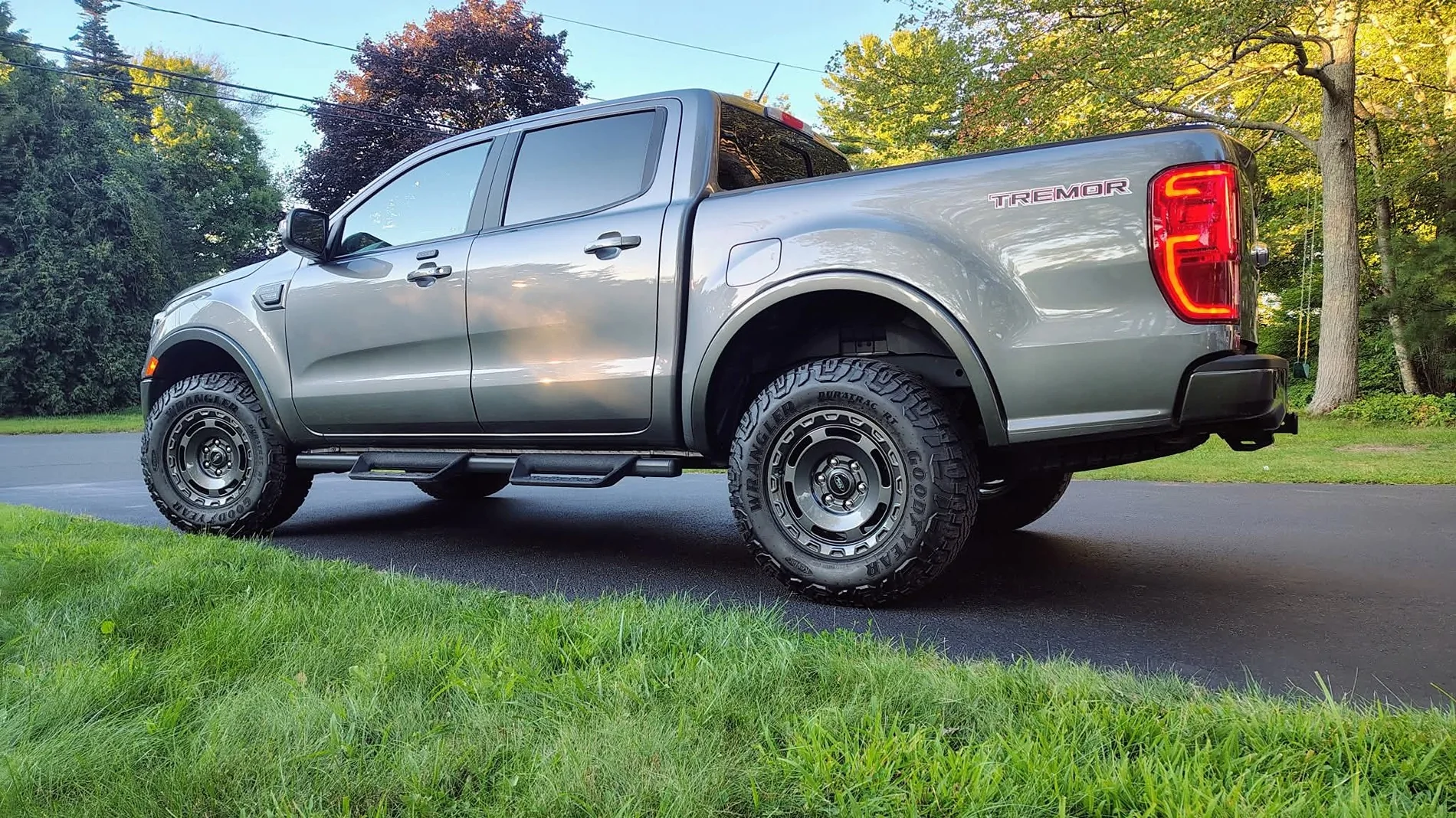

Those Borla tips look awesome.

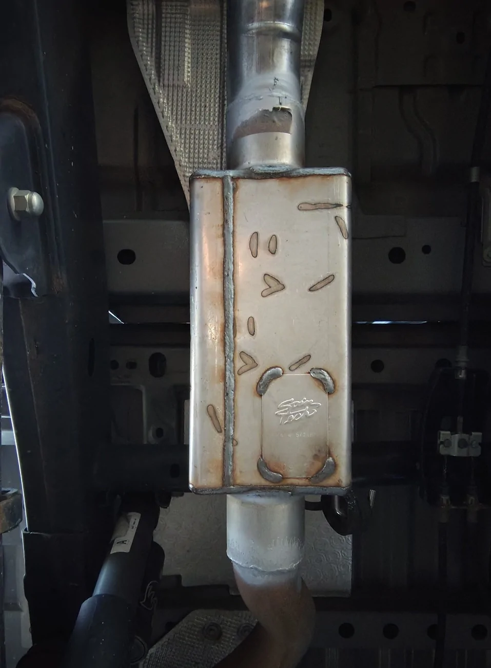

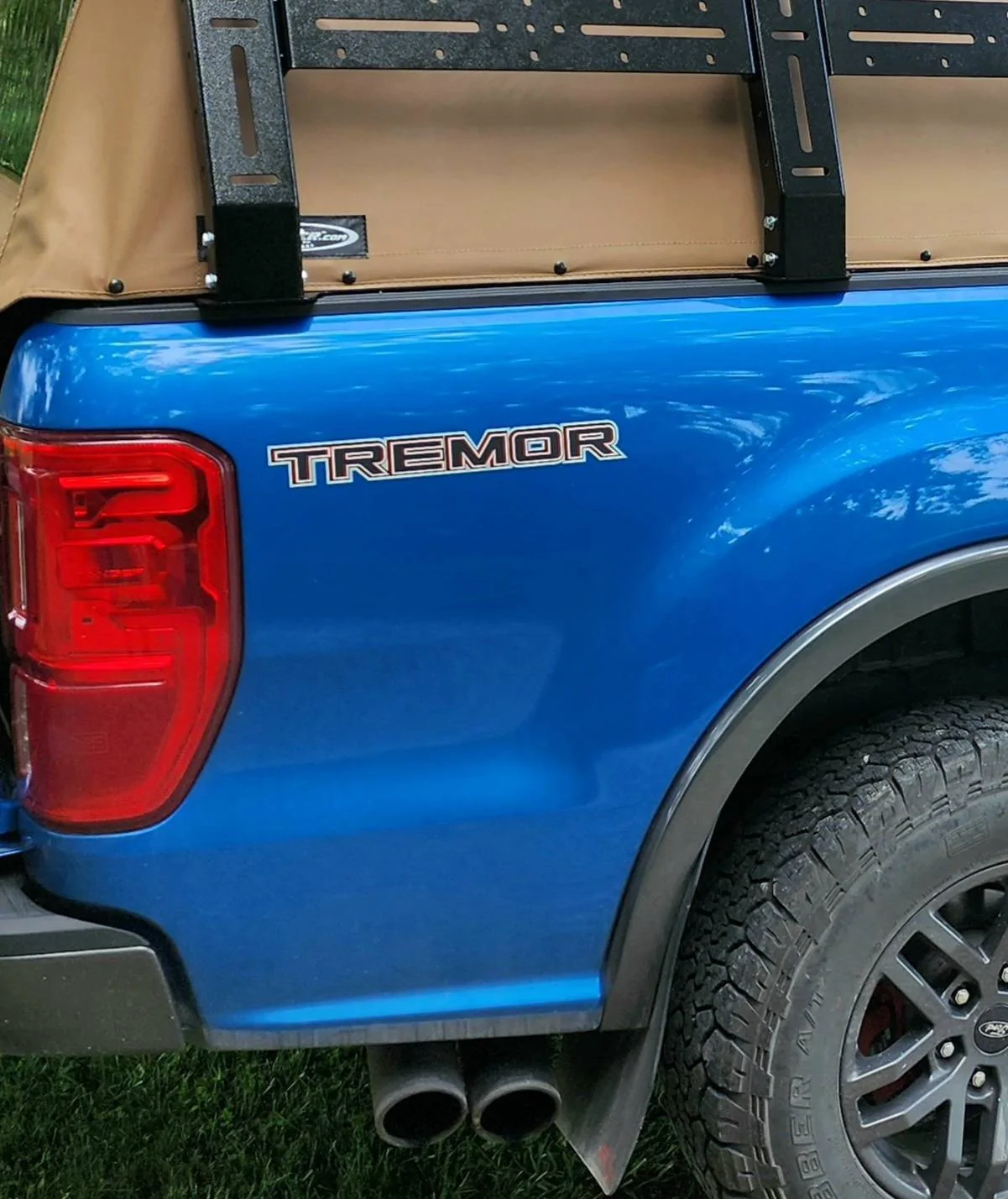

I search the forum for "spintech" and this was the only hit, so I'll post here. I thought I would try some different for the exhaust than all the cat back options I've been seeing and hearing, so I had a Spin Tech Pro Street 6000 put on my '21 Tremor today. It's about half the size of the OEM muffler in each dimension, so some pipe was added to make up for the difference and offset.
It sounds very good, not loud, nice low tone and gurgle at start up and idle but smooth as OEM on the throttle. There's no drone or loudness in the cab, just a little louder than stock outside the cab, without sounding like an economy car or swarm of bees. Pop's Exhaust did a fantastic job with the custom fab work... experienced craftsman.
