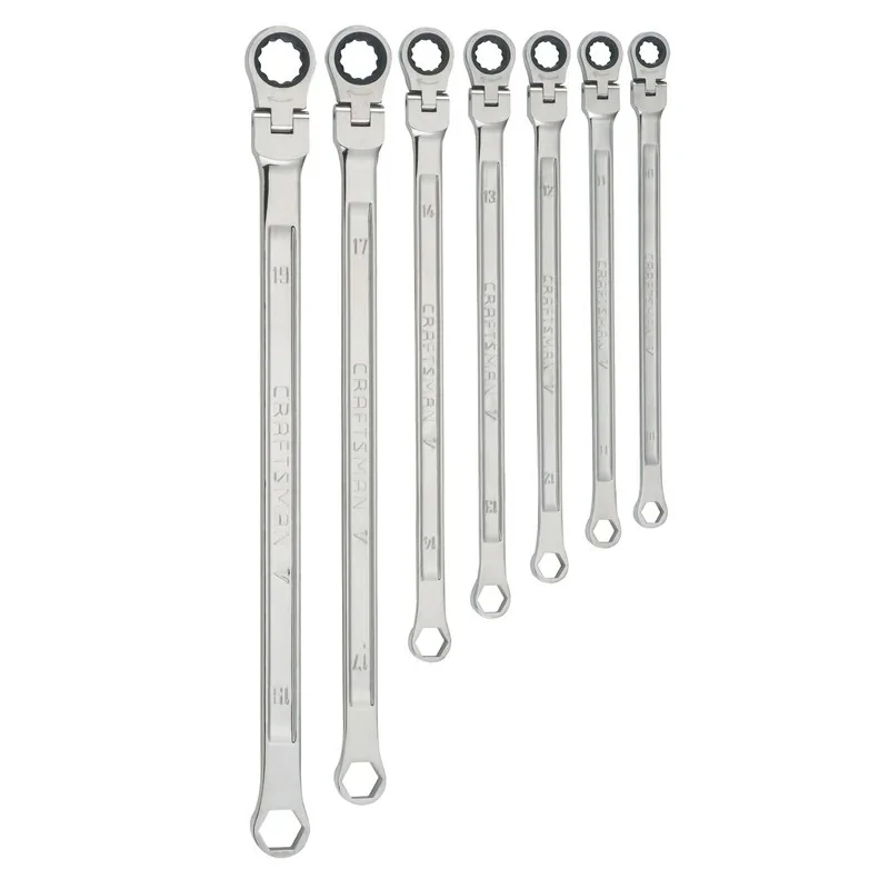

But, I thought why temp fate, so I just ordered some stuff:
Fitz stick, <$200
19MM flex-ratchet wrench and wide mouth crescent. $50
Oil pump to drain oil, $20 from the amazonians.
7 quarts of Mercon ULV, $50
15oz Lubguard Platinum, $15
From what I've read, it's $350 well spent to stave off the demons.

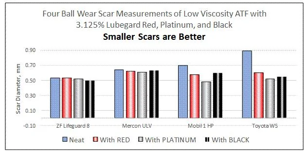

I still think it is a very worthwhile exercise to change fluid early and often, and use the LG as an additive. According to LG's testing (Take that for what its worth) the Platinum enhances the wear protection of ULV slightly, so perhaps that will be enough to keep things sliding properly.
https://lubegard.com/viscosity-in-depth-review/
Yes, the article is about viscosity, but they also ran a wear test.

Ok, too lazy to do the math, what is 3.125% of the capacity of our rangers? How did they come up with that number? Don't get me wrong, I think the LG Platinum is a worthy product.
Lol, I think in the article they say 'recommended dose' which I guess is 3.125% or 1oz per qt.
32oz in a quart 1 oz, so I guess that works out to 3.125%. I'm really stupid when it comes to math, I didn't get that part of the Autism spectrum.....

Thanks for the list, I forgot about that stubby crescent and I guess a flex-head 19mm ratcheting box wrench wouldn't be so horrible to get (you know me and my hardened steel self-control). =D
hmm, maybe an entire long panel set?
