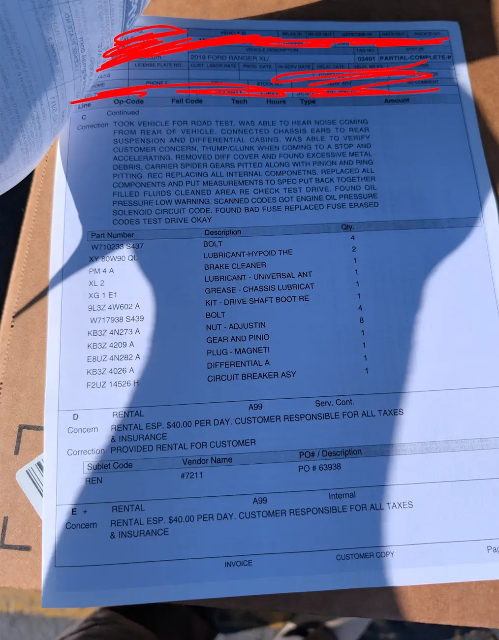

Got truck back here is what they did, hopefully I don't come back haha got a rebuilt transmission out of this so not too mad 😂
I would check your engine fan clutch wiring for damage. If the clutch hose breaks, the fuse that feeds the oil pump solenoid and other circuits, usually blows.

Welp that lasted about 3 hours just dropped it back off to the dealership
So rebuilding the rear end didn't fix the defective transmission 🤔.
