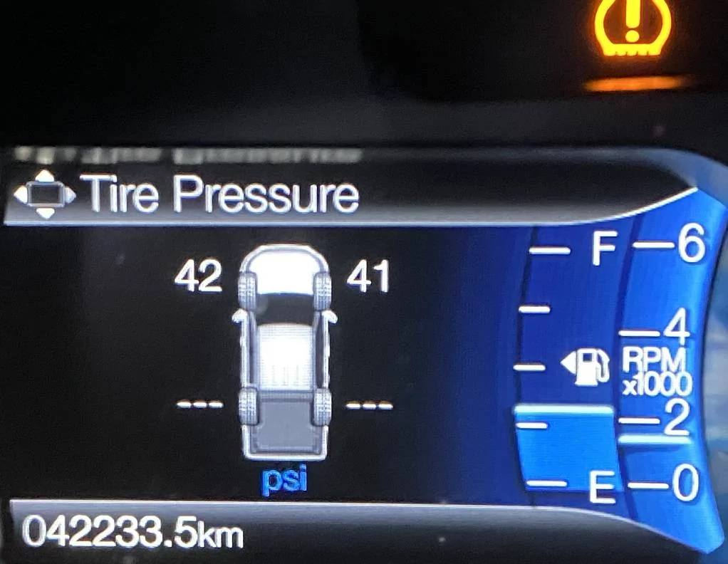

Yesterday, I did a rotation, and twenty miles into the first drive last night I get an error message, TPMS not working. The display shows 42 & 41 for the front tires, and hash marks for the rears. The rears which now show as not working, were rotated from the front so they were working the day before. The now fronts were both spares sitting in the garage, both were working in April when I took them off. These are all Ford OEM TPMS.
Today I got in the truck, error message is gone. WooHoo!!! Twenty miles into the drive, error message is back and again, it's not registering the rears, d'oh.
Ten years and at least 35 rotations, this is the first time it's ever happened to me. I'm going to do the reset tomorrow, nut I'm not happy about it ;)

I tried the manual reset a few times, but I kept getting the double honk on the first tire. I swapped out the only tire that had individual service since the TPMS were installed and the system came back to working properly.
I dropped it off at Blue Start Ford for a TPMS check/service and they replaced the sensor under warranty. It's back on the truck now and working perfectly again. Woo Hoo!
