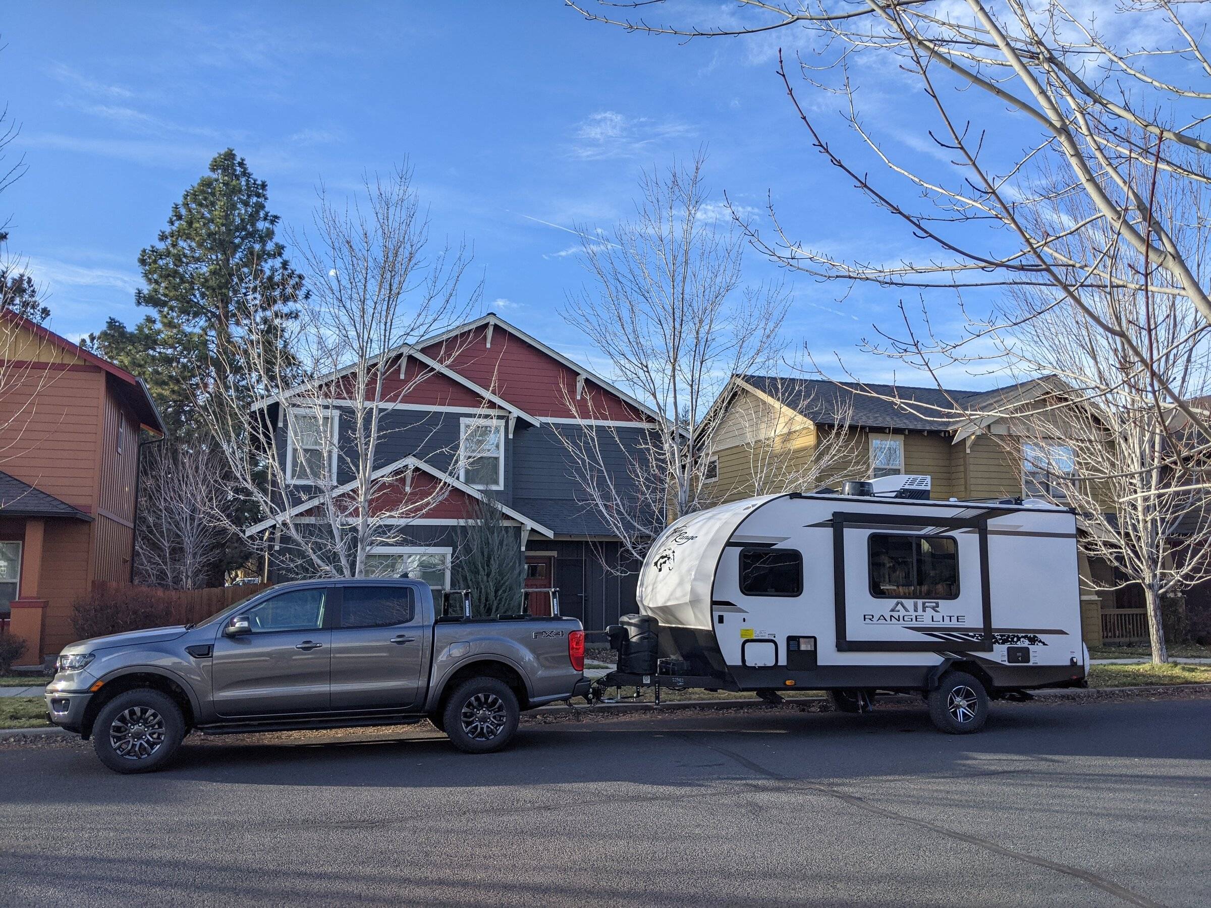

Congrats on the trailer. We looked at the Micro Minnies also. Nice trailers. We ended up with another option that is 5k lbs GVWR.
Our dealer likely did the opposite: Set the WDH too stiff with too much tension. They also set it too nose high, as the pic below shows.
My Ranger towed great (no sway or wagging end or loose steering). However, the WDH bars were nearly impossible to get off, even with the trailer front jack extended to reduce tension. We also had some noise around sharp turns, like the bars were again too tight. Along with the truck and trailer combo just feeling very stiff. I readjusted the WDH (E2 6,000lbs) but will need to test tow a little next month to perhaps dial it in more.
Also note that our Ranger does not squat much in the rear either. Maybe 1" or so when hitched.
I also have Fox 2.0s in the rear. That probably helps.

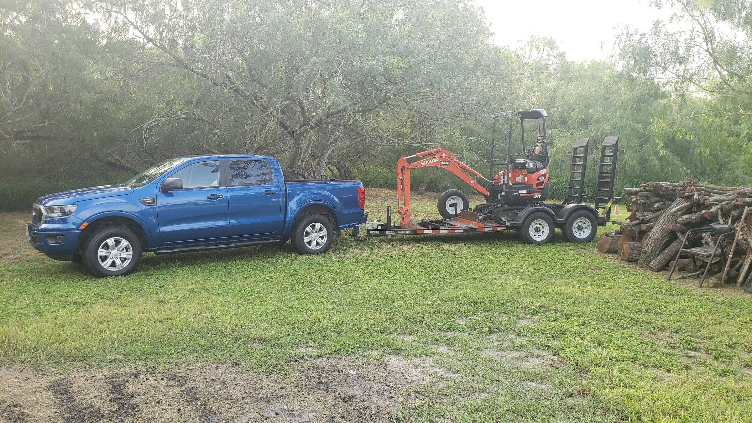

Yes the ranger tows really well! This is 6500 to 7000 lb tow. The trailer is uneven, have since gotten my self a
Gen y rebel adjustable hitch
For the various trailers i end up towing. Last tow was 5 to 6k and this weekends tow will only be 2500 at most.
