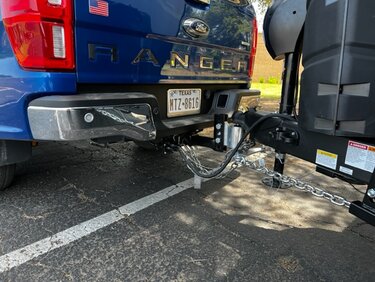

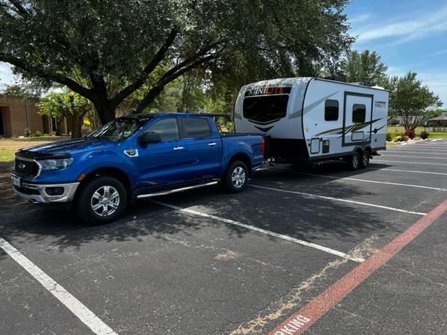

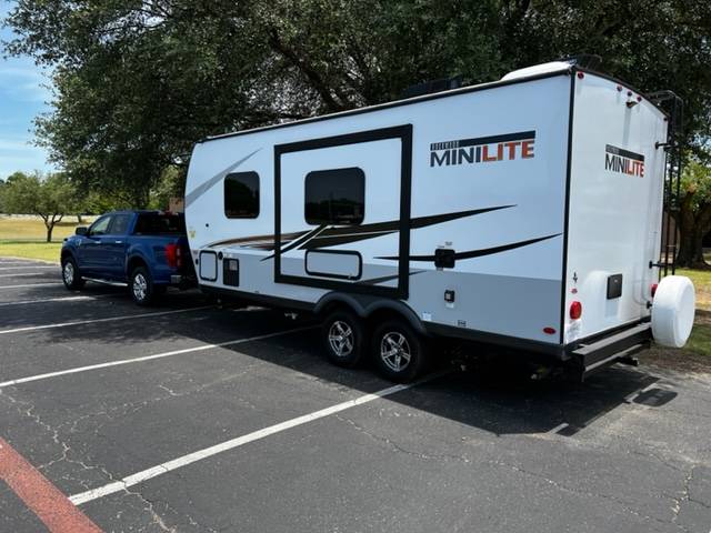

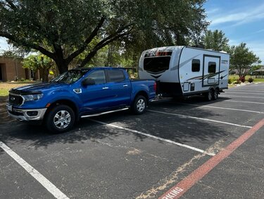

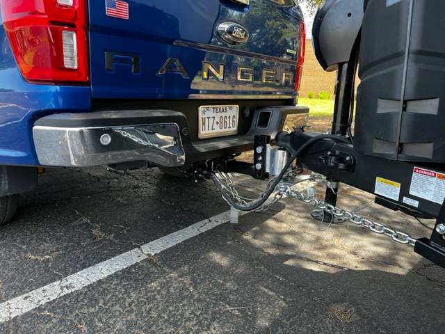

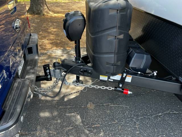

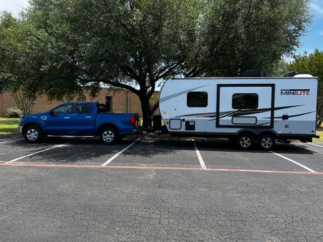

Wanted to post some pics of the Ranger now ready for towing. Thanks to all for the good advice. Decided to go with the Redarc brake control, Andersen WD hitch, Draw Tite max frame hitch/receiver and T-one wiring harness. Haven’t done a bunch of miles yet but so far seems to tow as it should.

What are the recommendations for using the electronic sway control on the truck with a anti sway WD hitch? Do they work together or do you only use one?
Looks good! If I was buying a hitch myself, I would go with the Andersen also. I got my Fastway E2 as part of the sales negotiation, so I will use it, but feel the Andersen is one of the best. The issue I have with the E2 (and other similar hitches that use spacer washers) is what to do when you are between washers? I compromise and use the lower number (6), but it does also micro sway more than I like in wind, vs using the higher number of washers (7), which is too firm and also too tough to get the spring bars on...
