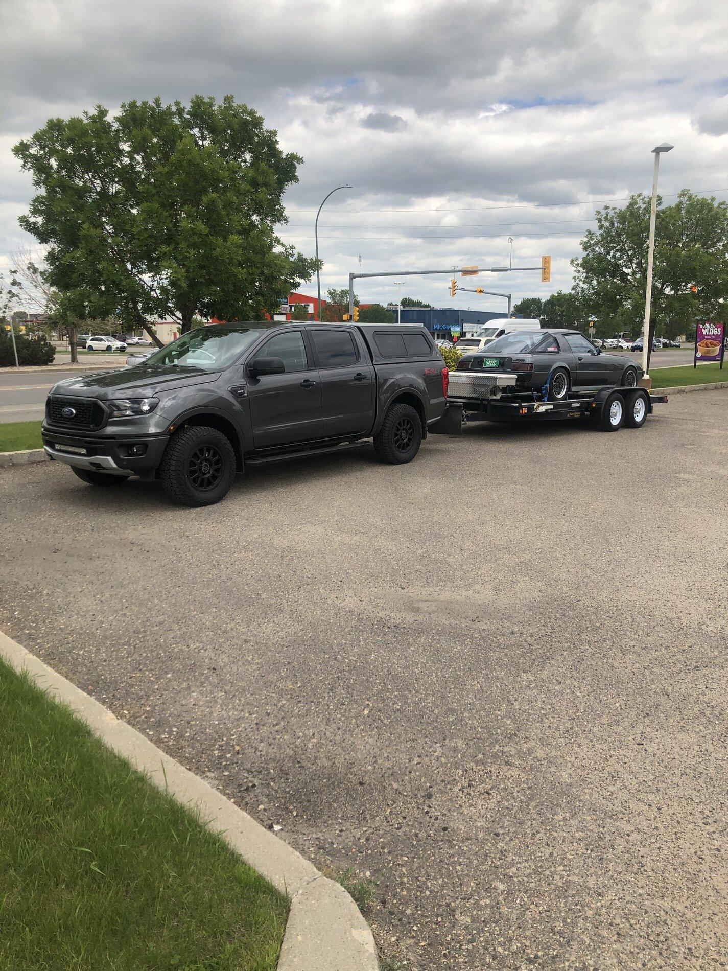

A weight distribution hitch goes a long way. Lock out 8/9/10 gears, it will use substantially less boost on the highway, and improve milage/reduce lugging the engine. In reality, you’re not even taxing the truck with an open flat deck trailer, towing a car like that.

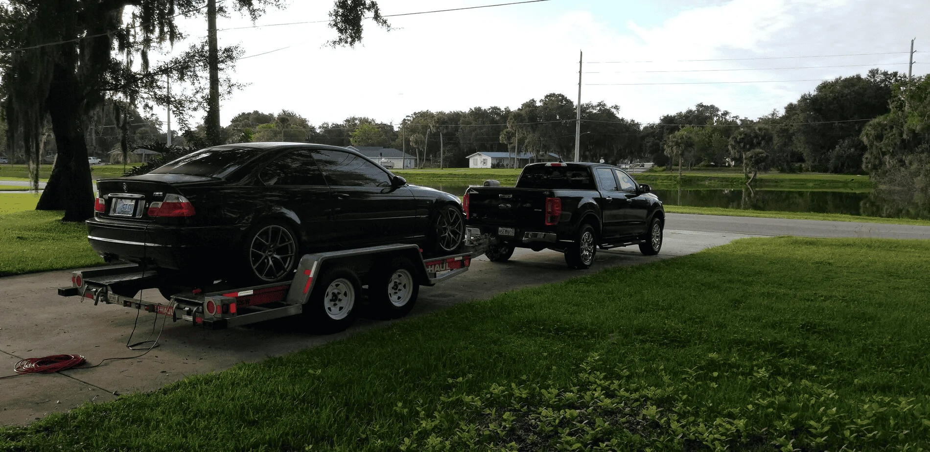

Won't be an issue at all. Towed my M3 to Sebring just recently. Truck was loaded with the whole family and bed full of track day tools and such. Enjoy the trip; The Ranger will do the rest. Just plan for more gas stops.

I regularly haul my racecar 8+hrs one way to the racetrack. I’ve always noticed the best fuel economy in 7th gear, at 110kph
