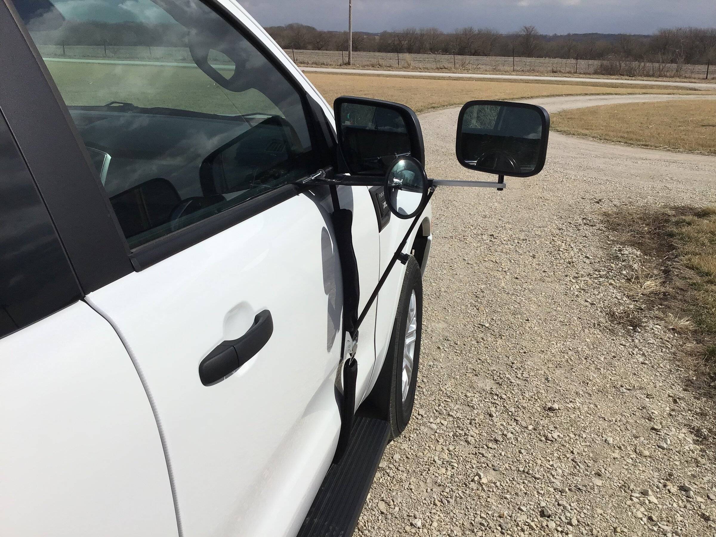

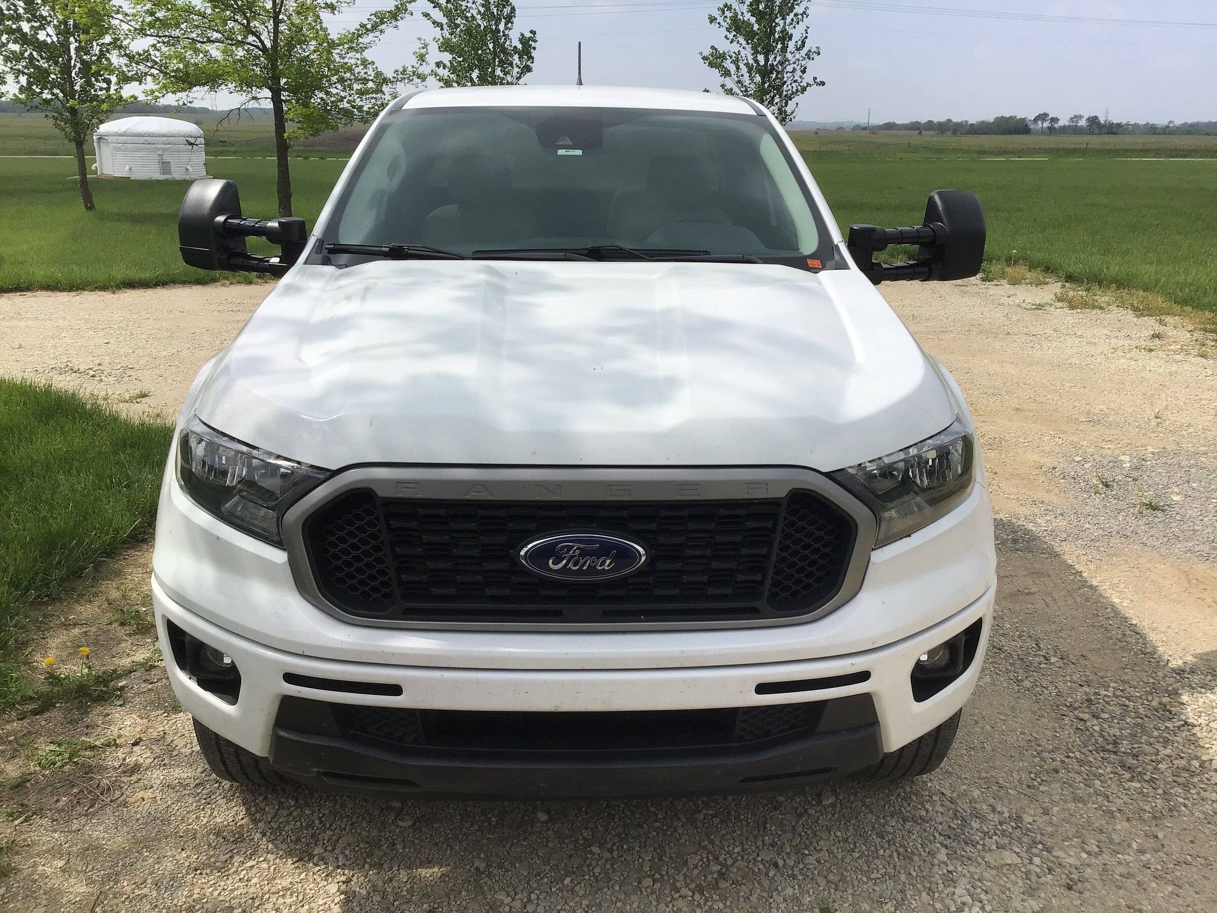

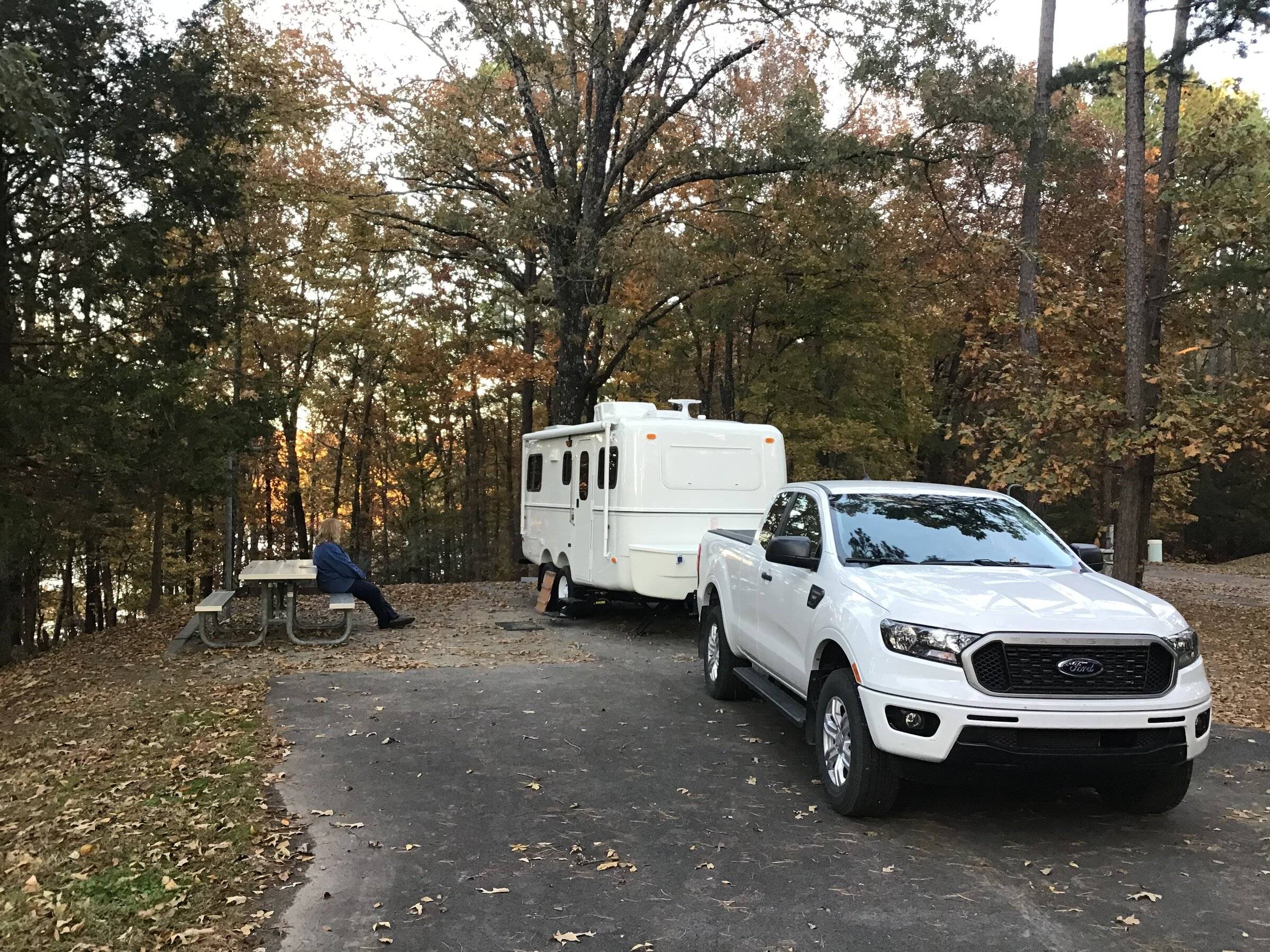

I have an Escape 19. 4650lbs loaded and ready to go with 560lbs tongue weight. It’s probably the heaviest Escape 19. I put Bilstien 4600 shocks on the back only because I did not like the ride of the stock shocks. I have a 2021 2WD XLT scab. I have the Ford variant of the Redarc brake controller. My trailer is only 7’ wide, so may have less windage than yours. Ford rates towing with the Ranger at 55 sq ft frontal area.
I have not yet been in the western mountains, but have towed 1000’s of miles up and down the eastern mountains. The truck is unfazed and always has more to give if I need it. I get around 15.5 mpg towing. I have a little over 11,000 miles on the truck, about 8000 of those towing some kind of trailer - mostly the Escape. Tranny temps are usually in the 190’s, but do creep up to 206 with a lot of downhill and twice briefly made 208. My lowest towing mpg has been 13 and my best 16.

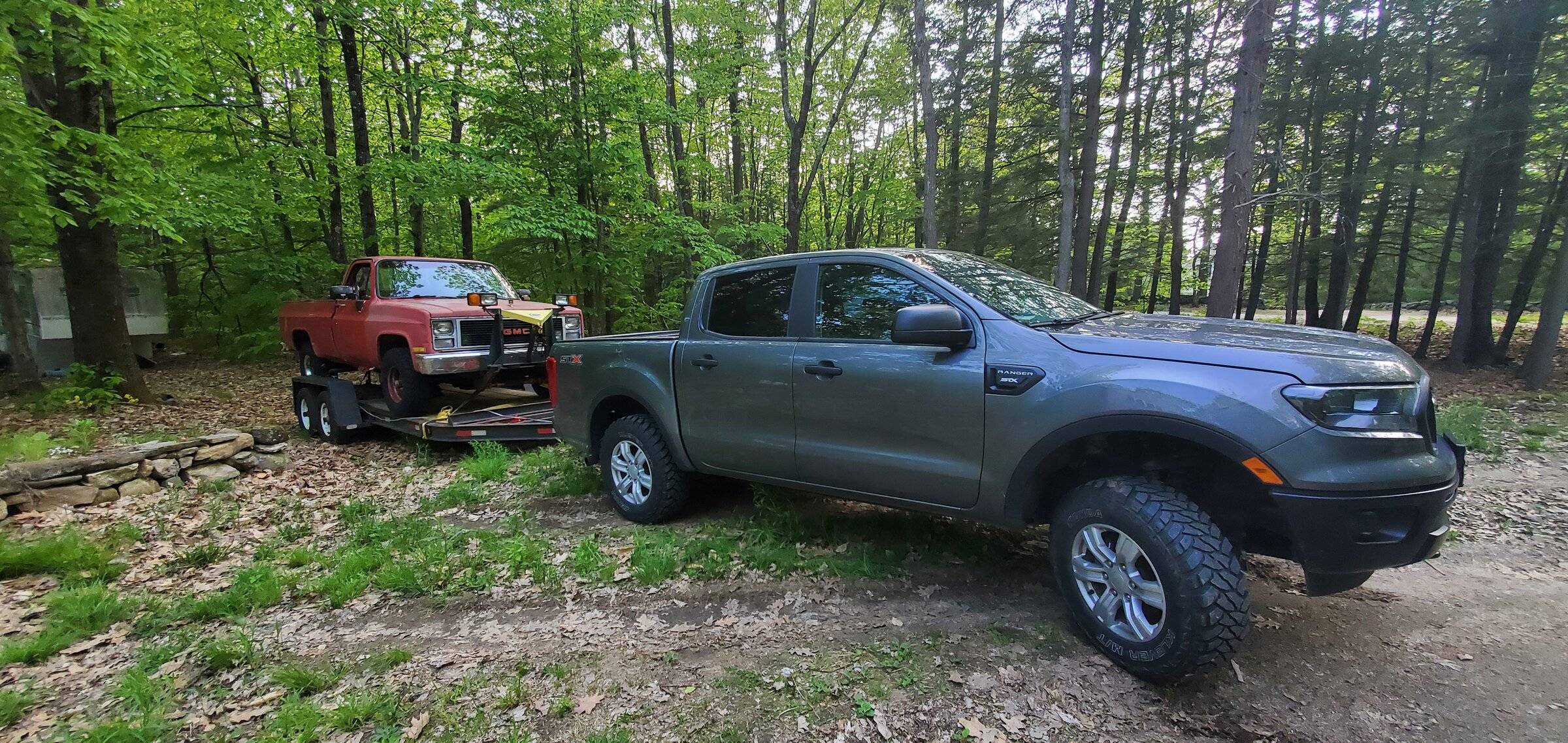

The heaviest I have towed with the Ranger was a 5000lbs dump trailer with 630lbs of tongue weight. It’s 8 1/2‘ wide, but not real tall. It was local towing, and it was no problem for the truck.
I started with door strap on mirrors that are much more solid than the mirror clip on style. I used neoprene seat belt covers to protect the finish. I recently added the new Clearview mirrors. I personally think towing mirrors are an essential safety item for the 1000’s of miles I tow.

I also have recently upgraded my rear shocks only to bilsteins. Didn’t like the pogo stick effect the stock units delivered. The mirrors look good! Thanks for sharing your experience.

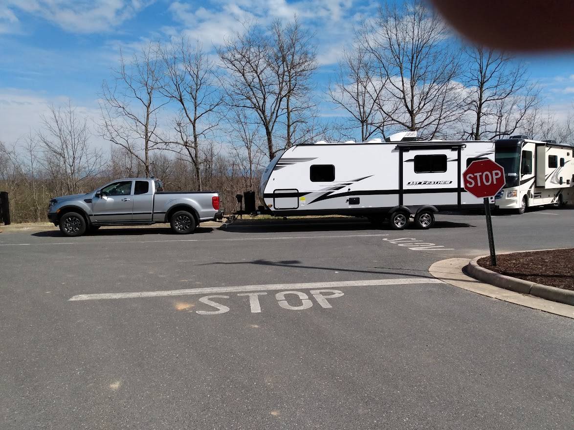

I'm going to throw my two cents in as I tow a trailer that's around 6800 lbs with almost 700 lbs tongue weight.
The Ranger has plenty of power, even thru mountains/grades, with an excess for passing. The 10 speed when in tow/haul mode works as designed......use it.
After towing with mine, in addition to a good (don't skimp out on a cheapie) weight distributing hitch set up and a brake controller, I would recommend the following 3 items, if/when you can afford them...
!. Set of Clearview Mirrors. Without a doubt the best addition you can get for towing an 8 foot wide travel trailer.
2. Roadmaster Active Suspension Kit. Takes the place of a sway bar, an air bag set up, add a leaf spring, and a traction bar. It is a bolt on kit, about an hour and a half to install, and along with a set of better rear shocks will handle just about any weight and road condition you come across. Gets rid of the "sloppy, squirrely" feeling you may have when towing. These kits run around $450 which may seem a lot, but a rear sway bar runs around $650, an air bag set up can run up to $500, and the kit does what both of them do.
3. A set of good rear shocks...I went with the Eibach Pro Truck, but there are others just as good. I went with just the rears and the set up rides great.
