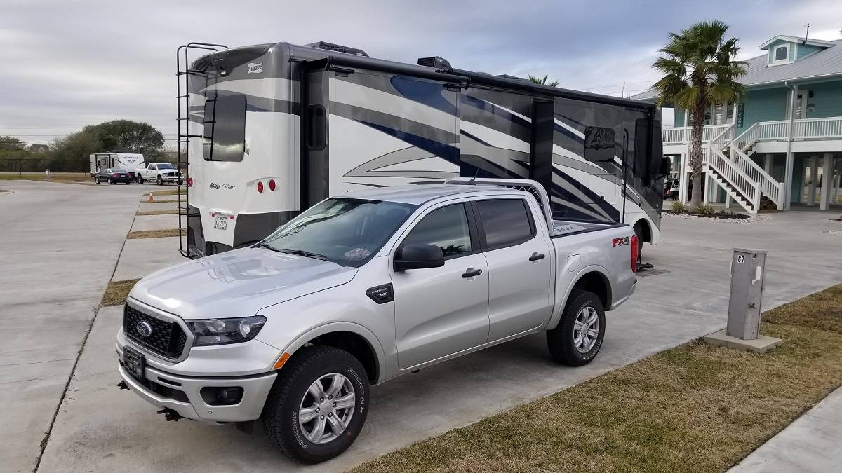

Yesterday in Childress, TX. We stopped for burgers. And, a better shot taken on the Texas coast to show how well the Ranger's Ingot paint matches up with the Bay Star's color scheme.
That was our deciding factor. I loved so many colors and couldn't decide on which one. We went with what matched the MH best!

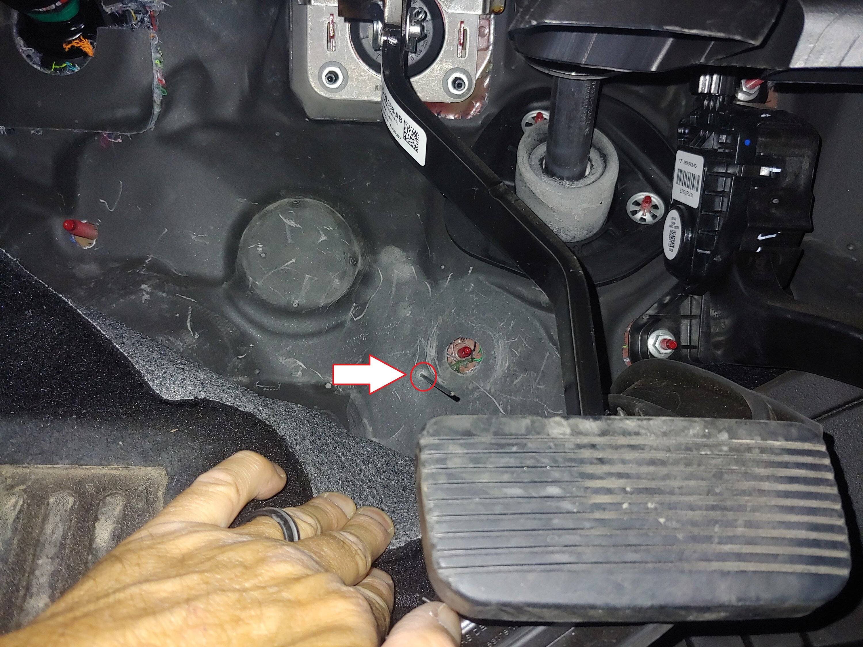

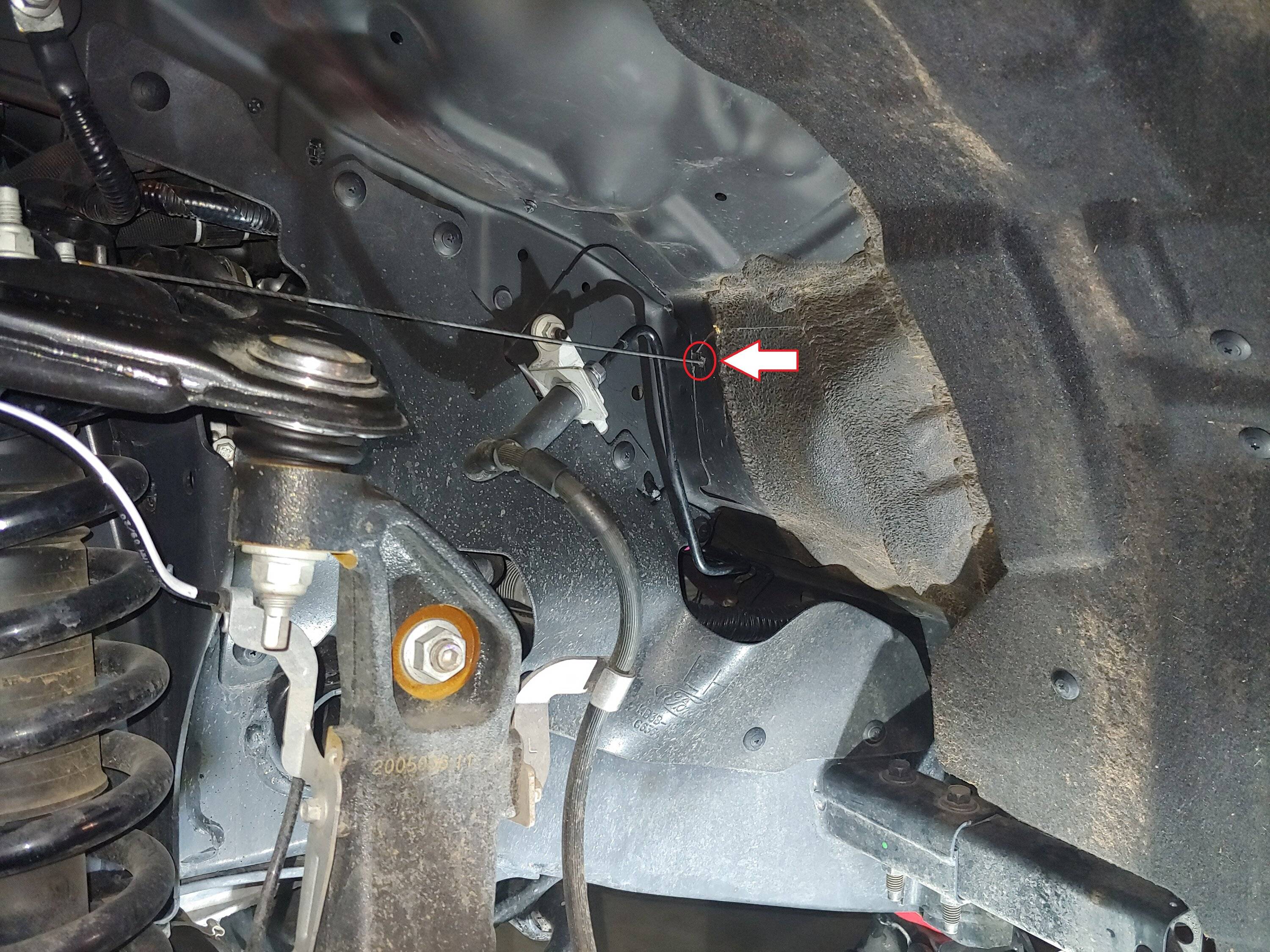

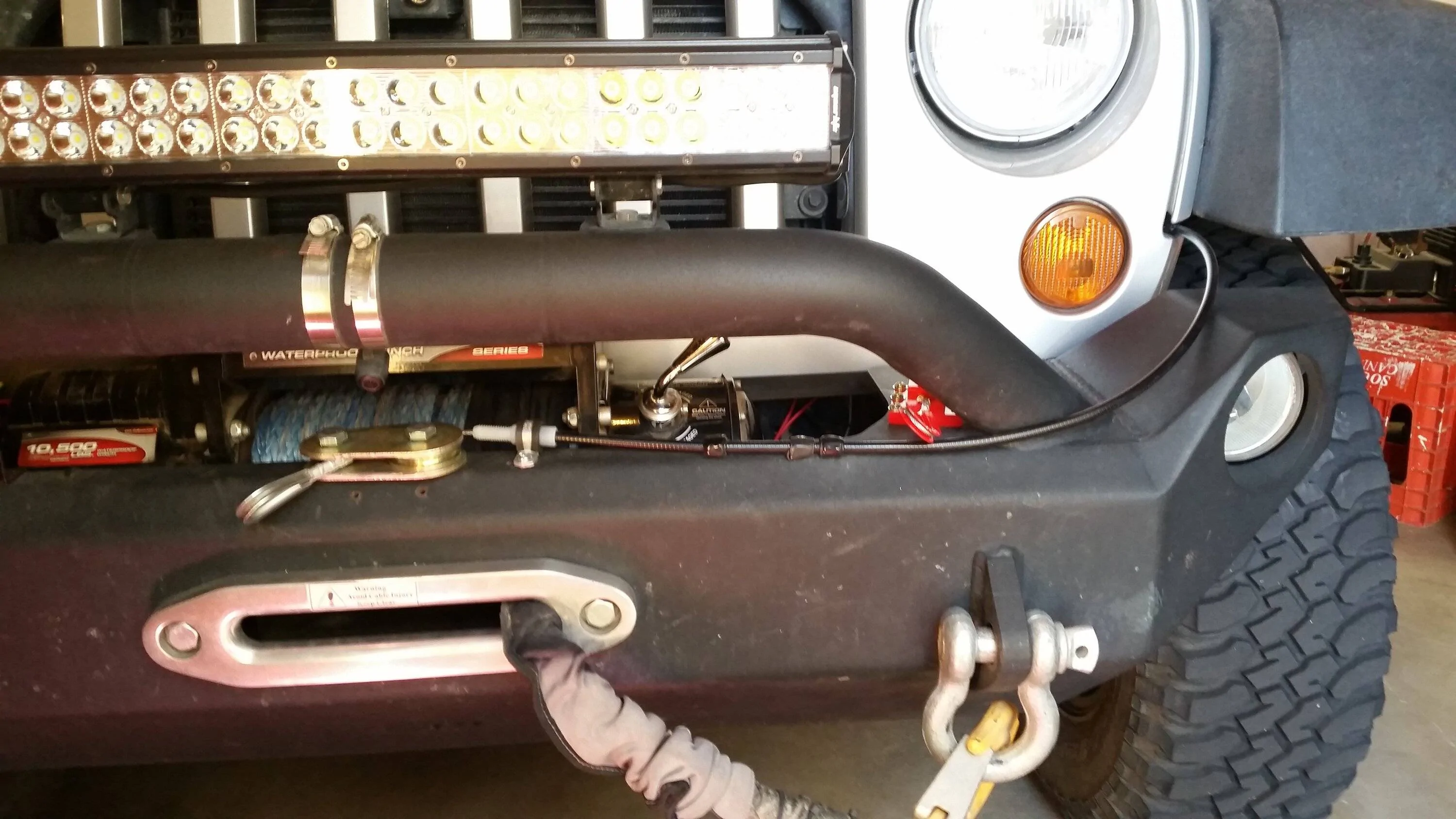

I'm installing a NSA Ready Brake Elite tow bar and surge brake on my 2020 Ford Ranger XLT 4x4 and I thought I would share a couple of photos on were I'm drilling the holes through the fire wall. I had the system on my Jeep for 8 years and love how simple it is. I have items on order that I didn't remove from the jeep or are unique to the Ranger so I cant start the install for a couple of weeks yet but I did drill a test hole to verify the install location. The first photo is with the drivers side wheel removed. I drilled a small test hole and pushed a wire rod in the hole to see where it would come out.
Here's where it came out. Looks like a good spot.
There isn't much room inside the engine compartment so this is a very easy way to get the cable through the fire wall.
I haven't decided how to attach the cable at the front of the truck yet. Not a lot to attach too. This is how I did it on the Jeep. I used a ATV style snatch block to run a 90 deg turn on the cable wire. Worked great.
I'll post more when I start the install an a couple weeks.
