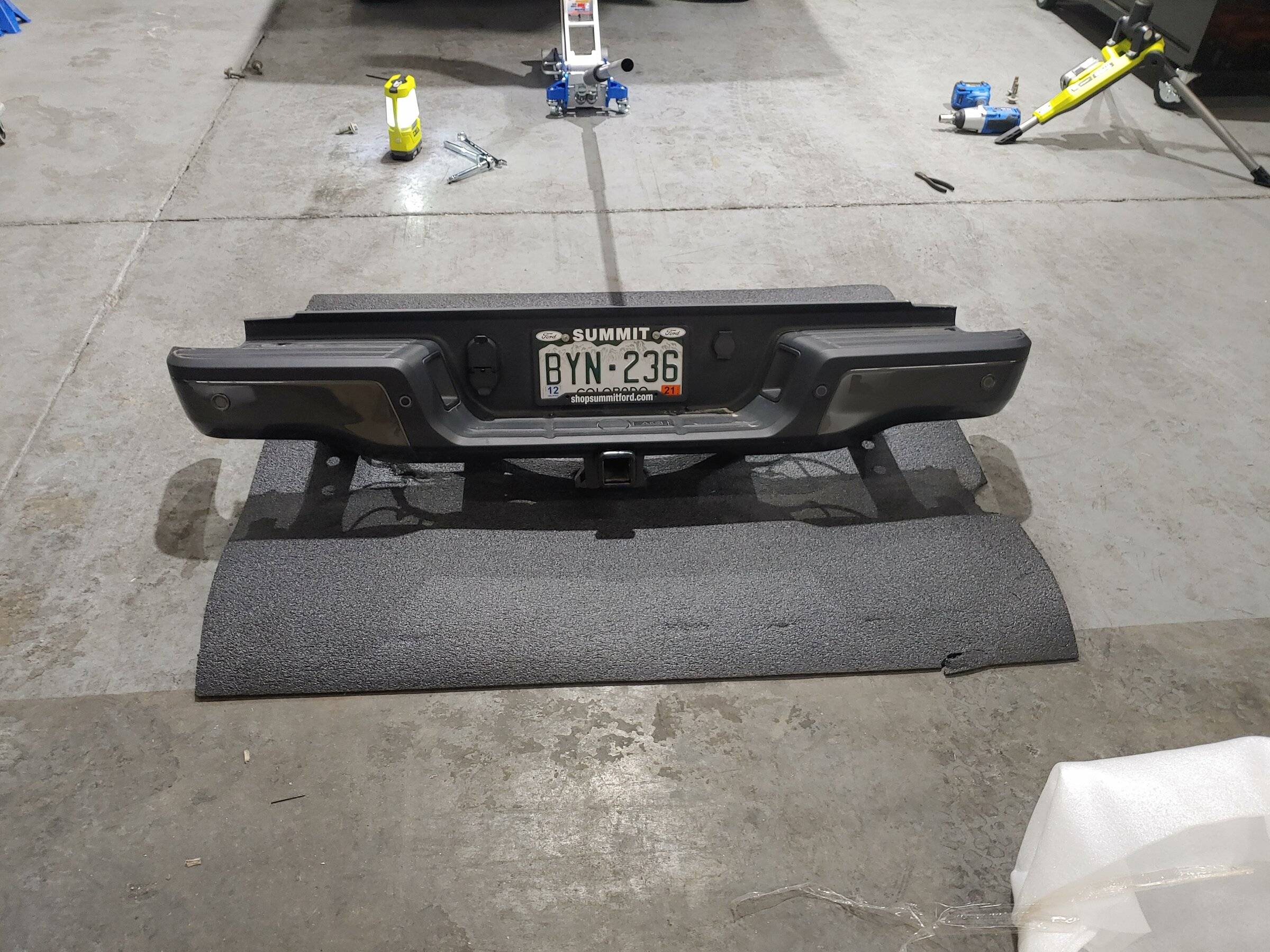

With the actual tow package the hitch isnt as removable as you think. I found out last year when I attempted to install a PX series rear bumper on my truck.
Just 6 bolts and a connector and the entire rear bumper and hitch come down. Should I mention that the bumper uses the hitch to mount on the truck? If you dont have the tow package the bar is still there but without the class 3/4 square tube.
