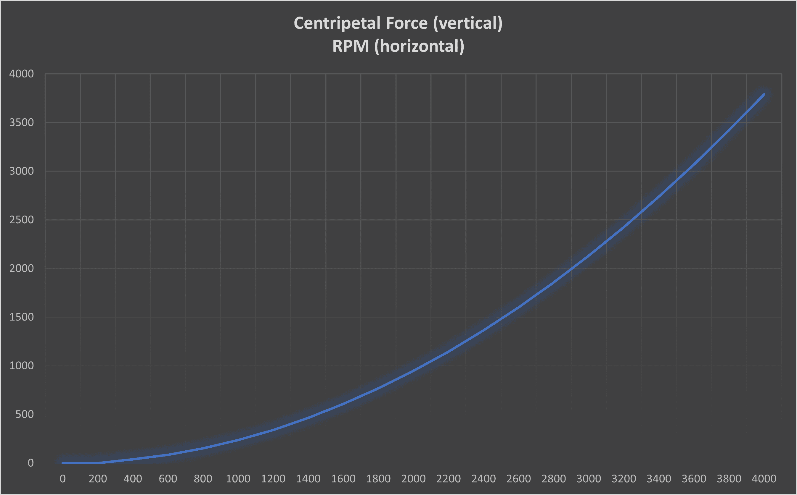

Yep, @TJC, you have paraphrased me well. I've put the tools out there for people to dig deeper into the "critical speed" thing, so that you don't have to take anyone's word for it, including my own. But while some evidence supports that theoretically go faster than 100 I'm not going to green light that one bit. I've maintained the position that if you want to drive faster than 100 you need to buy yourself a racecar, not a pickup truck, and then go to a track where it is safe and legal. The thing with speed and speed related problems is that it isn't like there's a magic number where everything under that speed is safe and fine while crossing that threshold ensures disaster. Rather, the faster you go the more potential there is for problems. It's almost an exponential curve. I don't know if I shared it yet but I created a graph of centrifugal force of mass and how it increases as speed increases. I used something like 1 ounce of weight at 3" swing diameter, but the exact data doesn't matter so much as the concept matters. centrifugal force, and therefor vibrations increase on a non-linear curve as speed increases. Another way framing this would be to say that speed related problems, or the likelihood thereof, increases on a near exponential curve. I want nothing to do with the problems potentially associated with spinning a steel drive shaft in a pickup truck as fasts as it spins at 100+ mph. That's the bottom line for me for critical speed and where I've set the limits. That there's a point at which I say "No thanks, I'm out". Here's the graph I referenced above. Which reminds me of a funny and very relevant video that I saw on youtube. It has bad words so I won't post it here but search "find out graph" on Youtube if you're inclined.
