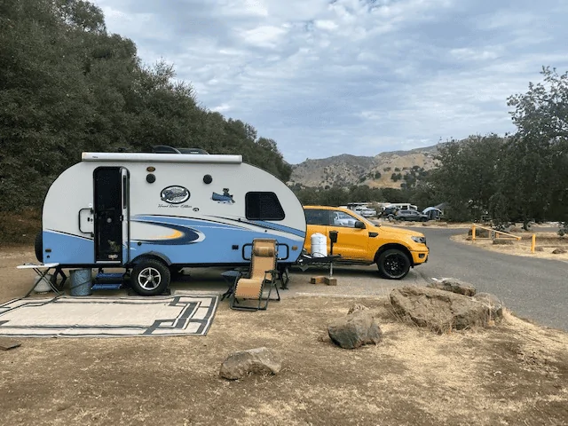

XLT FX4 towing an approx 4,200 single axle.
Bilsteins in rear, Reese friction sway bar, eliminated almost all sway.
Stock Hankooks.
