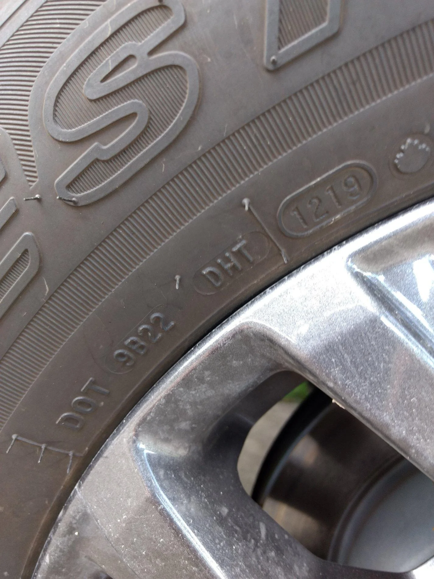

15m39 is the tire plant code. The date code follows that in a raised area of the tire. Pic for reference...

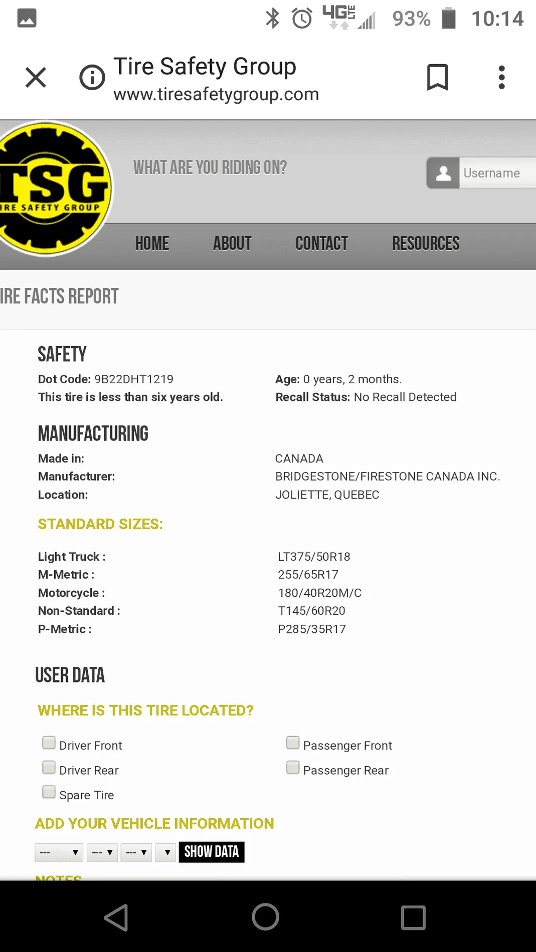

Using my own code, here is what I've found...

thanks for the tire safety group tip
brain fart . after I posted I went out to the truck this time with a flash light and found the tire code RFH3418 . not sure what the RFH means but the tires are week 34 of 2018
