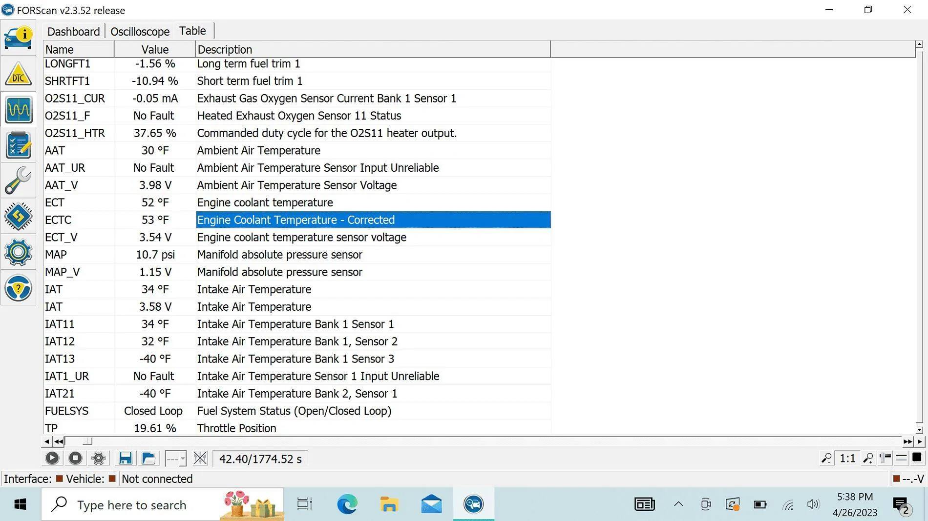

Ok, you have Forscan, I suggest you search youtube on using Forscan to set it up for Live Data monitoring. It's not hard but with Forscan you have to know general (PIDs) and what they are.
It is hard to explain and cumbersome to get set up vs a Scan Tool, that's why I do not use Forscan for any Live Data monitoring - with a scanner all you do is click Live Data and every parameter PID is available to view.
With Forscan you have to select every PID over to the (Viewing) side of the table and you have to know the simple acronym in Forscan to know what it is.

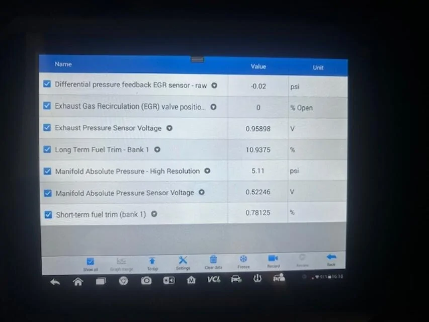

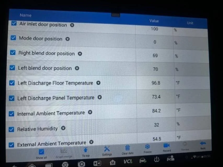

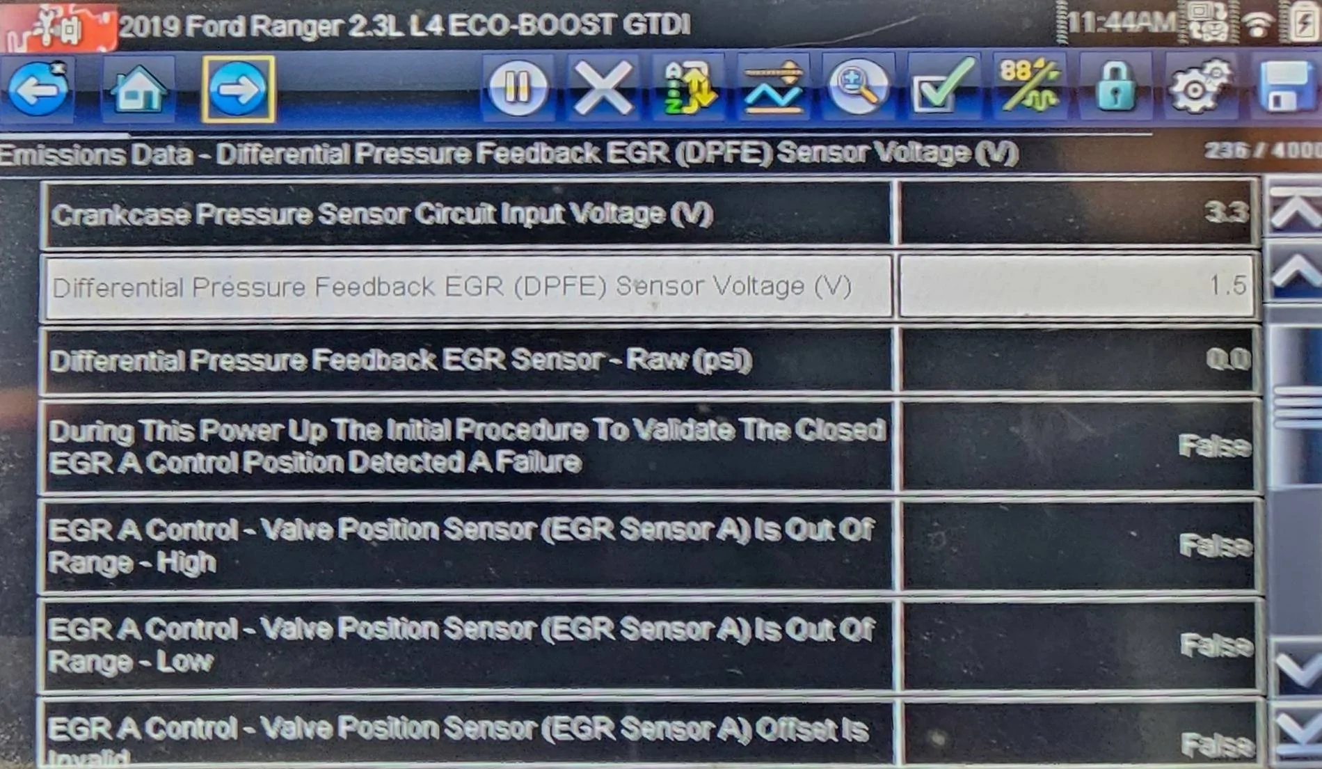

Here are some examples of Live Data - It is a Live view of the various engine parameters, valve position, pressures, voltages etc.
My Autel Scanner - For the DPFE

Snap -On -Scan Tool (I Think)
Forscan: Fuel Trims and Other PIDS
My Autel - Blend Door Actuators
