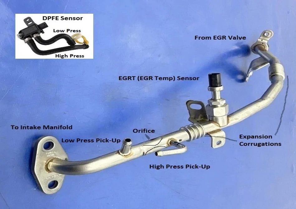

From the shop manual:
P139C - EGR Sensor C Downstream Hose Off Or Plugged
Description:
At idle, the exhaust gas recirculation (EGR) monitor commands the EGR valve closed and checks the differential pressure across the EGR tube orifice which should be zero to indicate the hoses are connected and not restricted. This DTC sets when the differential pressure indicated by the sensor exceeds a maximum threshold or falls below a minimum threshold. Possible Causes:
  • The downstream hose is disconnected
  • The downstream hose is restricted
  • Restricted or damaged EGR tube
Diagnostic Aids: Look for signs of water or icing in the hose. Verify the hose connection and routing. Check the differential pressure feedback EGR sensor for correct mounting and function.
Check for the proper connection of the hoses to the EGR DPFE sensor. It could be a bad EGR DFPE sensor. It is about $20 at RockAuto.
The Standard Motor Products is the OEM manufacturer.
https://www.rockauto.com/en/catalog...sion,egr+pressure+feedback+(dpfe)+sensor,5088
Here is a thread on the replacement procedure:
https://www.ranger5g.com/forum/thre...mbly-replacement-write-up-lb5z-9j433-b.29247/
