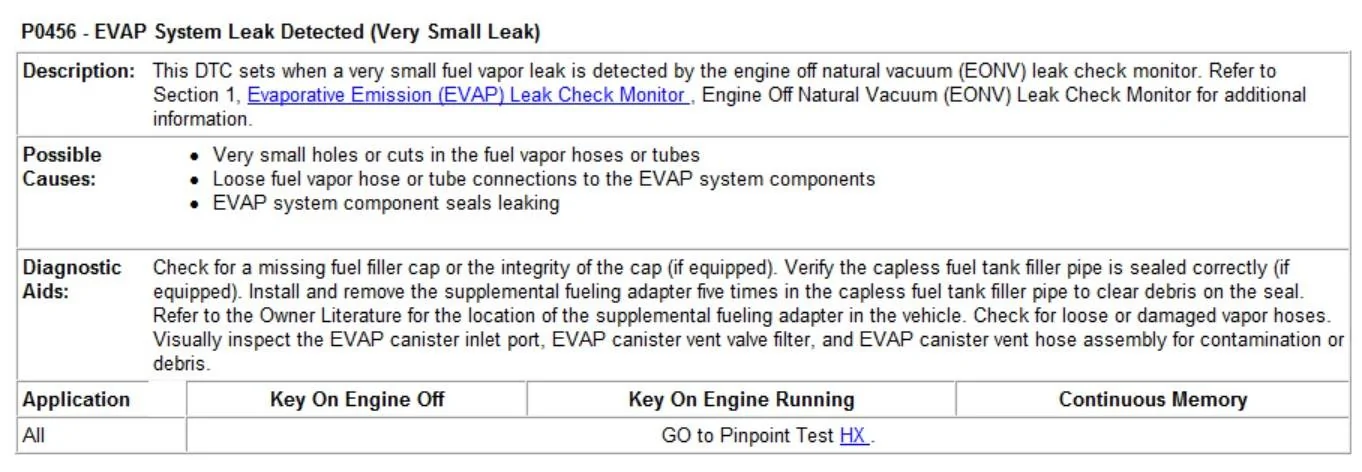

If smoke was detected at the cap during the leak test, I would think that that is the issue (leaking seal at the filler tube). Maybe spend more time cleaning the cap for dirt or debris.
Here is the trouble code description from the shop manual:

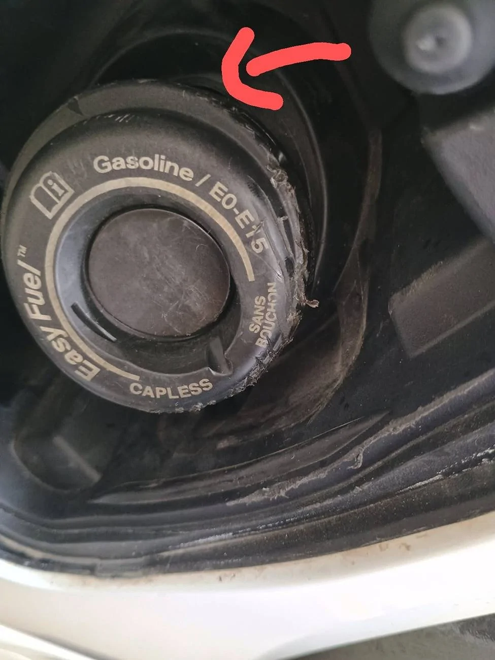

With the attached pic and various levels of leak codes, I suspect you are on the right track to replace the filler tube assembly.
And the area has been (attempted) to address a repair, those marks are someone's attempt with a pair of slip joint pliers to remove the cap end and repair.
I suspect the reason for varying levels of leak codes is due to every fill up changes the position of the valving (seal) in the fill tube and what ever position it rests at when the pump nozzle is removed.
Although not 100% positive that this is the only issue, logically its the most likely culprit.

With the evidence from the small amount of smoke and the scratches on the filler neck, replacing the filler neck would be the “best educated guess” in my opinion. I work at a small independent shop and with it being such an intermittent issue with nothing obviously “broken” it makes sense. But it is an expensive gamble. I always ask customers with EVAP codes if they shut their vehicle off when refueling. It sounds like common sense, but you’d be surprised how many times that turns out to be the issue. Just my two cents lol.

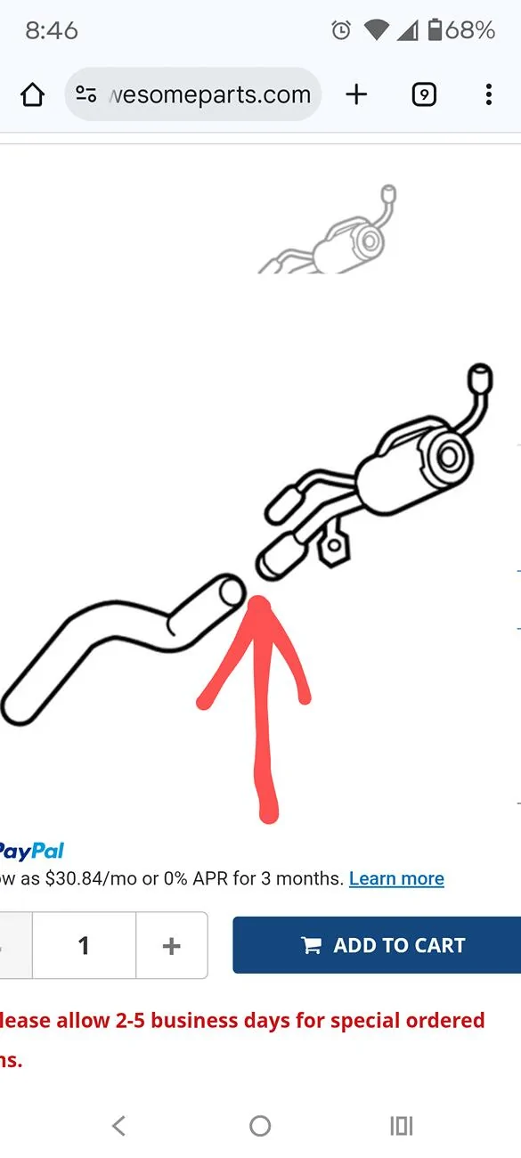

Thanks so much for the analysis! Makes sense, I couldn't figure out what was up with the scratches. With it being a Tremor with a nice ARB grill guard with lights, etc. I know it's definitely been off-roading a bit so didn't know if that could have something to do with the issue as well as far as maybe knocking something loose.
So would your best guess be that the leak is at this joint below in the photo?
There are two openings to the tank itself, the outside one in my previous photo and then an inner flap a few inches inside of there. I've worked that in er flap with the funnel and wd-40 in case it wasn't closing up normally. It seems to be although it's hard to see.

I would say the leak is where the smoke test showed leakage. Was the leak at that joint or at the end that shows damage?
[/QUOTE]
They said it was not at the gas flap itself but in the area right behind that, a small wisp of smoke. So would that mean it's probably coming up from that joint area and seeping out there or tough to say? I wondered if I could gorilla tape the area behind the flap there and call it a day but figured the "leak" may be from that joint area and it's just seeping out there but the system would still detect the internal leak if that makes sense.
