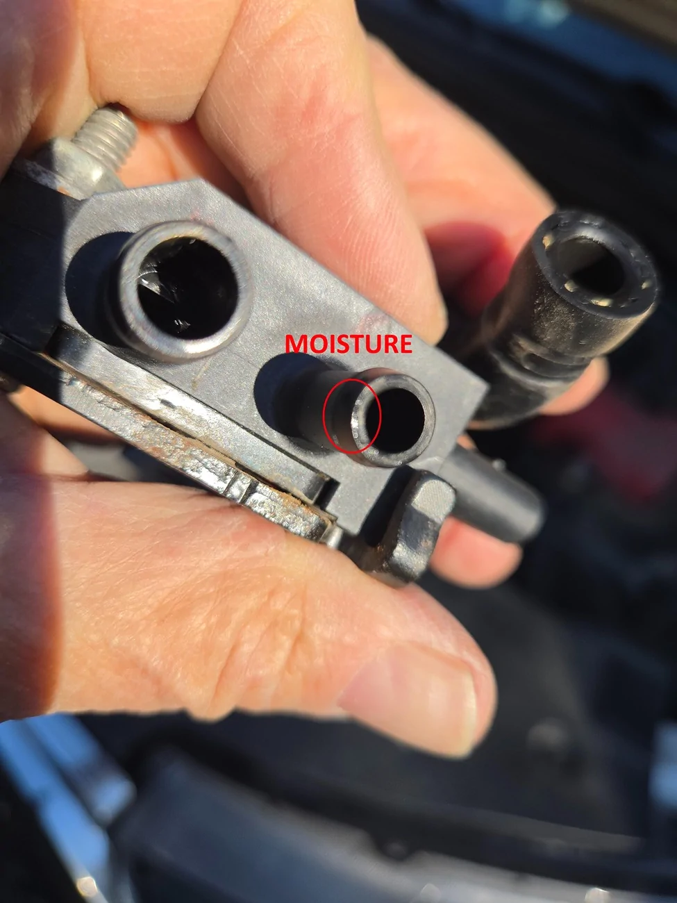

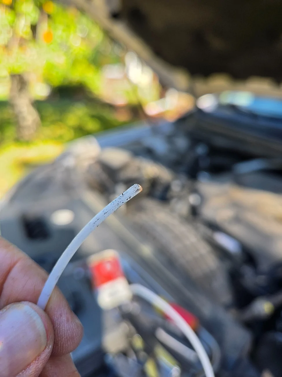

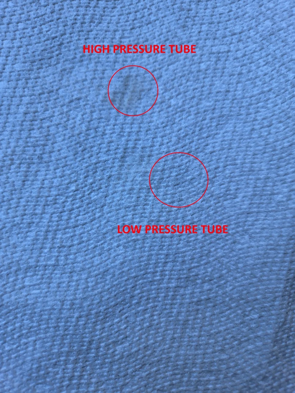

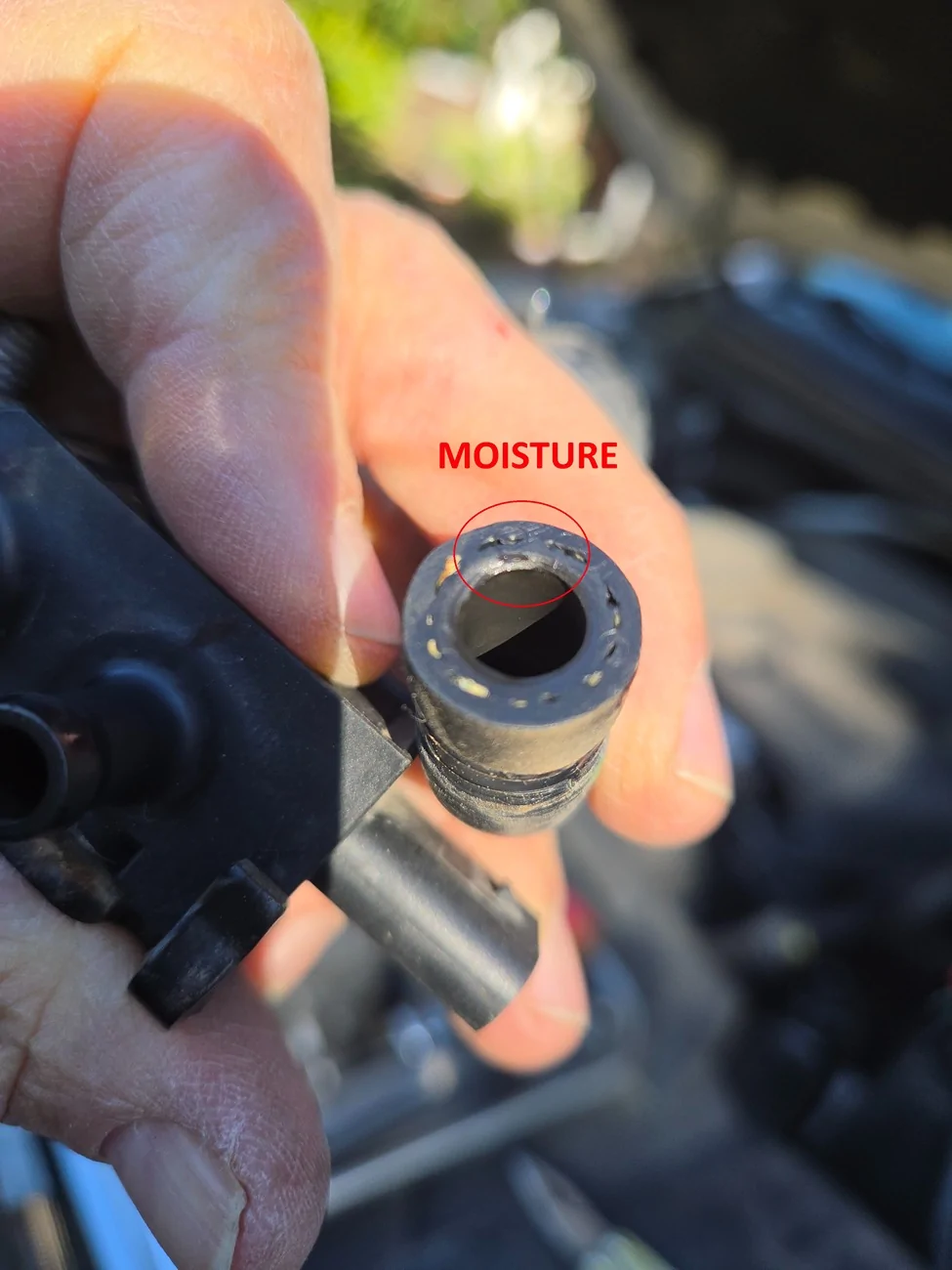

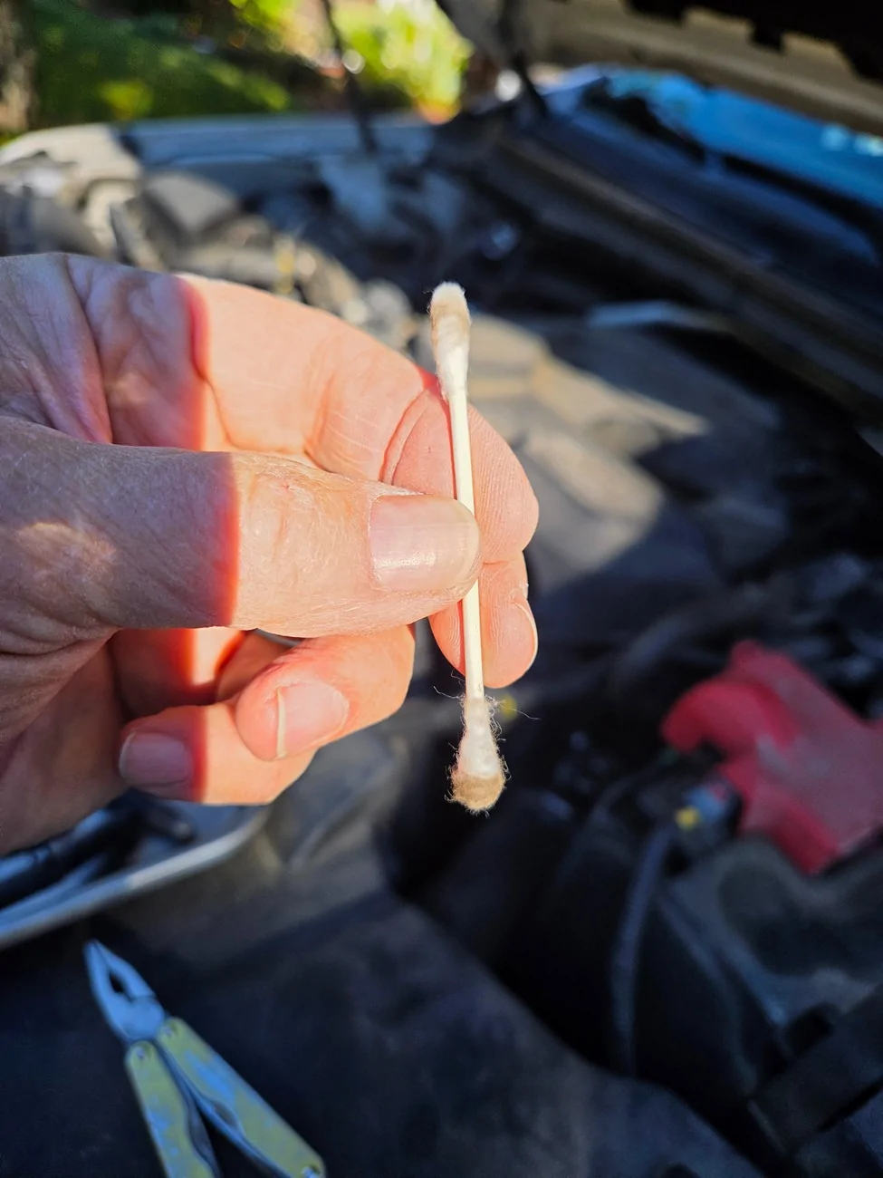

Finally had time to replace the sensor, and all seems good; no bucking and I believe values read normal (see below).
There was definitely some moisture in the high pressure tube and a bit in the low pressure tube. Prior to blowing the tubes out with air, I inserted a cotton swab and it came out damp, not dripping. I blew out the tubes onto a paper towel and, again, it was damp, not dripping. I then blew 30 pis air into the high pressure port. I also ran a short length of nylon trimmer string into both ports, and it came out with just a bit of black soot at the tip. Pics attached (sorry, pics are kind of lousy).

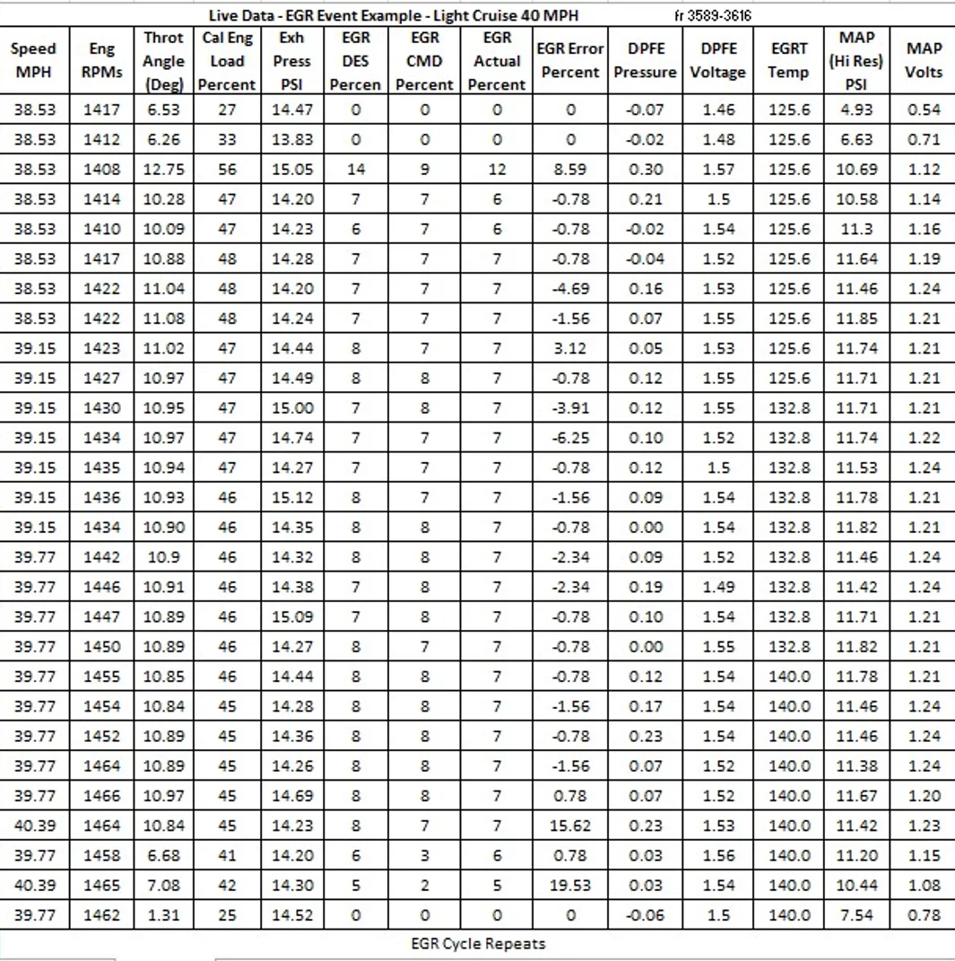

Readings look much better
Here is my (Live Data) Drive 40 MPH Chart - showing a single (EGR Event) Closed - Open - Closed
This test drive (speed) is the most noted speed for Buck - Surge and this chart is a good reference for T-Shooting of what is normal
Note - each EGR Cycle is not long (about 30 seconds) or so
This is interesting. I assume you grabbed this from FORScan. If so, can you explain how that is done?
My Snap -On scanner, live data recording of a drive set to record only the PIDs I have listed in the chart, I then created a spreadsheet of my frame by frame video to capture and notate the detailed cycle.
