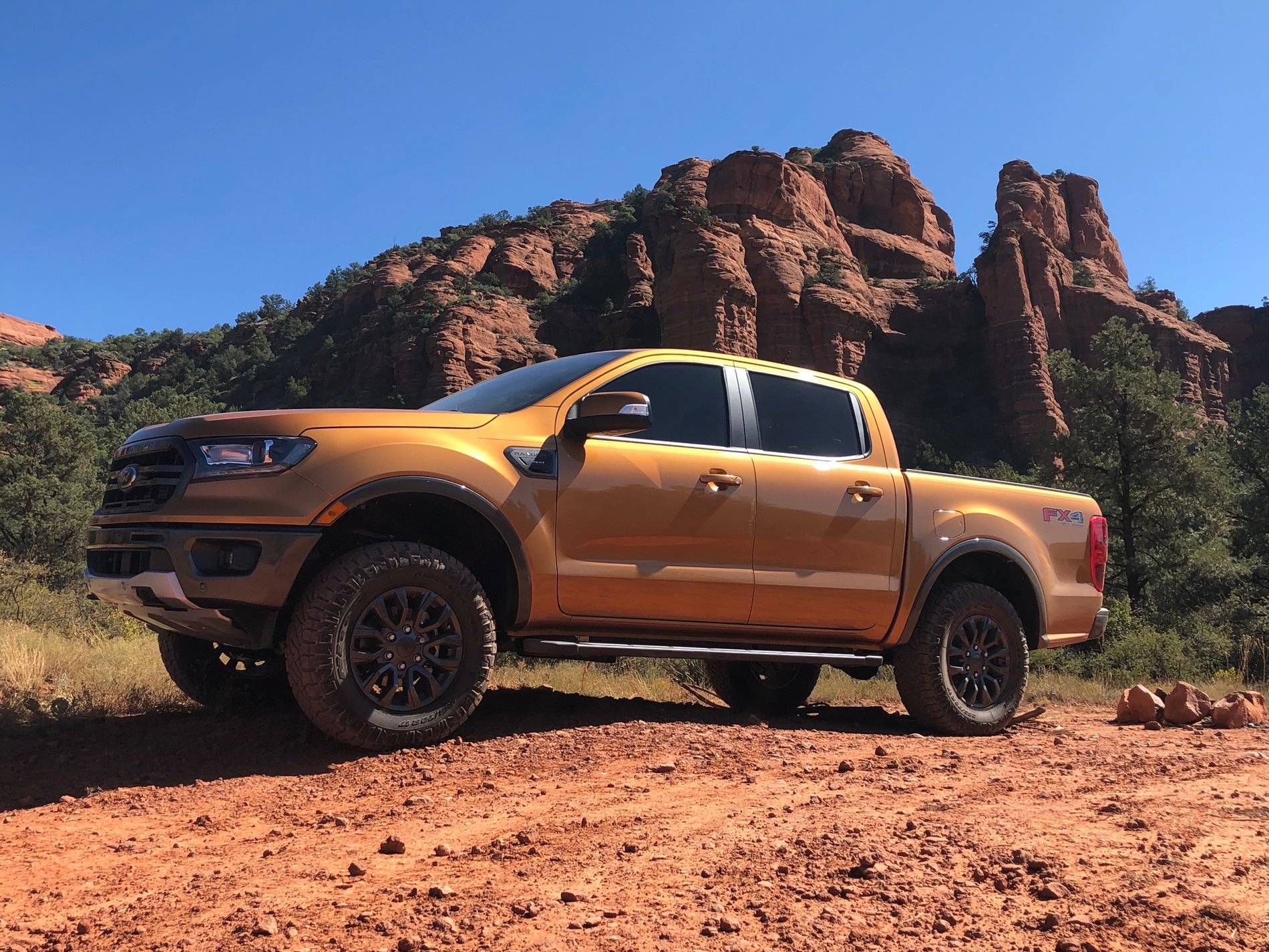

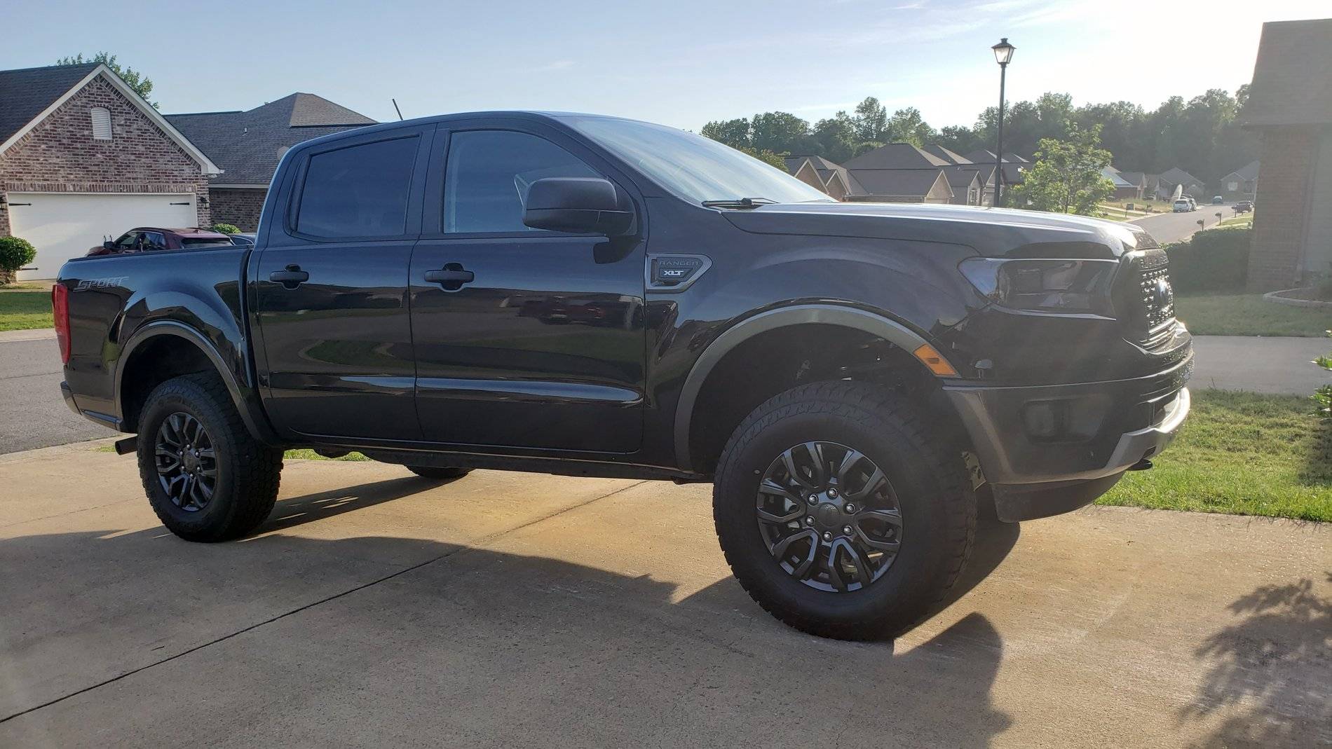

Ah, welcome to the dance Mark - those aftermarket wheels will now have you wondering about their offset and whether or not you will rub on crash bars or suspension parts and what you’ll need to do to combat or avoid that.
Is this the look you’re going for?
These are stock wheels with 31.6” tires 265s with an aggressive tread.

Yah thats about how I would like to start, 265/18 KO2's on stock wheels with a 2" lift on the front to level things out. The 21's came with cast iron spindles I don't see any aftermarket UCA's made for CA spindles as of yet. From what I have read anything past the leveling you should start considering lowering the front differential to keep the CV angle more optimum, I really don't want to get that deep into it.
As my intro pointed out I have never driven off road, with no experience why build a truck for anything but mild off road work, kinda like gravel roads in really bad condition. I am certain that once I get a taste of the wild I will further the build but for now I just need a taste.
I do like the look of the steel front bumper cut high with a place to mount a winch (desert runner I believe is what they are called) and really am considering this for my next purchase/install. To be honest I never liked that look on a full size PU but I think it really fits on the Ranger.
