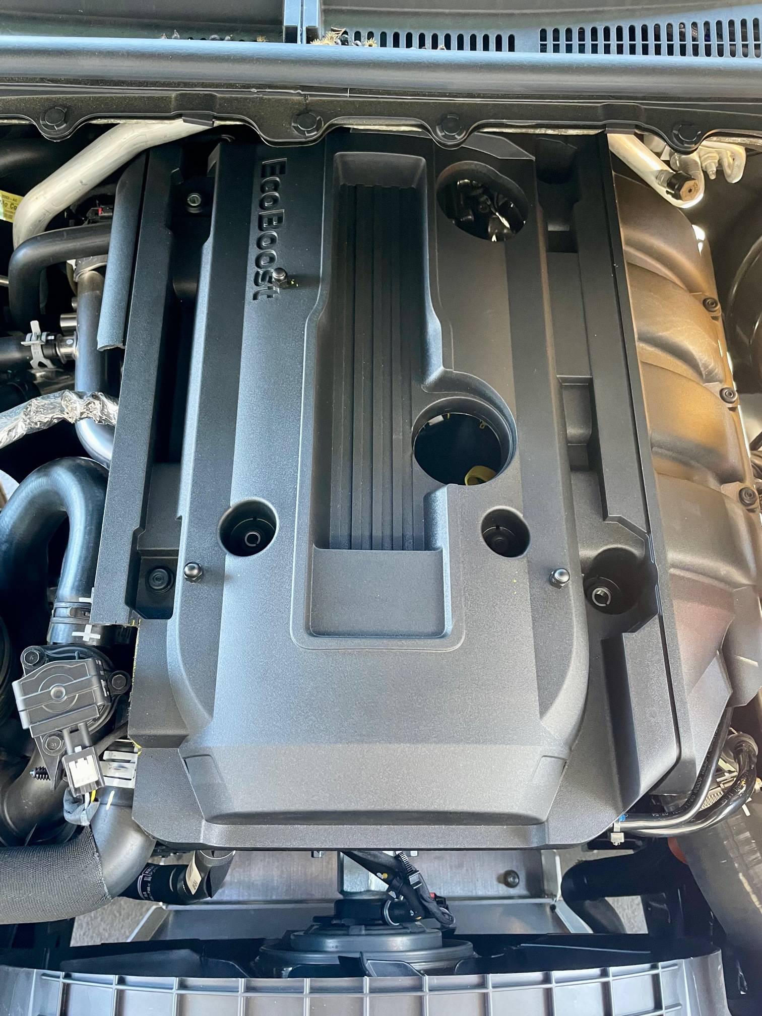

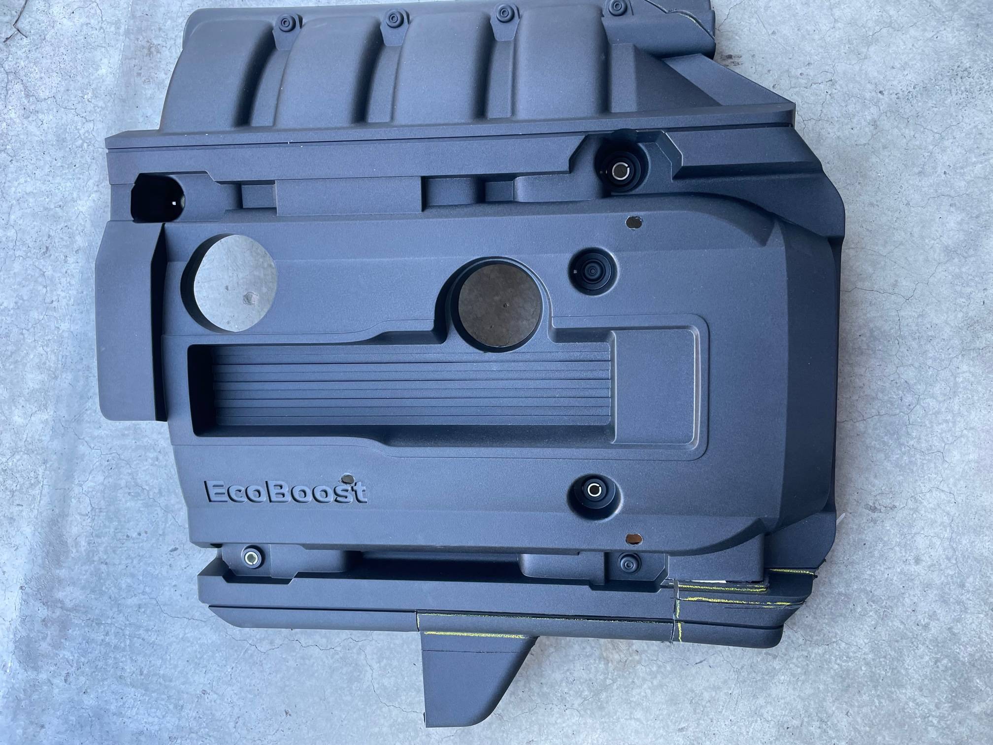

Here is a photo of the installed Mustang Eco Boost engine cover on a Ranger.
I will post more pictures later today or tomorrow.

The Mustang engine cover will fit on top of the Ranger engine.
This may not work for most people as the cover needs to be removed to check or add oil.
Not an issue for me. Three acorn nuts and the cover comes off.
I like the look this cover provides. To me it is better than nothing and visually more appealing than the now expense factory alternative.

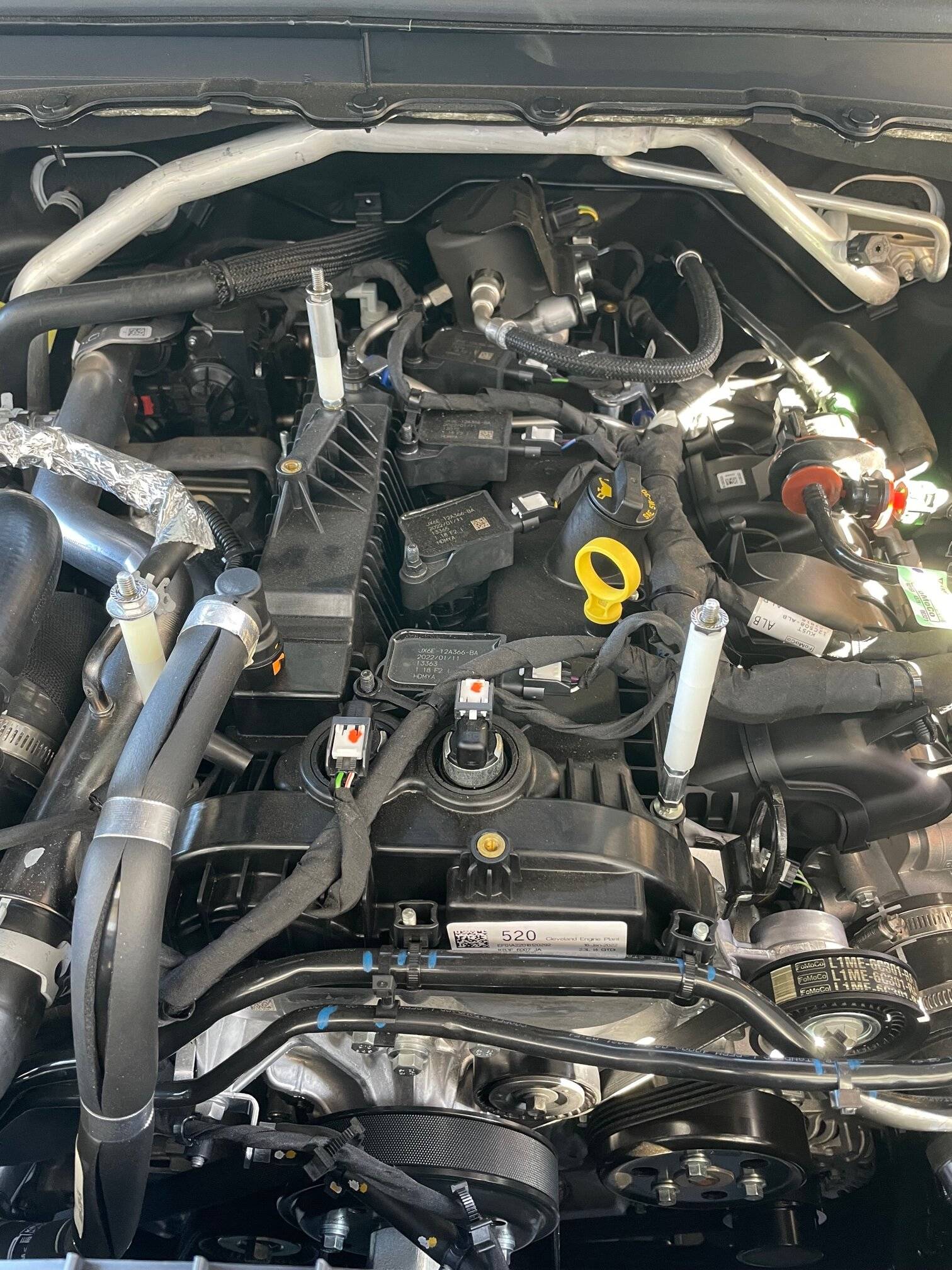

Here is what I did to make it fit.
All hardware was purchased at my local True Value Hardware store.

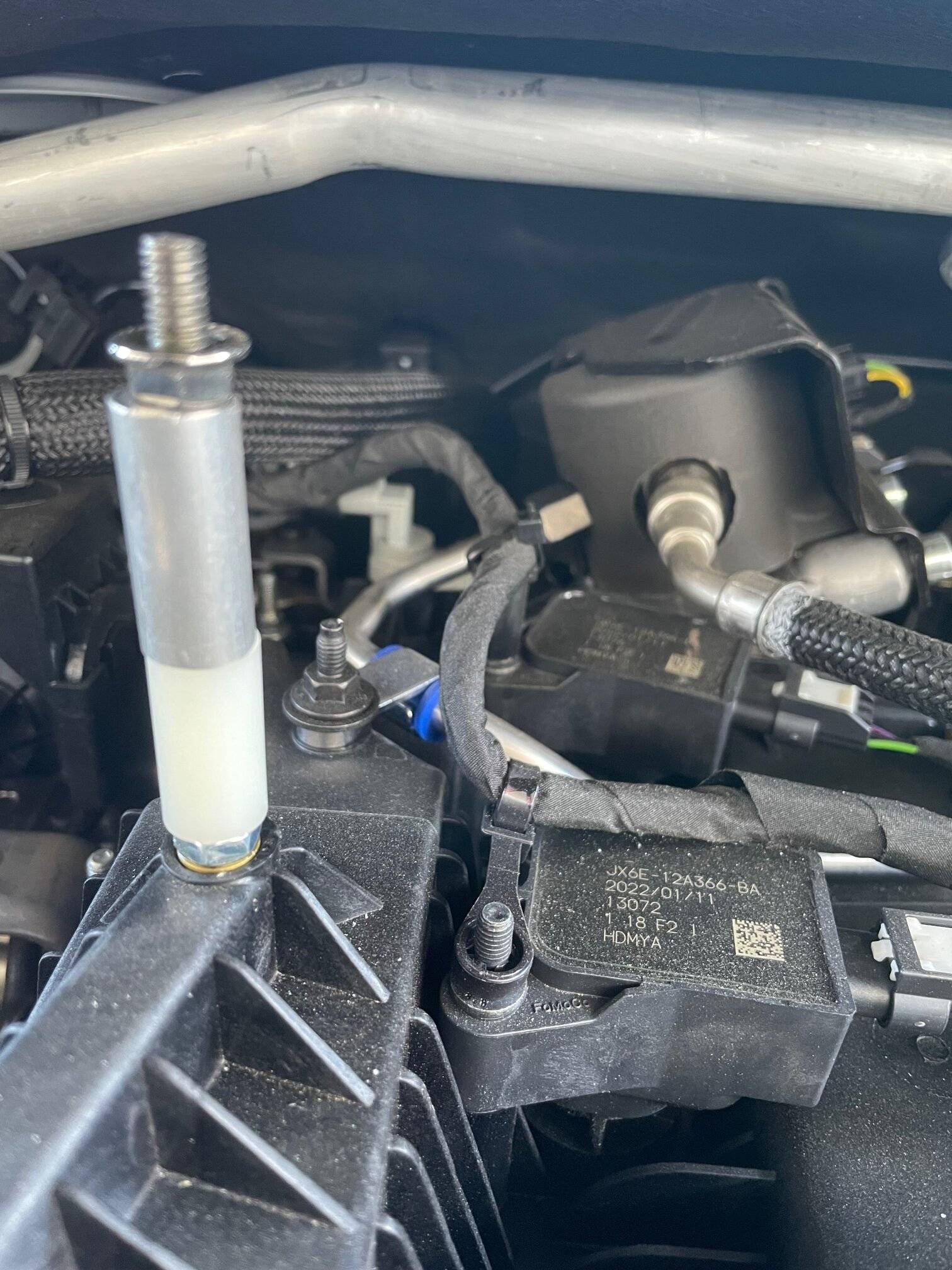

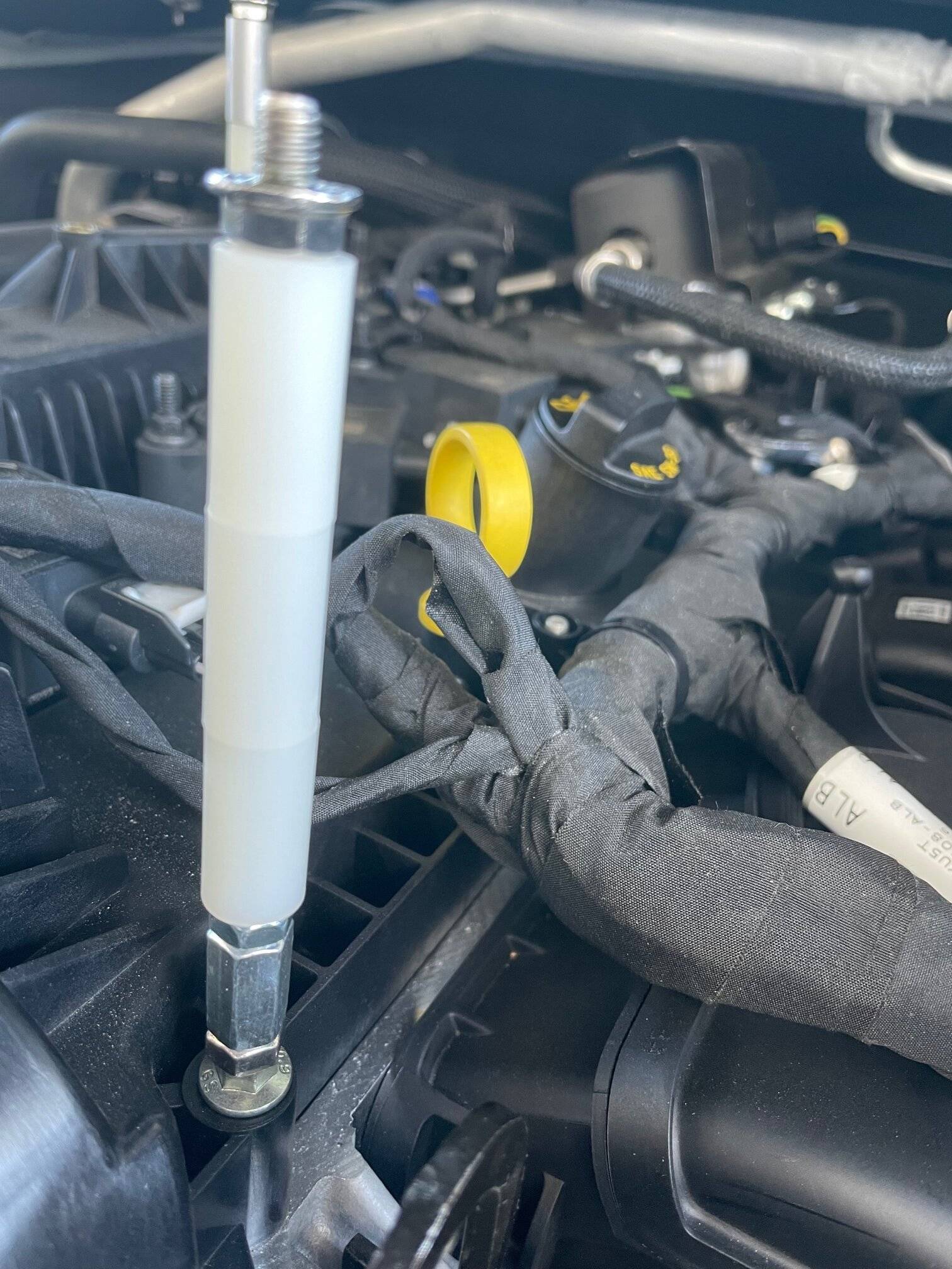

In the above photo you can see the mounting points I used.
This photo is detail of front risers. Both front risers are the same.

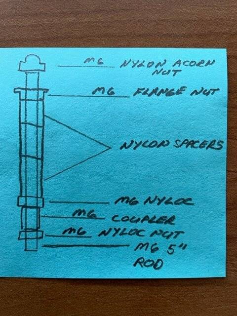

This is the rear riser. Little different configuration.
This gives you an idea of the hardware used.

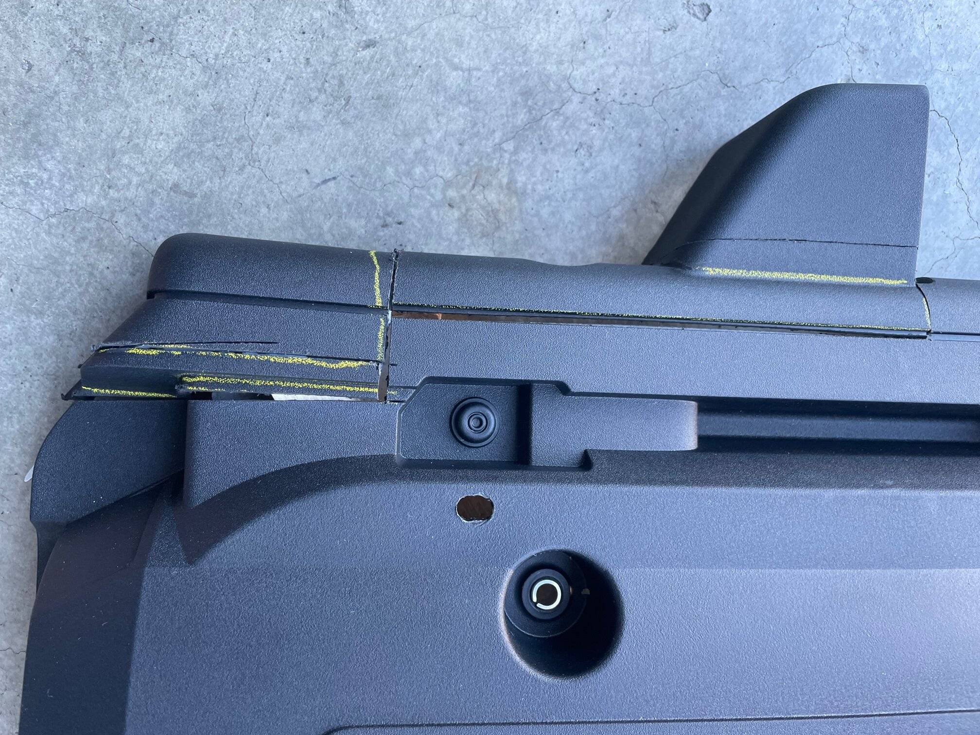

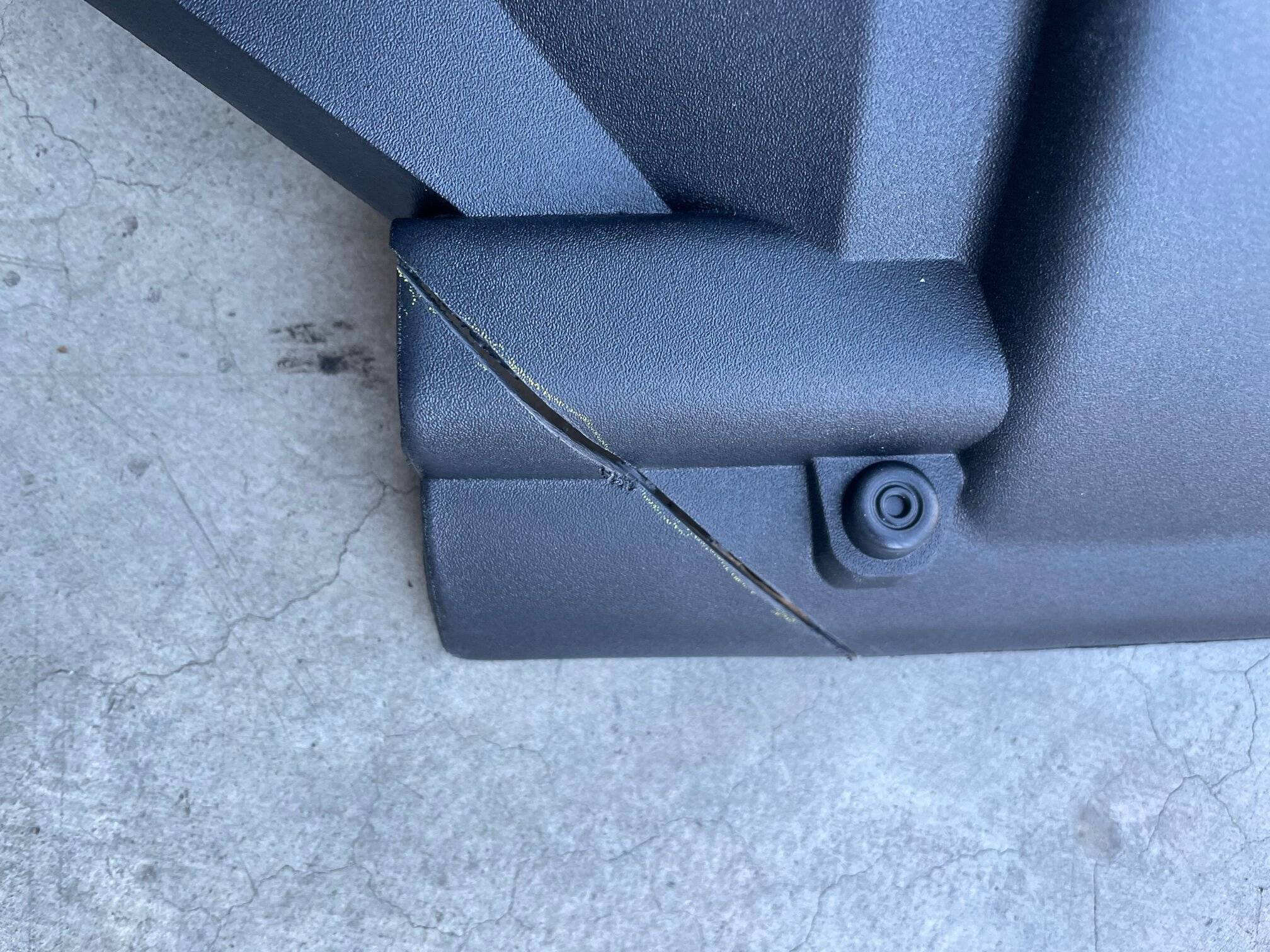

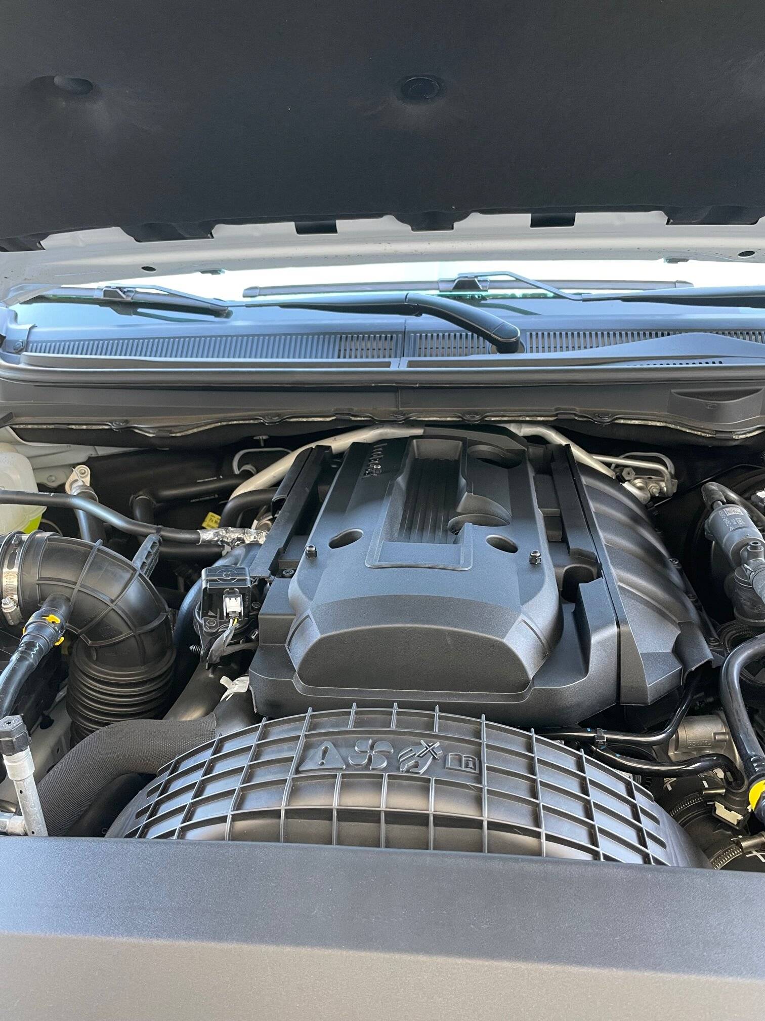

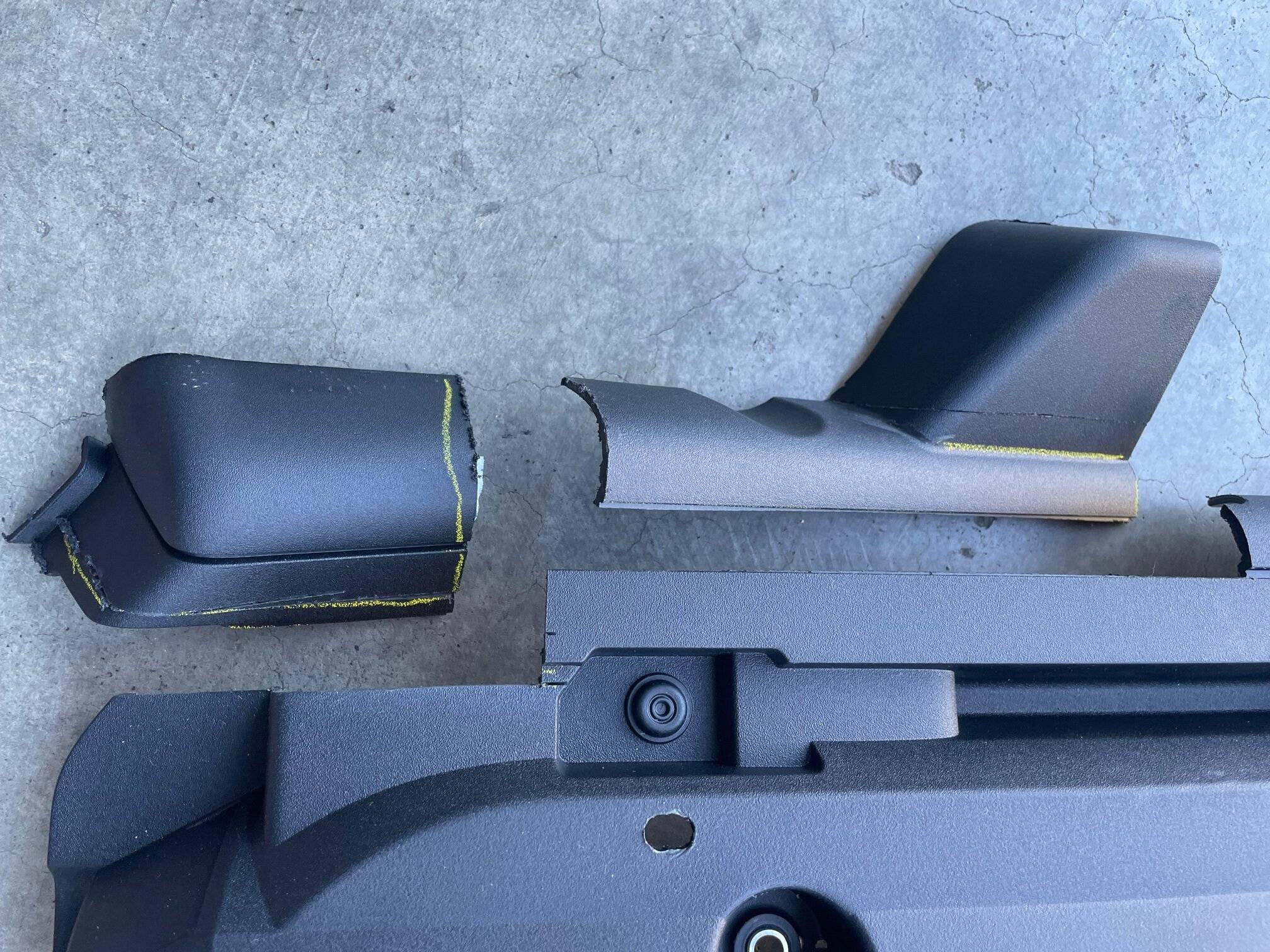

The above photos show the areas that were removed to make the cover fit on the Ranger engine.
All cuts were done using only a hacksaw. Very simple to do.

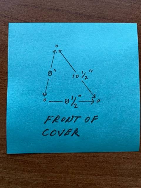

You can see in the above photo where the three holes were drilled into the cover to align with the installed riser mounting points. Measurements in the next photo.
This cover sits rather high on the engine but works for me.
Project only took about one and a half hours to complete. Plus the time getting hardware.
So this can be done. Not perfect but for now I will leave it on the truck.
