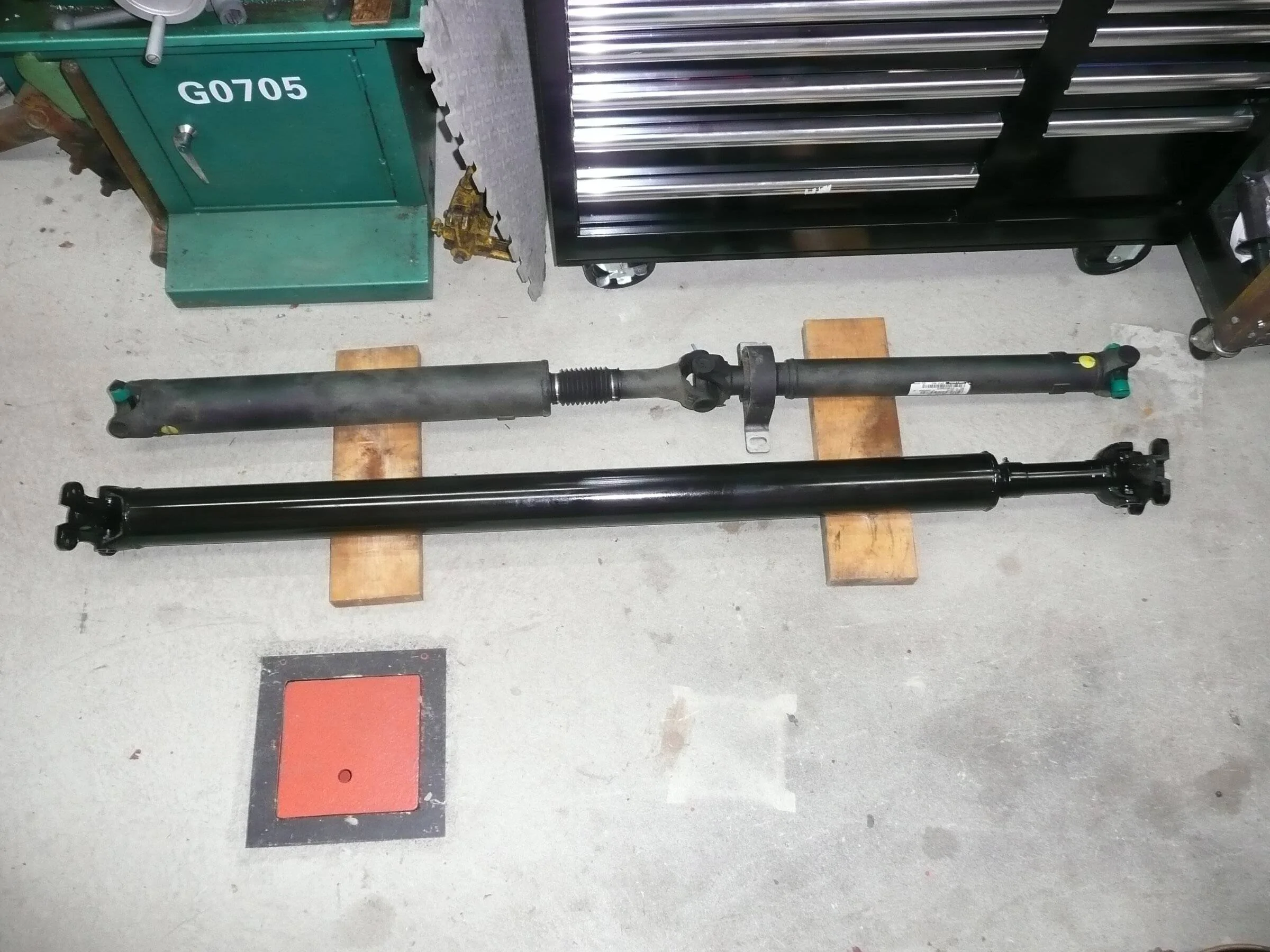

Update. After a summer and winter with this shaft I can say that critical speed failure has not occurred. I have reached speeds of 140km/hr and constantly cruised at at 125 km/hr for periods exceding 1/2 hr. This shaft is smaller than a Tom Woods shaft with 3.5" .083 tube and 1330 ujoints.
I definitely recommend a one piece shaft upgrade.

Know a lot of you been waiting for this, so here it is. Attached are pictures and details of work done.
Only drove it 35 miles. So far all highway vibrations gone, no more shutter at take off. Smooth all the way around! Drove it up to 90mph.
I’ll keep you posted once I start the work week on Monday and start driving back and forth to work every day.
I used the same parts as Vegas Ranger.
