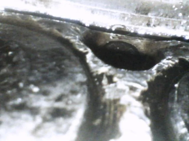

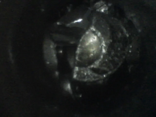

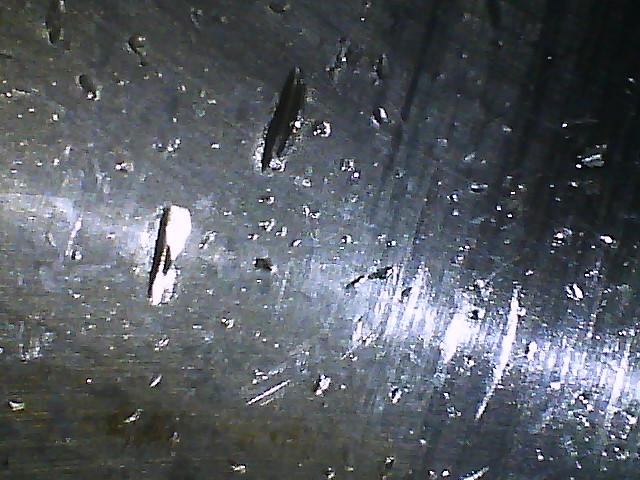

As promised, I finally have pics for you... I’m not an engine builder etc, so I have no idea what I’m looking at... but when asked what caused the failure, it was still... “All the Mods”... hope this helps... I still believe the oil pump failed, due to the “LOW OIL PRESSURE” light in red, and Ford chose “all the mods” to not cover it.... thank you Stage 3 for standing by my side.. ??

Almost looks like a dropped valve. In any event, looks like you're sorted now.

Those are about the s****iest pictures ever. Lol. It really does look like a borescope pic. Something definitely let go and hammered the hell out of the chamber and the piston from the looks of those pics. Too bad they are not clearer.
