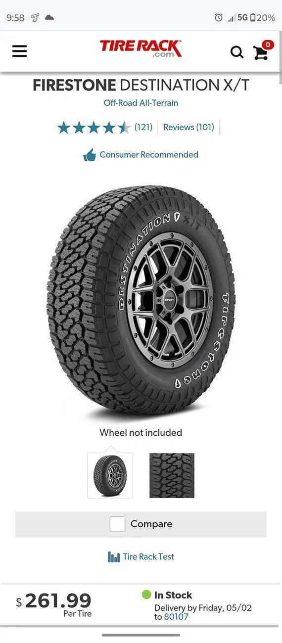

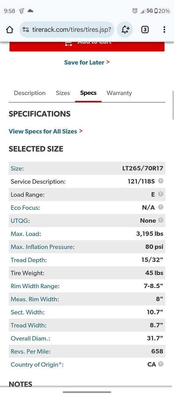

Totally understand the fair reason for going with that size. As a suggestion I would highly recommend looking at the Firestone Destination XT. It is available in 265/70-17. It is also a Load E, but it is also much lighter(45 lbs vs 55 lbs) and cost less. Also unlike some tires out there, it is made in Canada. I myself have no problems with tires from USA, Canada and Japan. From other places(like China and nearby) I suspect problems.

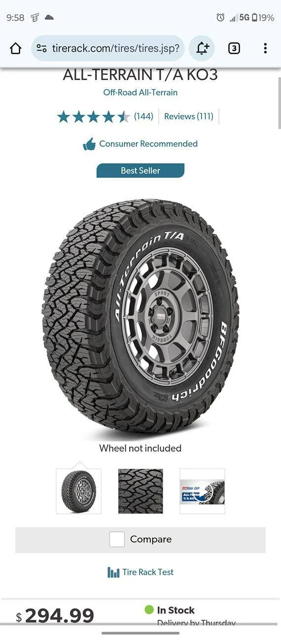

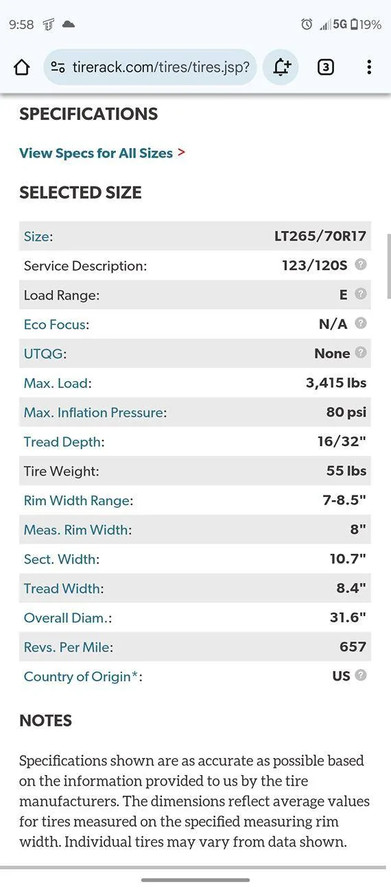

Here is some information from Tire Rack about the KO3 and the Destination XT.
KO3
Destination XT
