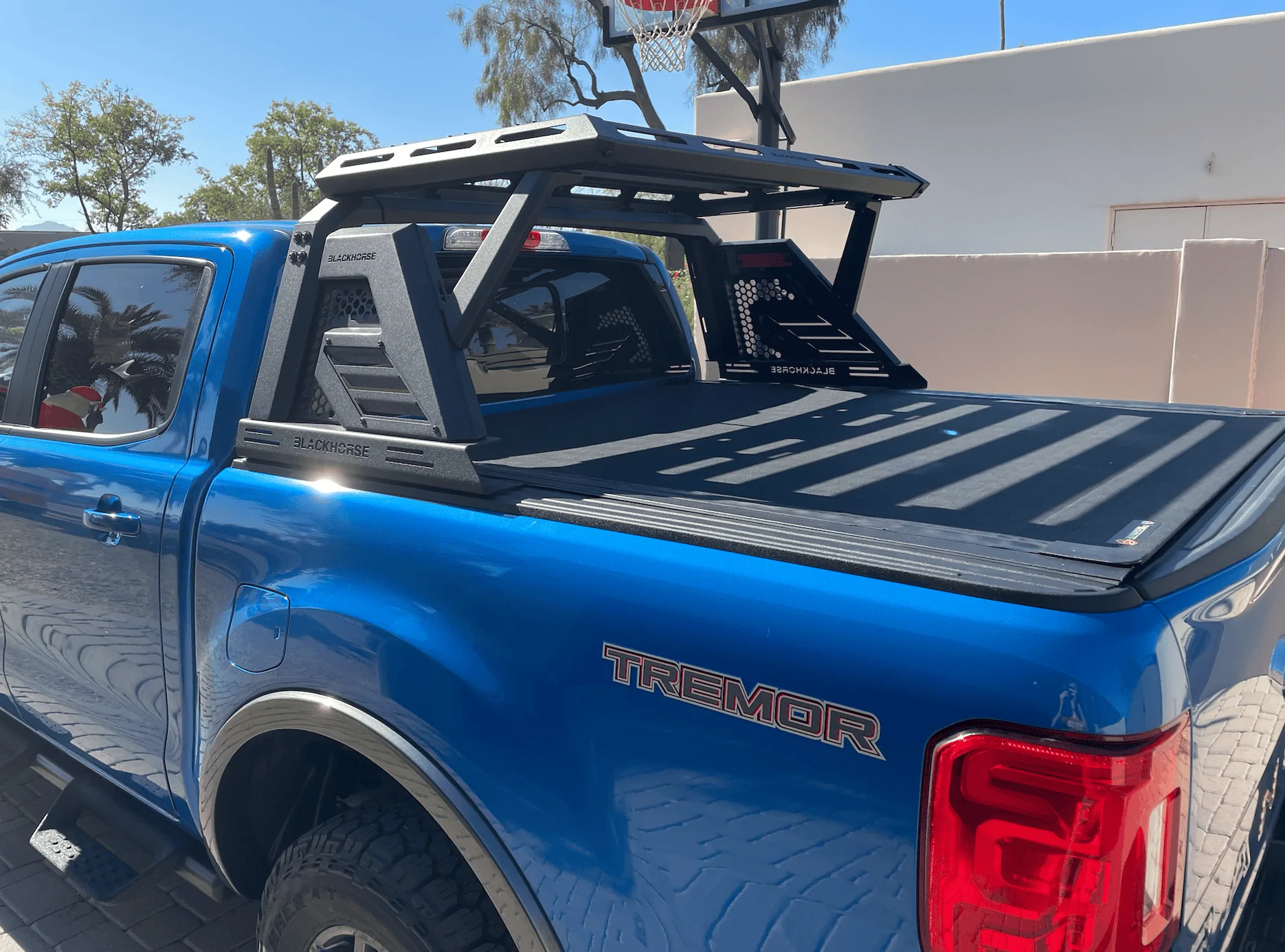

The roll bar is sold as a direct fit to the Ranger. It does fit, however, the clamp which keeps it secure is at an angle. This does seem to hold anyways. The tonneau cover rails need to be drilled in order to be able to sit "flush" with the bed rails. I use quotes for flush because the rails need to be pulled out of being straight because of how the roll bar mounts. Overall, I am very happy with how it came out and will be back tomorrow with pictures.

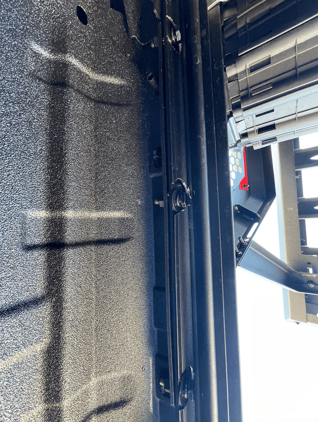

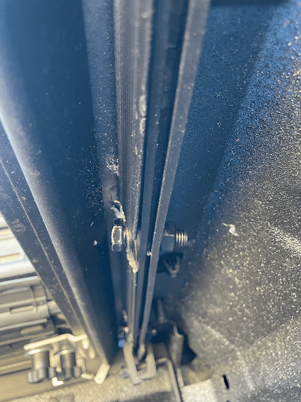

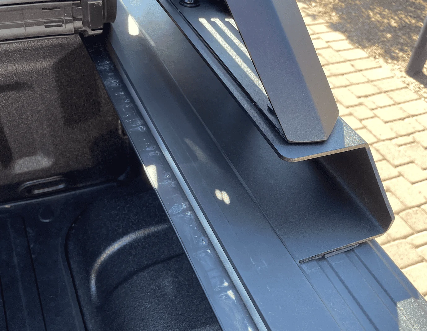

About the last two pictures:
I am trying to demonstrate the necessity to drill the tonneau rails, as well as how the clamp sits at a angle, making the lock washer useless. I did use loctite because of the lock washer's ineffectiveness, as well as a lack of easy access to these bolts.
I have noticed a whistle which starts around 40 mph or so, but is not terribly loud.
Further notes on roll bars with tonneau covers for the Ranger:
A tonneau cover makes finding a roll bar which will work incredibly difficult. In order to not need any modification to the tonneau, it is my belief it would be necessary to drill into the top of the bed rails. In order to avoid further frustration, it ought to drill toward the inside of the bed rail in order to avoid the angled reinforcement.

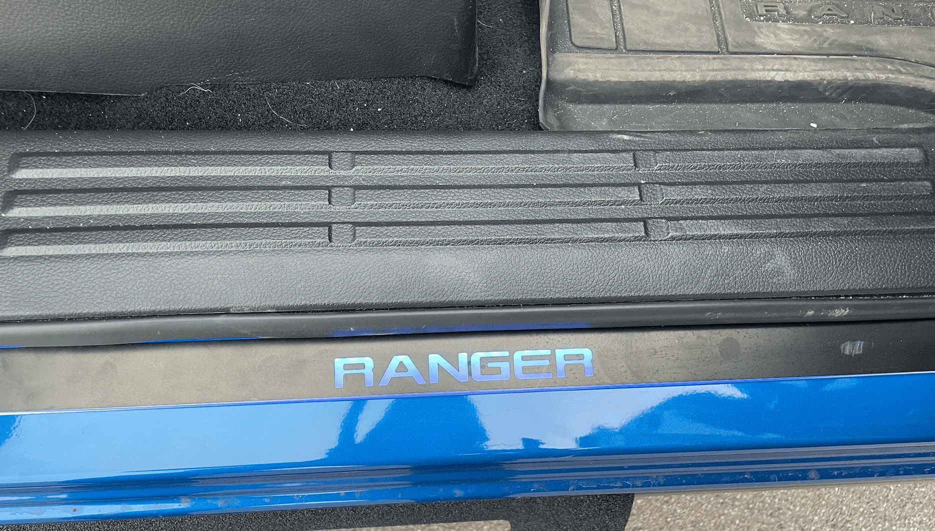

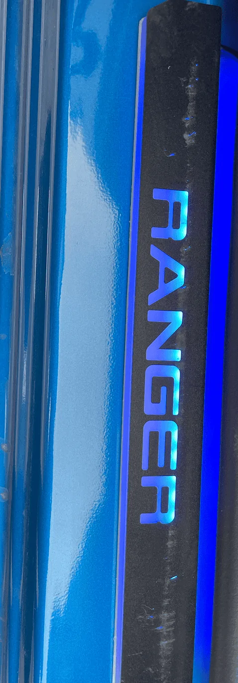

Been longer than I wanted, but I got LED Door Sill lights installed. Pics below.
Install:
Overall, these were a pain to install. Peeling the trim pieces back was... interesting. The first one broke two of the retaining clips. None of the other three broke. The connectors for the door sill lights barely fit together. Lastly, the wiring instructions tell you to splice into the white wire with the green stripe. Unfortunately, there are two white wires with a green stripe.
Other notes:
These scratch really easily. I would recommend a clear protective tape over the top before installing these.
