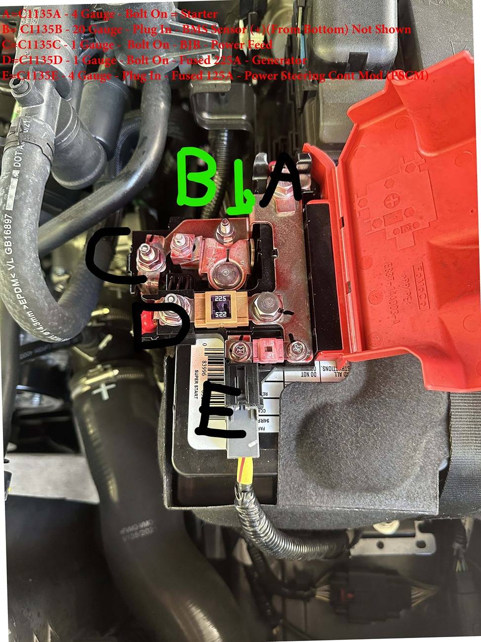

Found this for you on the Aus Ranger site, this is specific for the 3.2 diesel. May be of some help.
The owners manual says;
'After battery replacement, or in some cases after charging the battery with an external charger, the Battery Management System requires eight hours of vehicle sleep time (key off with doors closed) to relearn the new battery state of charge.
Prior to relearning the state of charge, the Battery Management System may disable electrical features (to protect the battery) earlier than normal.'
The BCM (Body Control Module) knows the age of the battery, i assume it uses that and temps and current drawn of battery and put back in and voltages to work out the battery state of charge and may alter its charging algorithm?
The battery age can be reset, by a Ford dealer OR by using software called Forscan and correct OBD2 lead (many members on here have it, i have it) OR possibly by any decent OBD2 scan tool that good workshops would have.
When i replace my battery i will reset by battery age, not sure if it will make much difference, but why would they have the age and age re-settable if it wasn't used for anything?

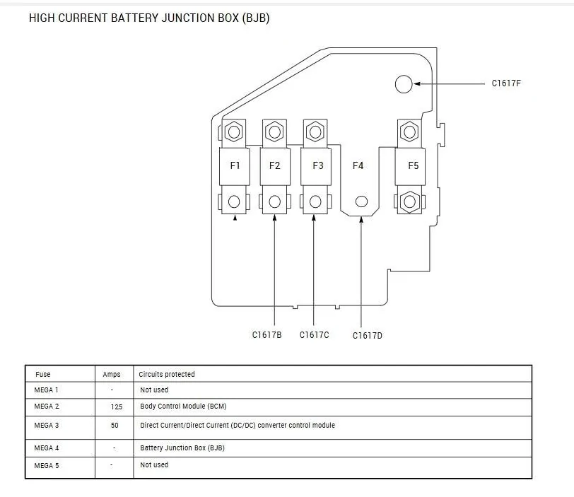

Power to the OBD Port, comes off the 125-Amp fuse, so if it powers you have power on the circuit. at least.

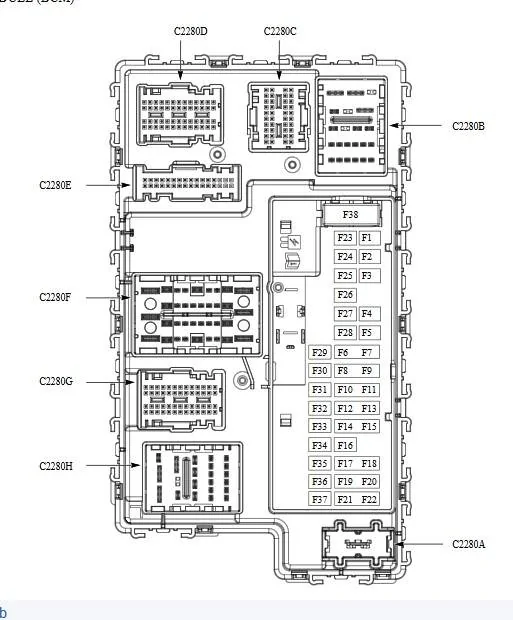

You can also, check for power at the BCM connector - C2280A, pull this connector off and check for voltage - this is a direct feed from that 125-Amp fuse.

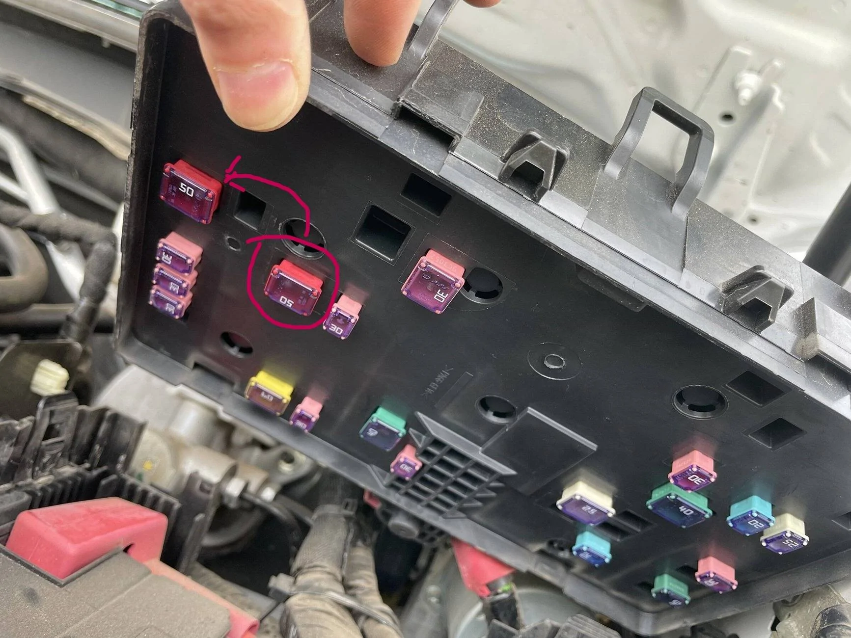

1. The 125-Amp - Feed to the BCM
2. The 50-Amp - Feed from the DC/DC Converter

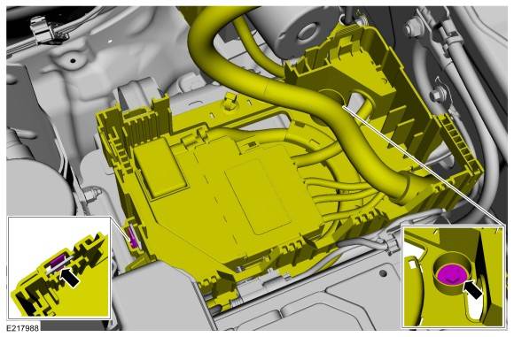

Note: You may try, disconnecting and reseating the DC/DC Converter (connector)
Yes, good call on getting a technician there to look at it, as this is going to take some wiring checks to locate the issue without shot gunning parts at it.
DC/DC Converter Module (Location)
