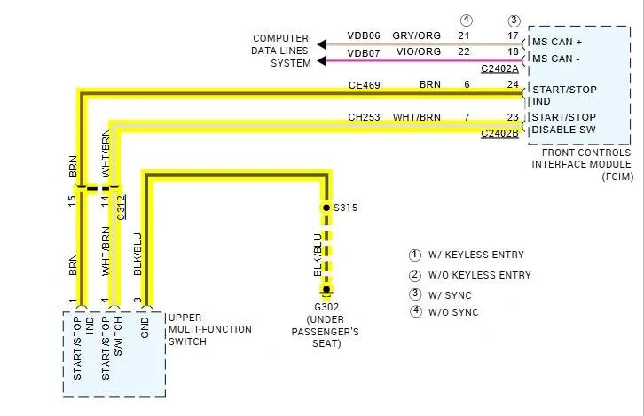

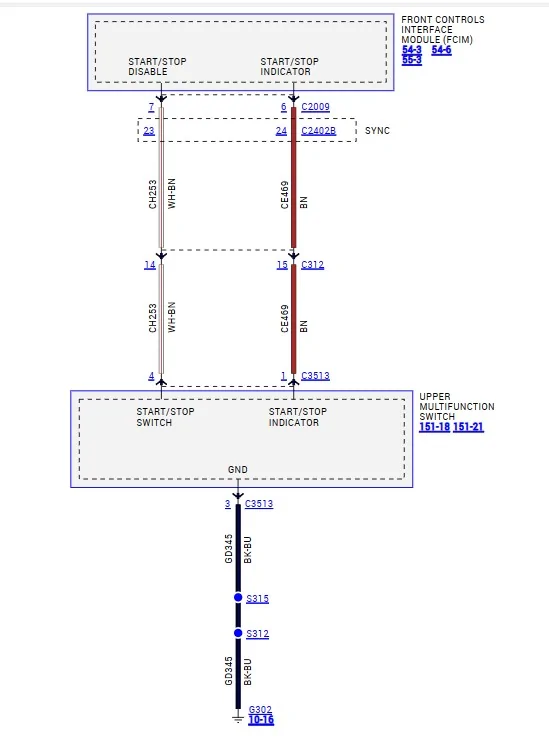

I have a hunch that the Switch and FCIM are not the root problem (original issue)
The switch was replaced and created another issue.
My thoughts point towards the Trailer Brake Controller or Inline connector going to the Rear Taillights affecting both the ASS and Turn Signal Circuits
or
Since they have had the FCIM off, then possibly missed reconnecting the Hazzard Switch connector.
What the heck do you know!!! ? J/K ?
