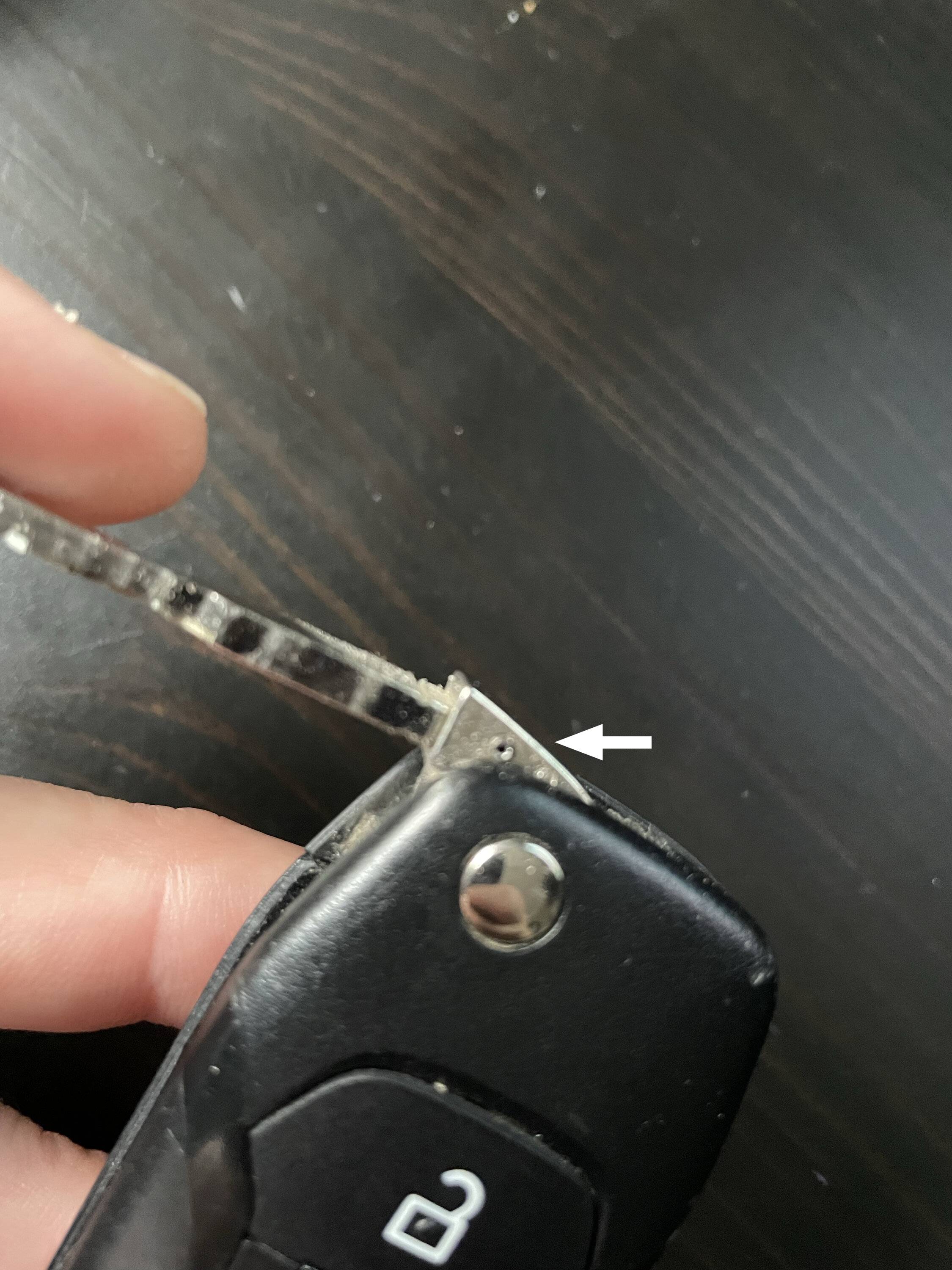

Both my FOBs did this--Started with FOB pointing away from me-Key in closed position, facing 6 o'clock position--Release key and hold in the 9 o'clock position--small roll pin at base of key had moved/extended outside the key-pushed/center back into position, using small pliers-- now flush on both sides--Works great, no lube needed, as pin was rubbing/contacting side of FOB housing!!:like:

My key just started sticking and I tried lubing and the roll pin push thing, but it still sticks. I am afraid I might need more intervention, perhaps a young priest and an old priest too...

I had this happen the little black pin was sticking out on one side so i just pushed it back in a bit and wiped the blade down to clean it up and blew some lint out

Only problem I have with my key is that this little pin works its way loose. When it does the key doesn't want to shut or open correctly. When I feel it start to not open smoothly, I push it in and the problem is solved for a while. I had a VW key that did the same thing.
