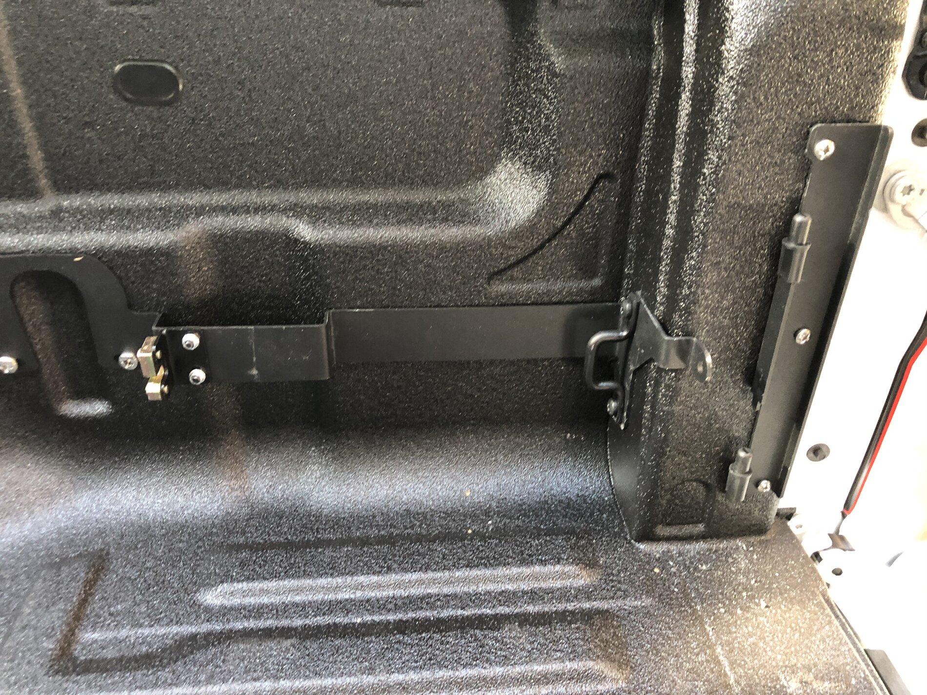

Can you share a pic of the mounting bracket? I just received a pair of these, but no instructions. [:-(
Of the steel things holding up the rails? The instructions were absolutely horrid from what I remember

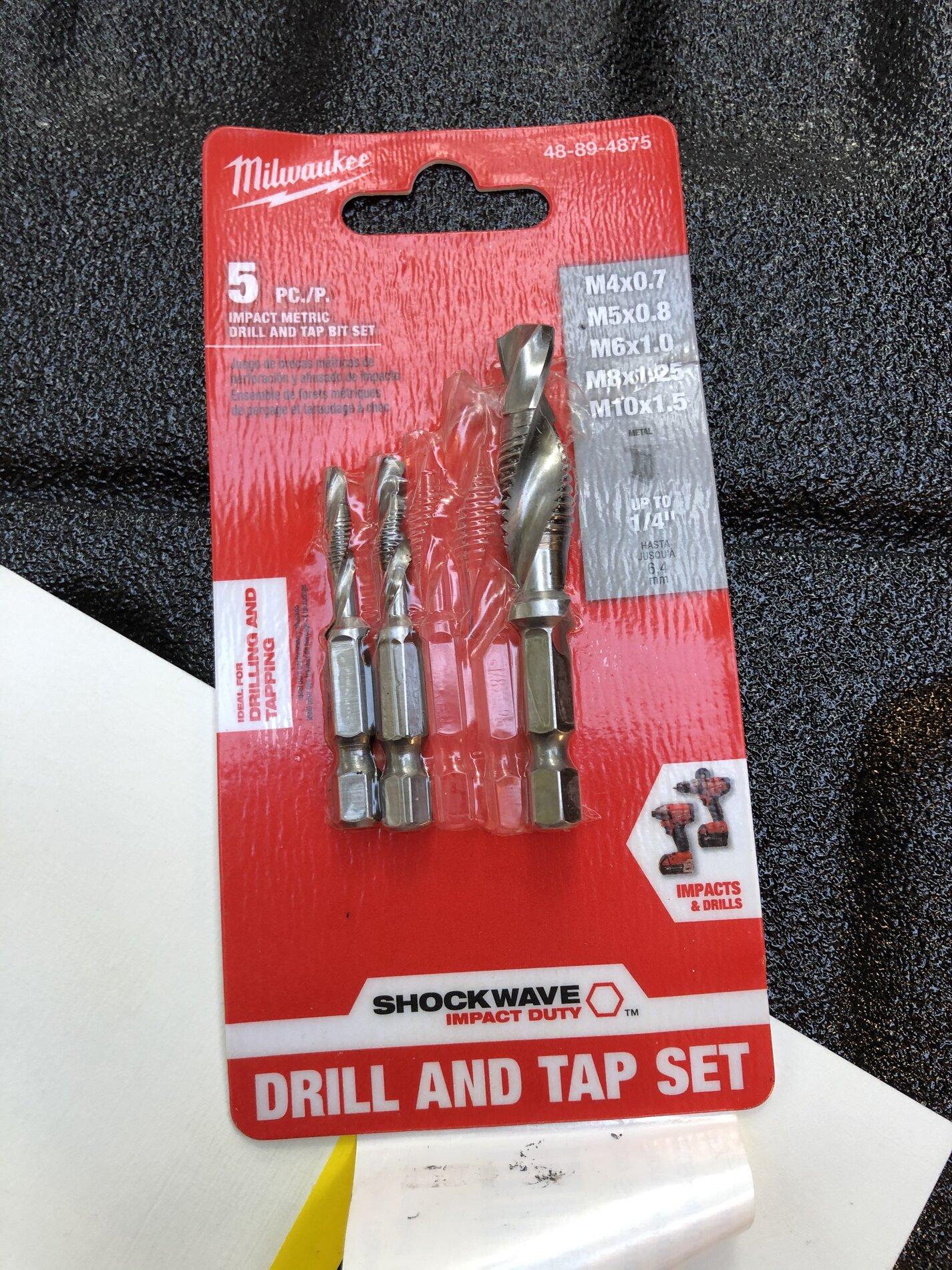

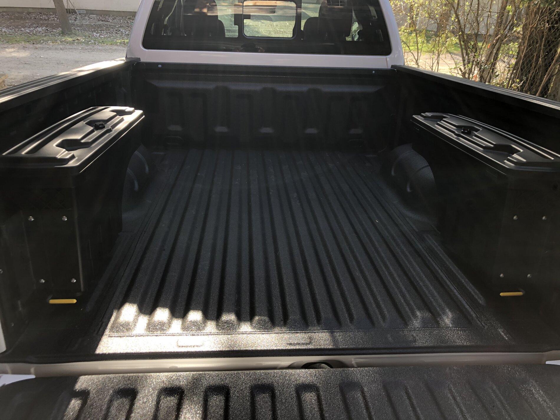

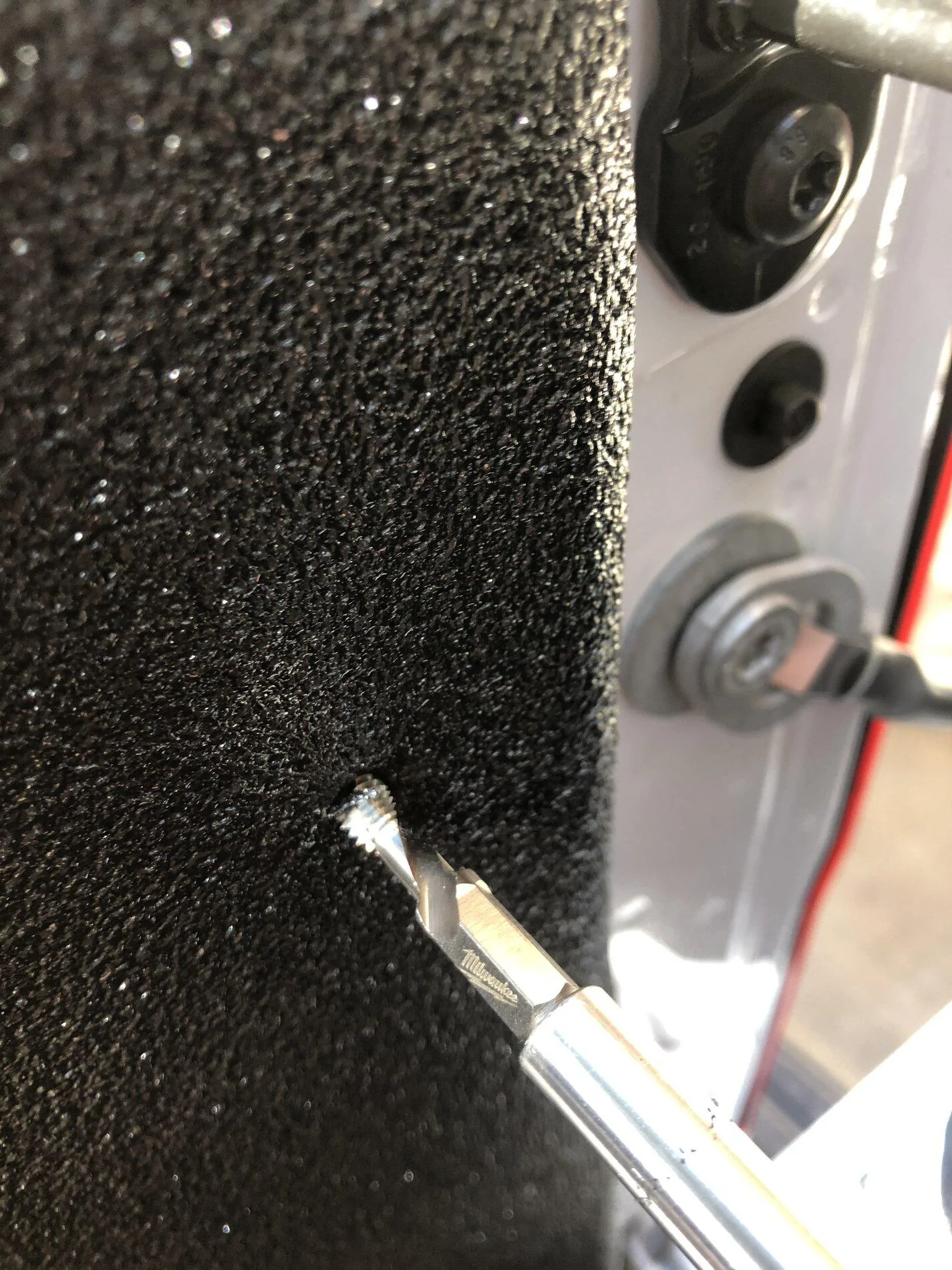

Okay, got mine in. Thanks for all the help. The guy a LineX said they typically don’t block the unused holes, though they do remove/reinstall the tie down hooks and plugs. I did get a set of drill/taps at HD, it was pretty easy, and I got SS M6 and M8 screws to replace the self-tapping screws that come with the boxes

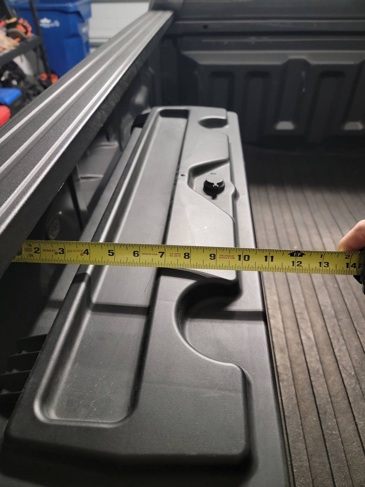

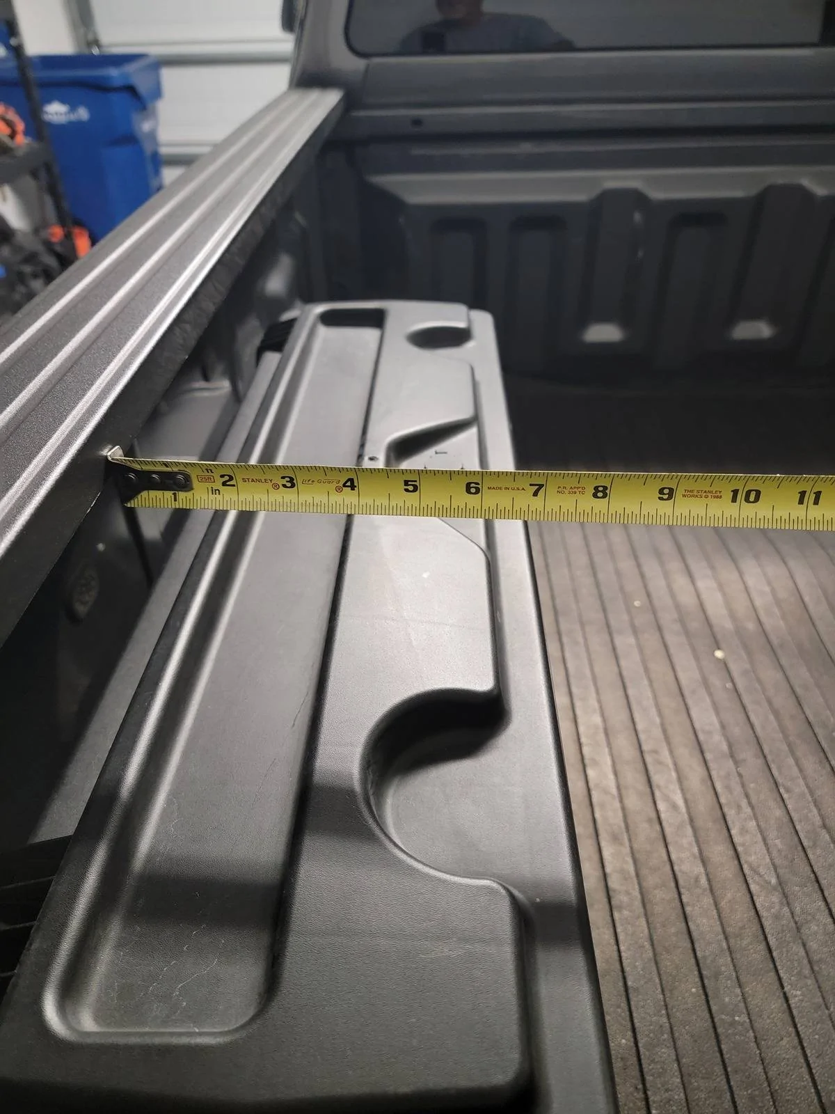

Does anyone know how far from the side of the bed the box extends out to? (or just the width of the box). It looks like it's maybe 6" or so? I'd like to get an idea of how my camping gear would fit in next to it. (I keep things at the back of the bed for quick access but want to maintain a path to the front.)
