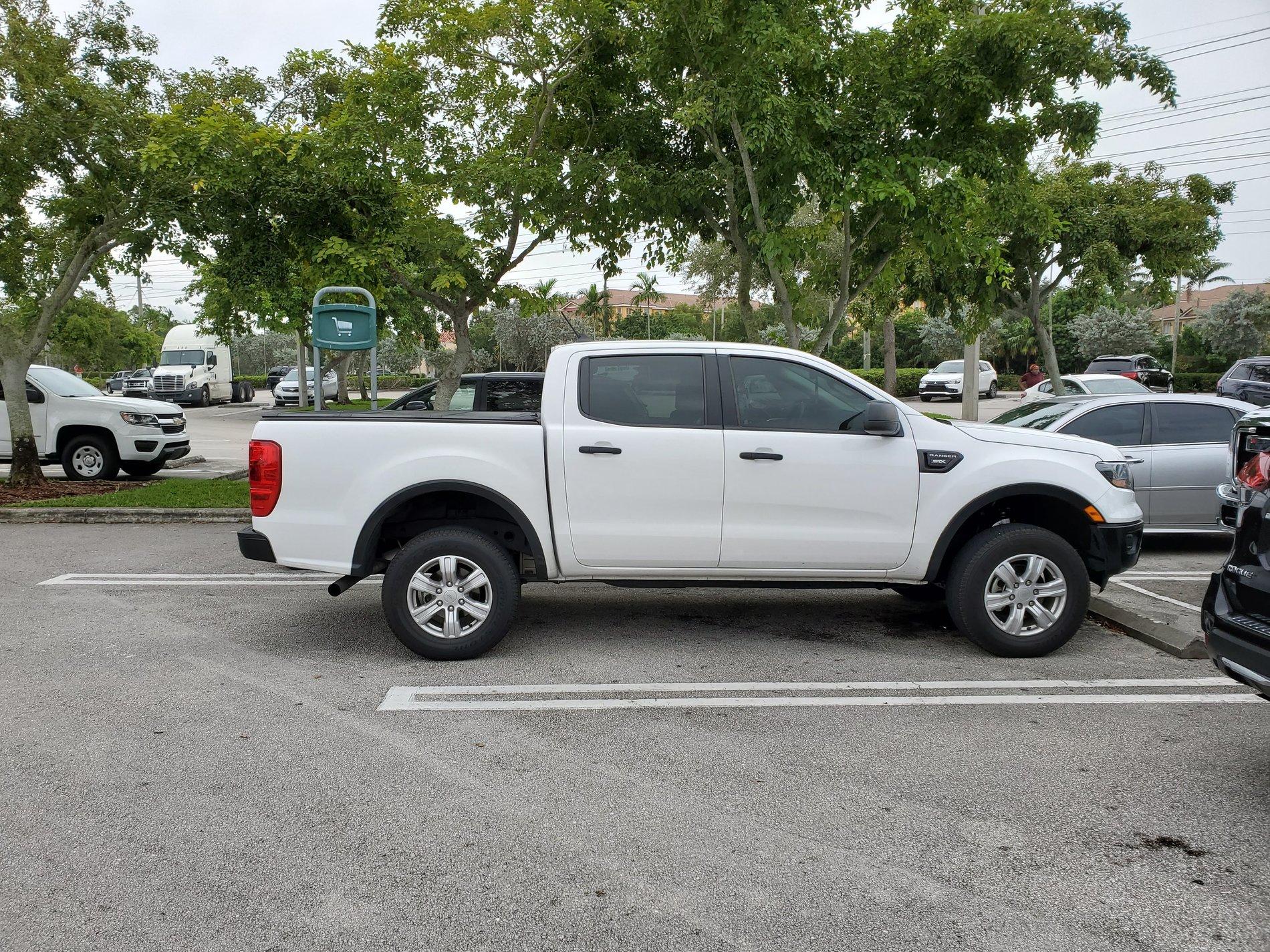

I'm curious about the lift amount/feel of these collars on non-FX4 suspension. A leveling kit is high on the list for me and I think these are going to be the way to go. I like the idea of the increased preload for better off-road feel.
SN13
Sep 14, 2019
223
412
Florida
2019 Ranger XL Oxford White
Mine is a 4x2 so I have no FX4 suspension or anything.
My Front wheel marker Lights were 28-1/2" before the lift (measured to the bottom of the light) and are 30-3/8" after.
