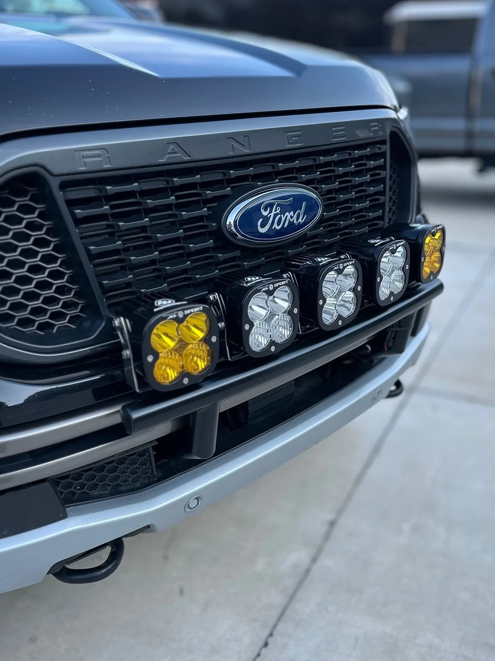

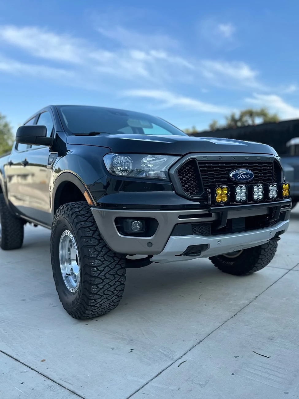

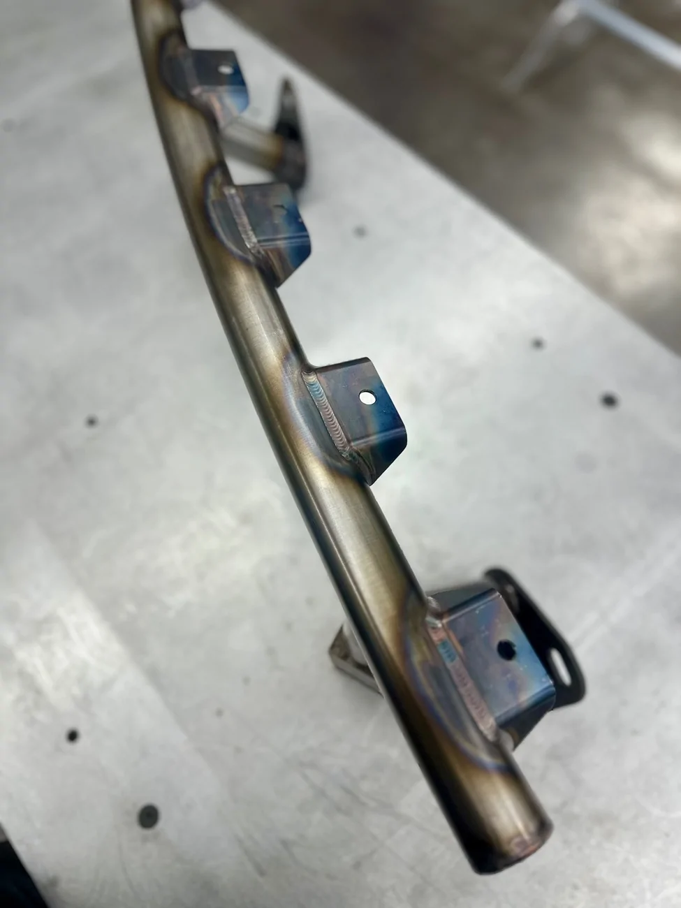

Here’s the one I built for myself. 1 5/8 .083 tube, .125 tabs, .188 mounting plates, 100% 4130 chromoly, and tig welded. A little overkill but I work in motorsports so I have more scrap chromoly than I have stock of mild steel lol

omg THAT THING IS SICKKKKKKK. Would you want to make some side money fabing me one? Also how did you bolt it to your truck? Also did you powder coat it or did you just spray paint it? I think thats the nicest mod i have seen in a very long time. 100/10 brother very well done.
Thanks! I just spray painted it, good ol’ rust oleum lol. I’ll send you a message!
