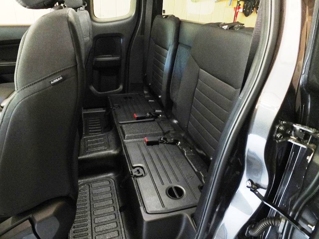

I never posted the pictures here of the mod I ended up doing. Used black tarp rivets, turned some delrin plugs and here’s the end result. Interesting that during disassembly on the back of the headrest two metal plates with protruding legs are double taped on. The only thing I could surmise their use for is in an accident a whiplash head would contact the headrest that would then breakout the rear window. So... eliminated those as well. Came out pretty nice
Perhaps they just wanted extra support across the full width of the headrest? I removed the rear headrests on our 2019 SuperCab shortly after we bought it and I don't recall it having those.
What's the bottom line? Who knows. If it's a safety thing, why didn't they retrofit previous versions? If it isn't safety related, then what?
Regardless, the production line changes that Ford does are just weird. Some of it appears to be procurement related. Seems like they should provide documentation to the dealers so the vehicles can be "made whole" either before being sold, or when the vehicle is brought in for service. I feel it's a disservice to the customer to just pass the truck on through when it has parts missing.

Just did the fold 'mod'. 2020 with build date of 10/20 still have the folding mechanism. That has to be the stupidest money-saving move I've seen yet.
I only had 3/8 dowel, and it still works fine. 1 7/8 inch dowel, a felt sticky round, in and out in 5 minutes*
*never did figure out how to remove the rear seatback. Removed the bolt, yanked, tugged, cursed, went back and searched the internet, then gave up and just yanked the headrests off with will of mind.

They must have changed the design? On our 2019... they just pulled right up and out. Easy Peazy
They do pull up and out.... IF they are folded. Unfolded they hit the headliner and it takes some persuation to come out. You can loosen the bolt to allow the seat back to bend a bit, which I did on the first one because I was trying to remove the back. Even without the bolt I couldn't get the back to come off, so I just yanked the rest up and out. On the 2nd side I didn't remove or loosen the bolt, I just yanked until it came off.
