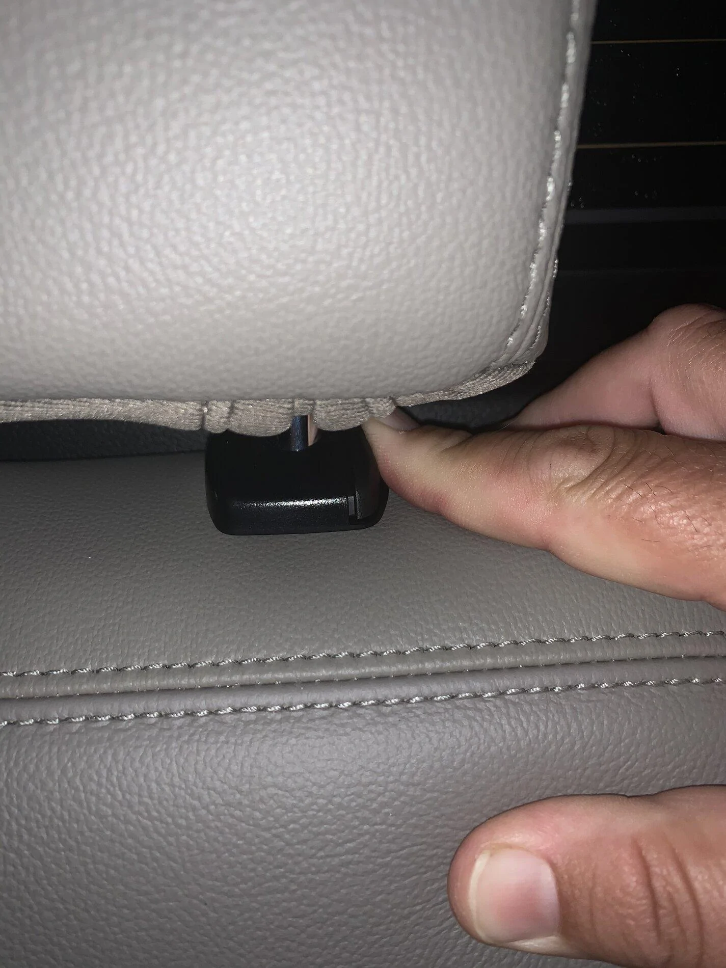

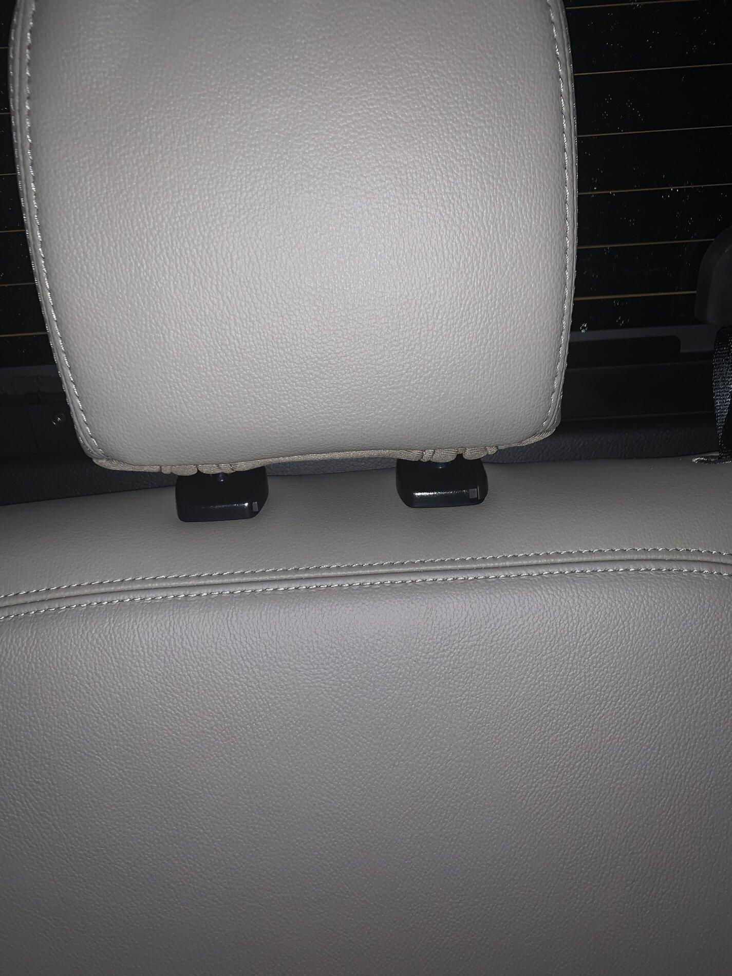

Here is the button, if you push in it feels spring loaded like the headrest should adjust but nothing happens.

You have to push the button on the other post as well, and at the same time holding both in, before the headrest will move. It's on the same side as the one you are pressing on, just the other post.

??‍♂omg! Thanks for that course correction..
