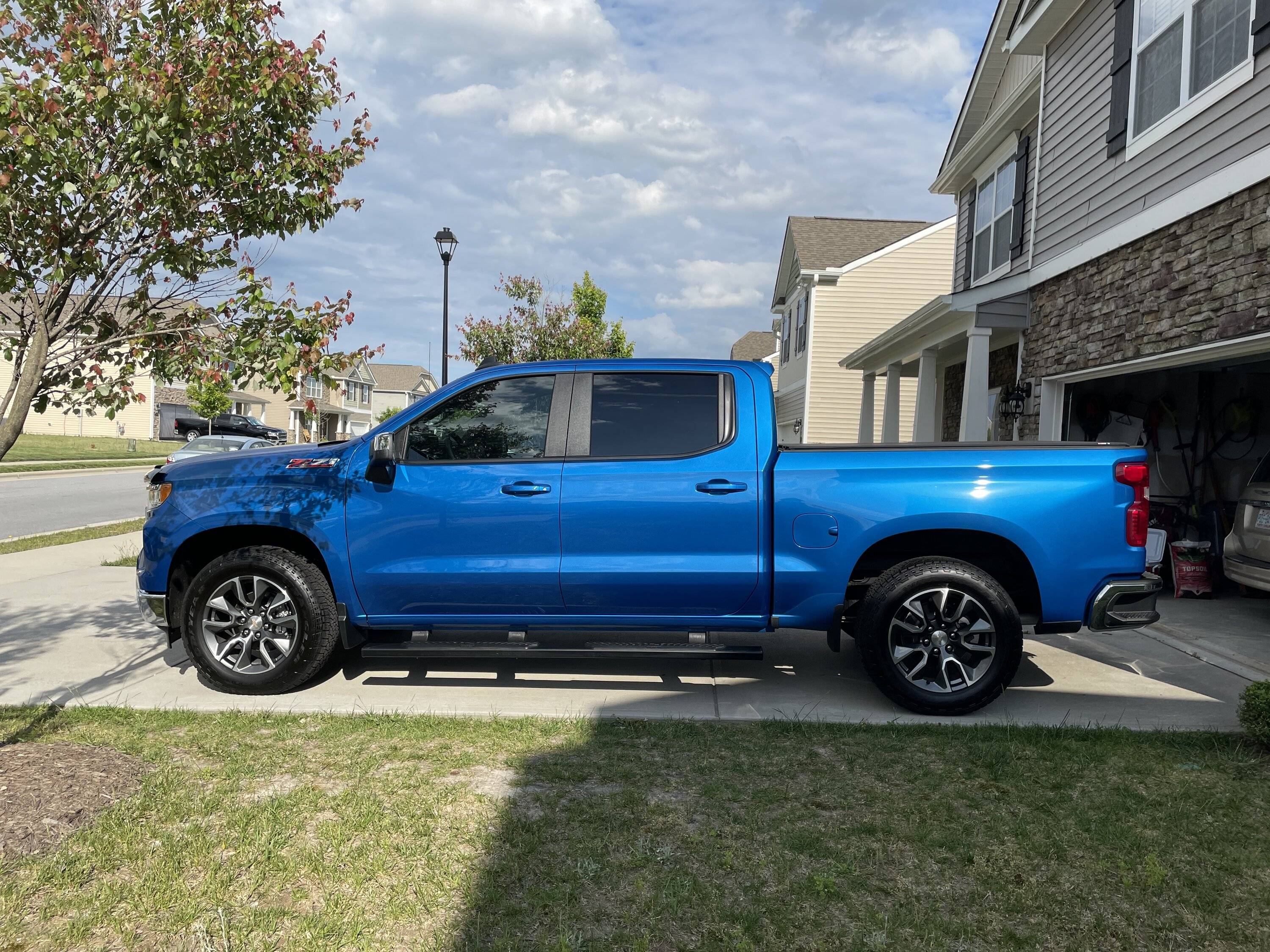

Nice choice! The Ranger was my first truck, but I just needed something larger to fit my family better. I test drove some of the 2.7L F150 STX options, but I ended up in a new 22 Silverado LT 5.3L V8 in Glacier Blue.
