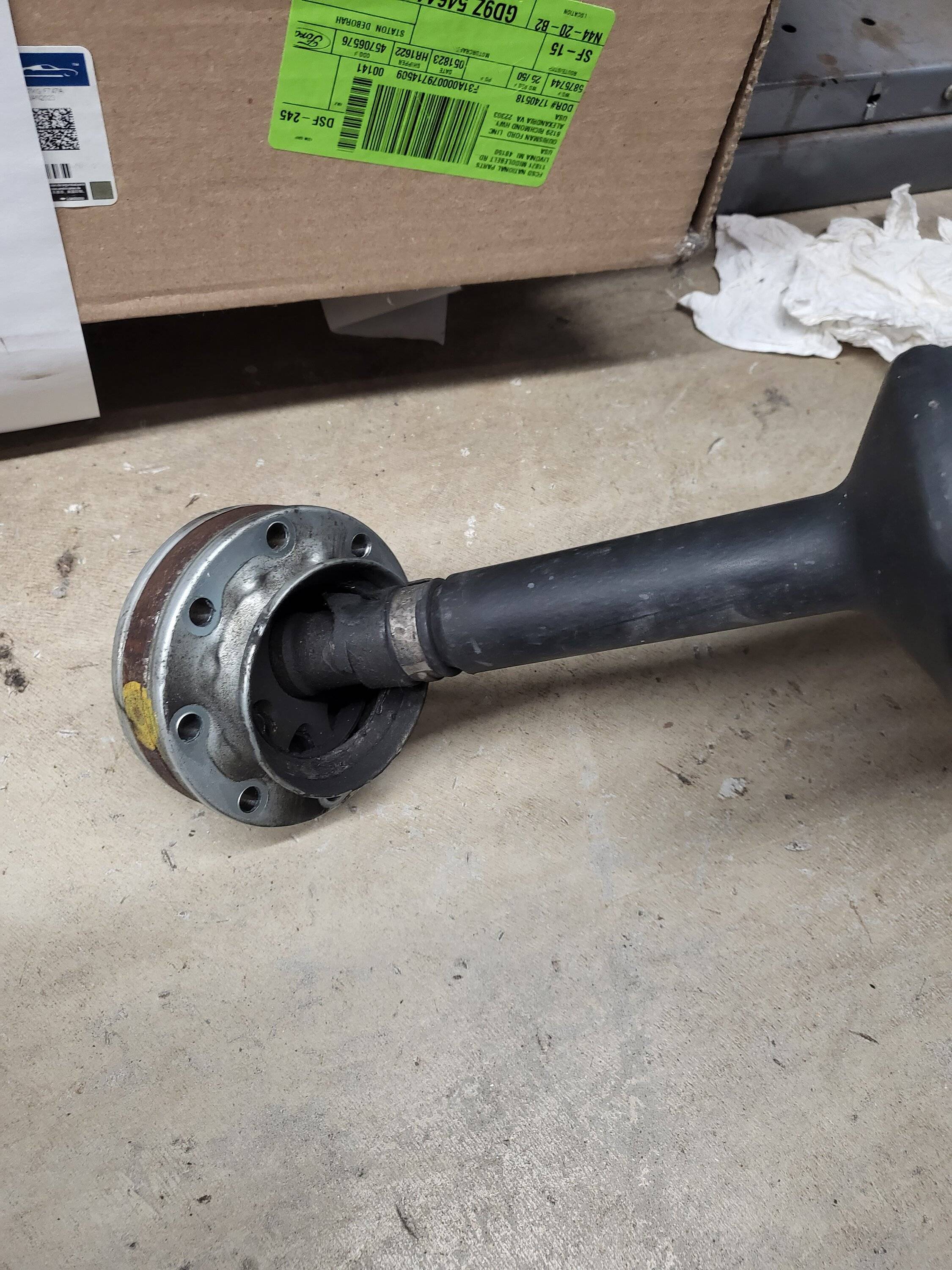

New Driveshaft being installed on Monday. I'll provide feedback as soon as I verified if it fixed the issue or not. The rattling noise during acceleration is veeerry annoying.

UPDATE: I just got back from the Ford Service Center after having a new driveshaft (OEM) installed. I will reiterate that the issue I was having is tapping/rattling during acceleration, not thumping when braking. First let me state that the issue is resolved. When I went to pick up my truck, I asked to see the original driveshaft and the mechanic, so they obliged. I took a photo of the issue. It clearly shows the boot protector torn off from around the bearing housing. Now I don't know when or how that happened, but the result is over time dust and oil got into the bearing and prematurely wore it down.
I know this is most likely a unique situation, but it might help someone else if they end up with the same symptom. For you guys with the thump when braking, I can't make judgement about the carrier bearing. Mine still looked ok on the old shaft.
