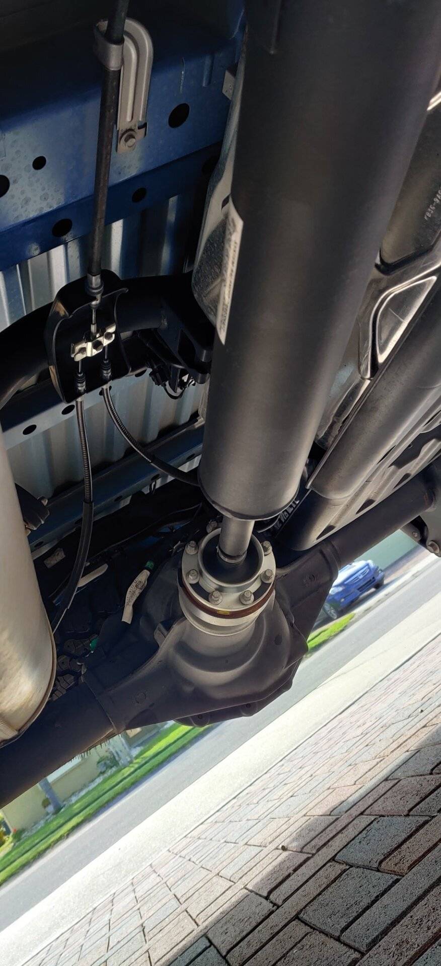

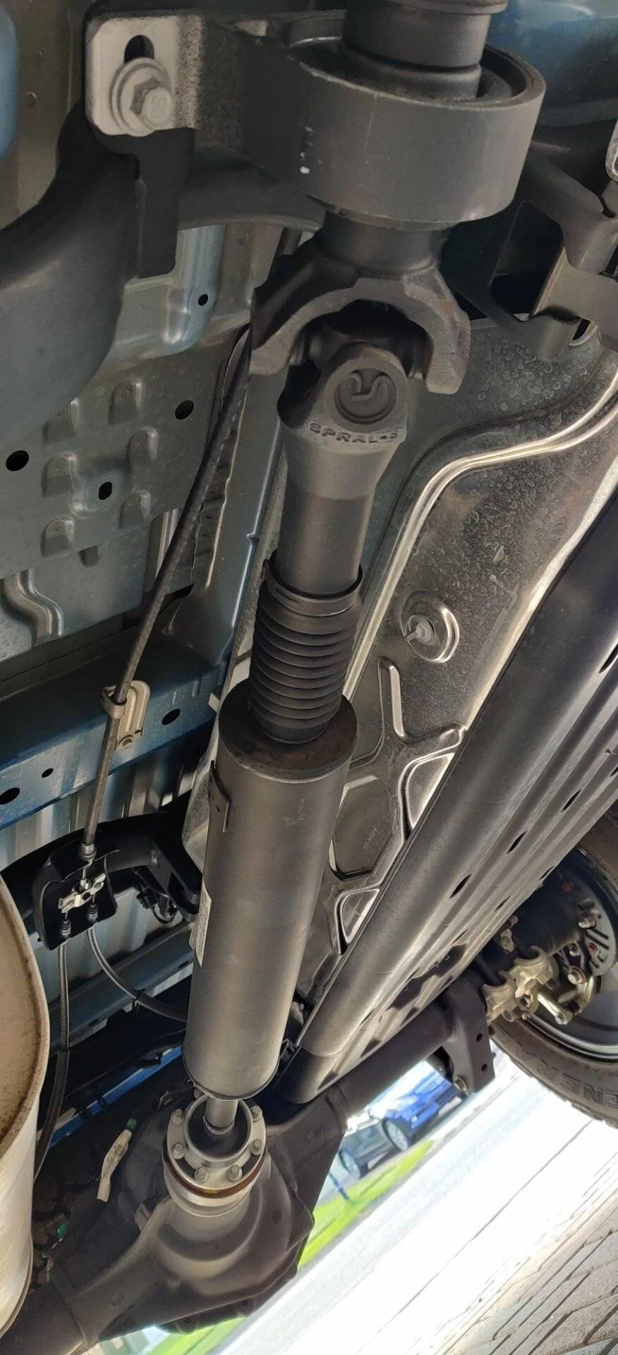

Looked under truck for a good place to mount the go pro and will have to make a bracket. While there took some photos and the drive shaft doesn't look like the one in the below video.
