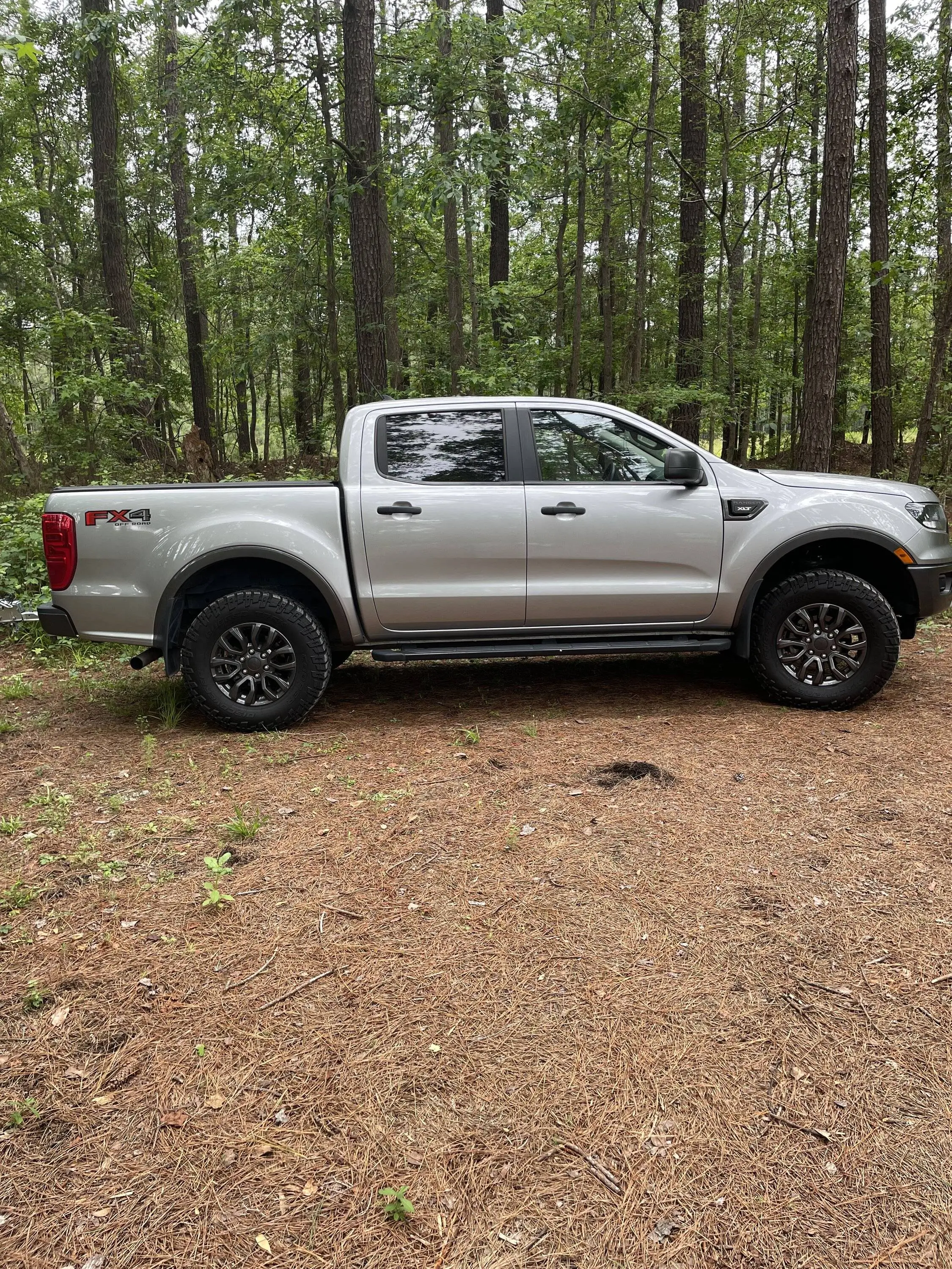

I just ordered these RC loaded struts and the Bilstein 5100 for rear. Was going to do 5100 all around but shops want too much to take spring off stock and put on new ($400 with install). I'll install the RC loaded strut myself. My question is with this being a 2.5" lift, does the back squat when you tow the boat? I tow an offroad camper with dirt bike on tongue and at times one in bed. I also bought the Sumo bump stop. I figured with the 5100s in rear and the sumo I should be ok with the front being so high. Really only wanted to go 2" in the front, but being cheap ended that. LOL I really don't rock crawl either. We take our offroad camper down pretty rough trails for a remote spot, then pull out the bikes and play.
One last question. I saw that some say the 5100s in rear actually lift the rear just a little bit. Did you notice that? or no? Would be great if it'd lift it about half an inch. then with Sumo I should be good for sure.
The squat is 3/4 inch. I’m guessing the tongue weight is a little over 350 when I picked it up. Didn’t weight it but lift 5 days a week and have a pretty good idea on weight. Hopefully the pictures attach.
Thanks that makes me worry less. I really only wanted 2 in in the dront. RC just so much cheaper and all I need.
Looks almost level. Front might be a bit high. Hard to tell with it not perfectly straight and in the road. I'm hoping the sumo will resolve that. If not I'll add a spring or something. Maybe airbag. Idk.

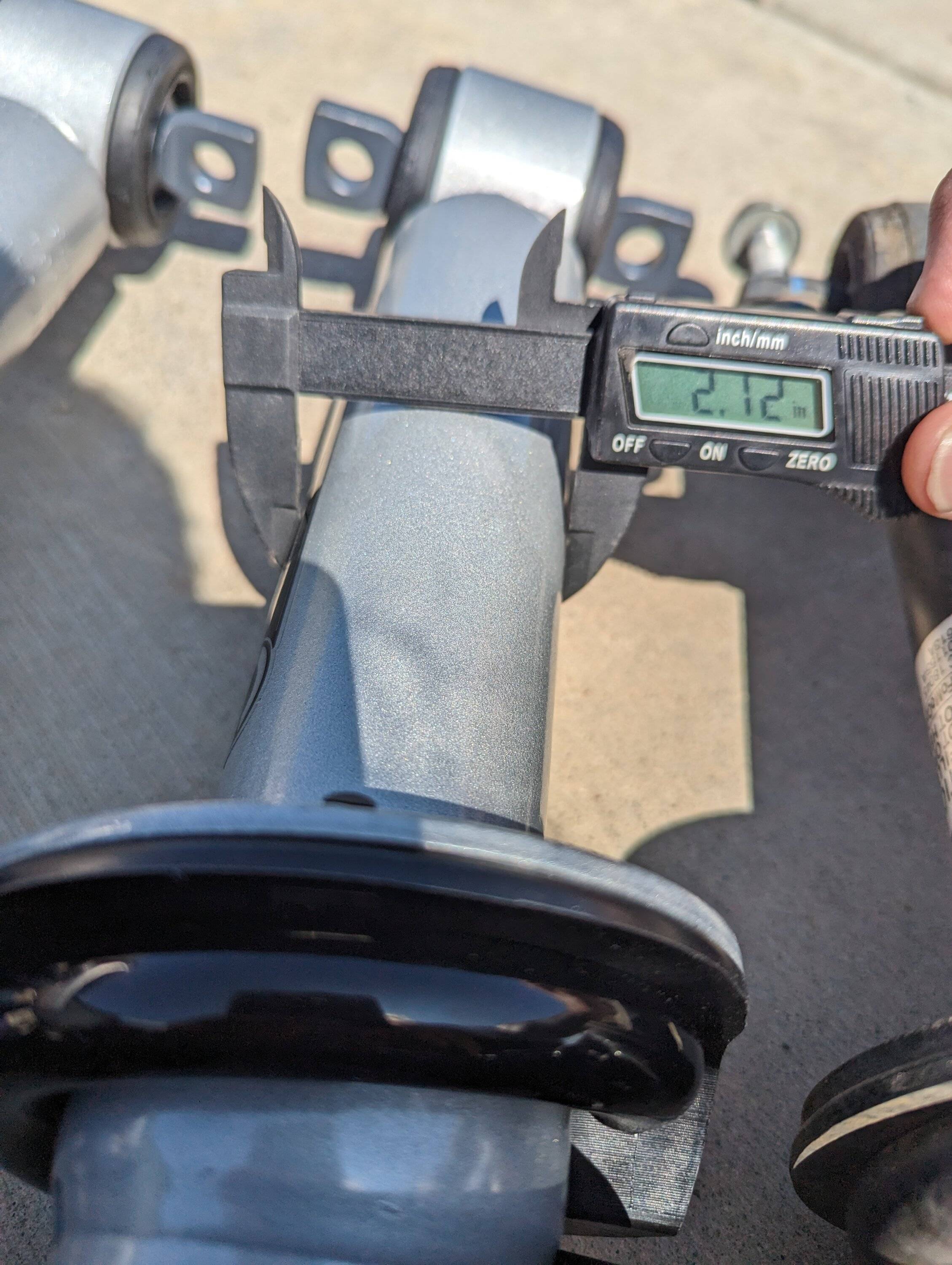

True. But also.doesnt mean it's absolutely trash either. Gotta find that balance for your needs. These coil over shocks from RC are 1/8 in thicker roughly and about 2.5 longer. I didn't measure length. Sitting next to the stock ones id be shocked if they aren't at least a minor upgrade. We'll see.

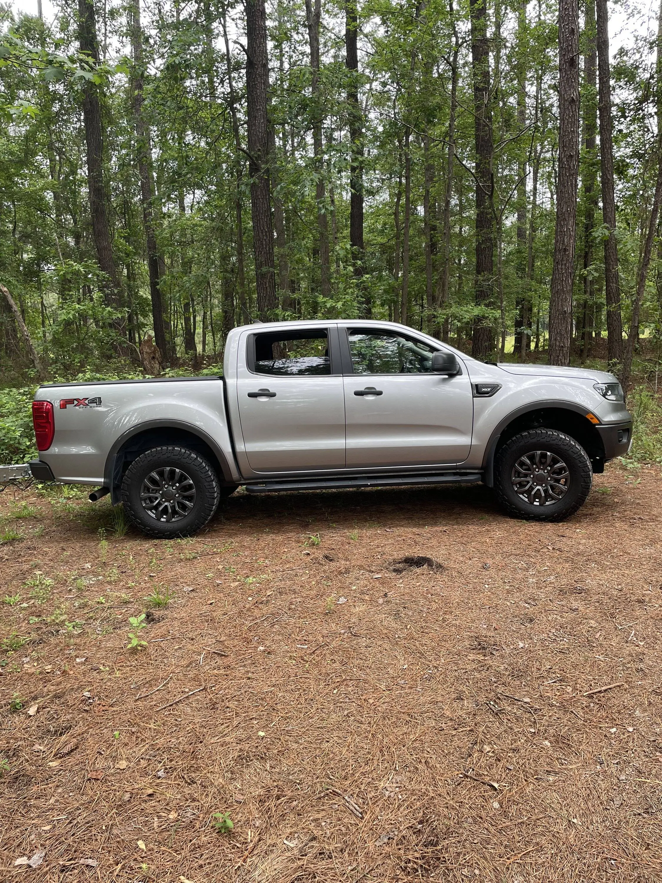

Currently sitting high in front. Haven't done alignment or put in Bilstein rear yet. I'm hoping the Bilstein raise it half an inch. Things might settle a bit once riding and aligned. Hope so. Not getting alignment till 5100s are in rear and they don't come in till Tuesday..... Patience time. I hate patience ?
