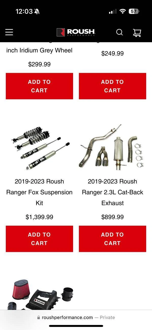

Do not spend $3200.00 on the ford performance ones… you could go on roush and get those ones they’re very close to the OEM tremor ones. (Claimed to be slightly different tuning to match the roush wheels.)
They’re adjustable 0-2”
Also camburg has a kit with the 2.0’s with the their tubular uca’s for less than 3200.00… so whatever you do don’t spend 3200 on fox 2.0’s ?.
