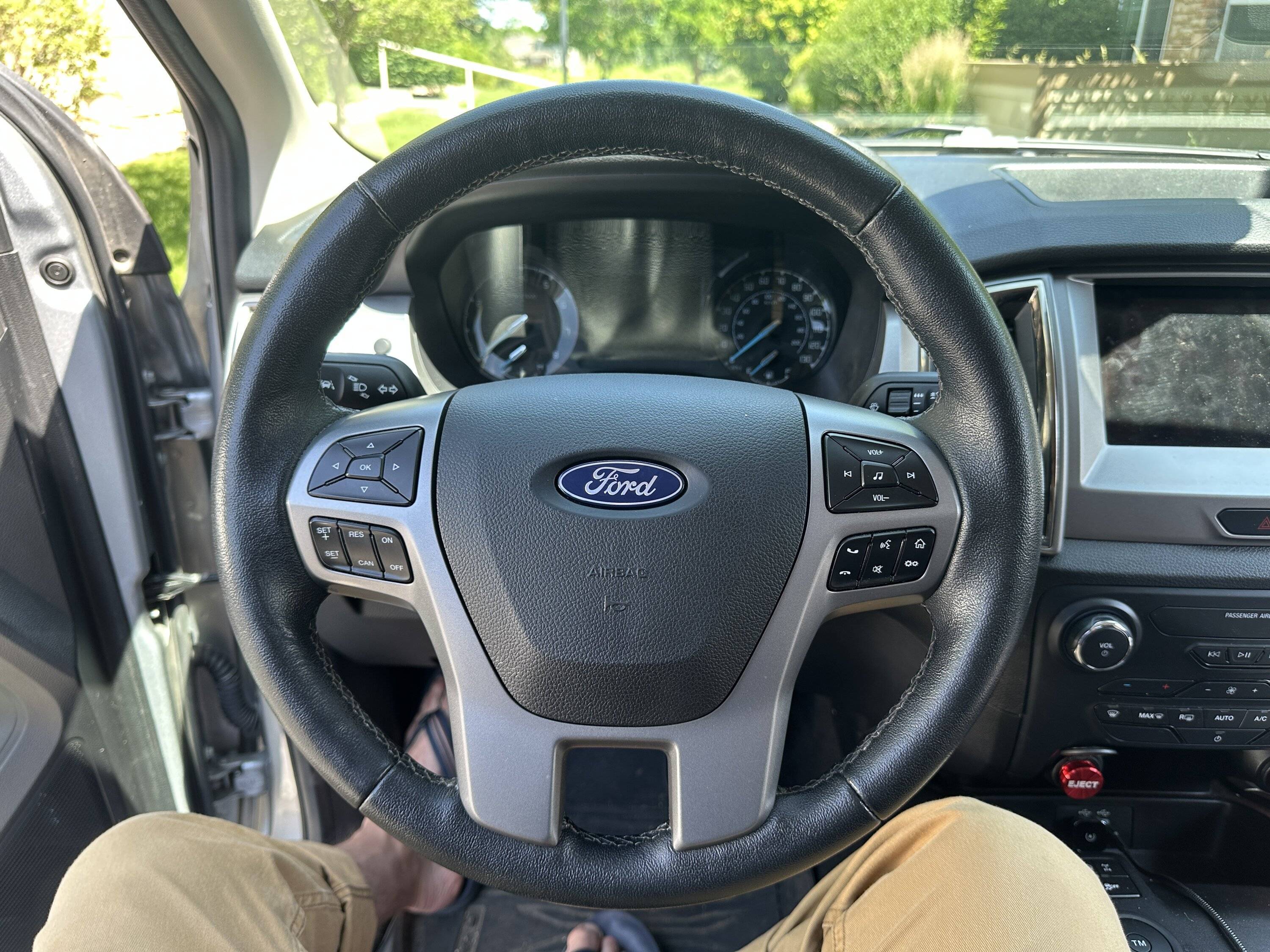

Nope. I’m in an XLT, with cheap plastic wheel. The new cover is 100% coverage. Left and right perforated leather is part of the new cover and top/bottom is alcantara. Stitching is new too. 100% wrap around. Check out their website. It does NOT make the grip too fat. About ~1mm increase. On mine it made it feel way sportier because it gave it a bit more girth.
Just to clarify...this is your original wheel and it's not leather? This is plastic with stitching? This looks identical to my optioned upgrade leather wheel from Ford...

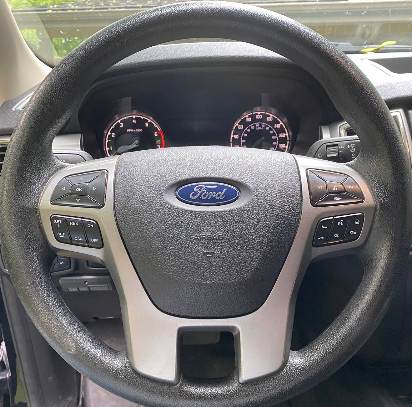

It looks like the leather wrapped wheel. I have the basic rubber/dead nauga version (no stitching) and it looks like this…
Yes. This is original.

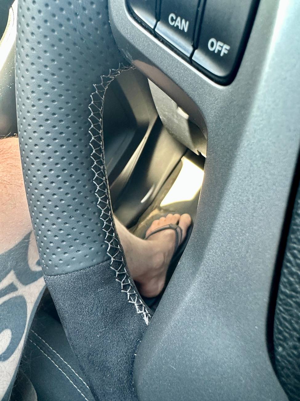

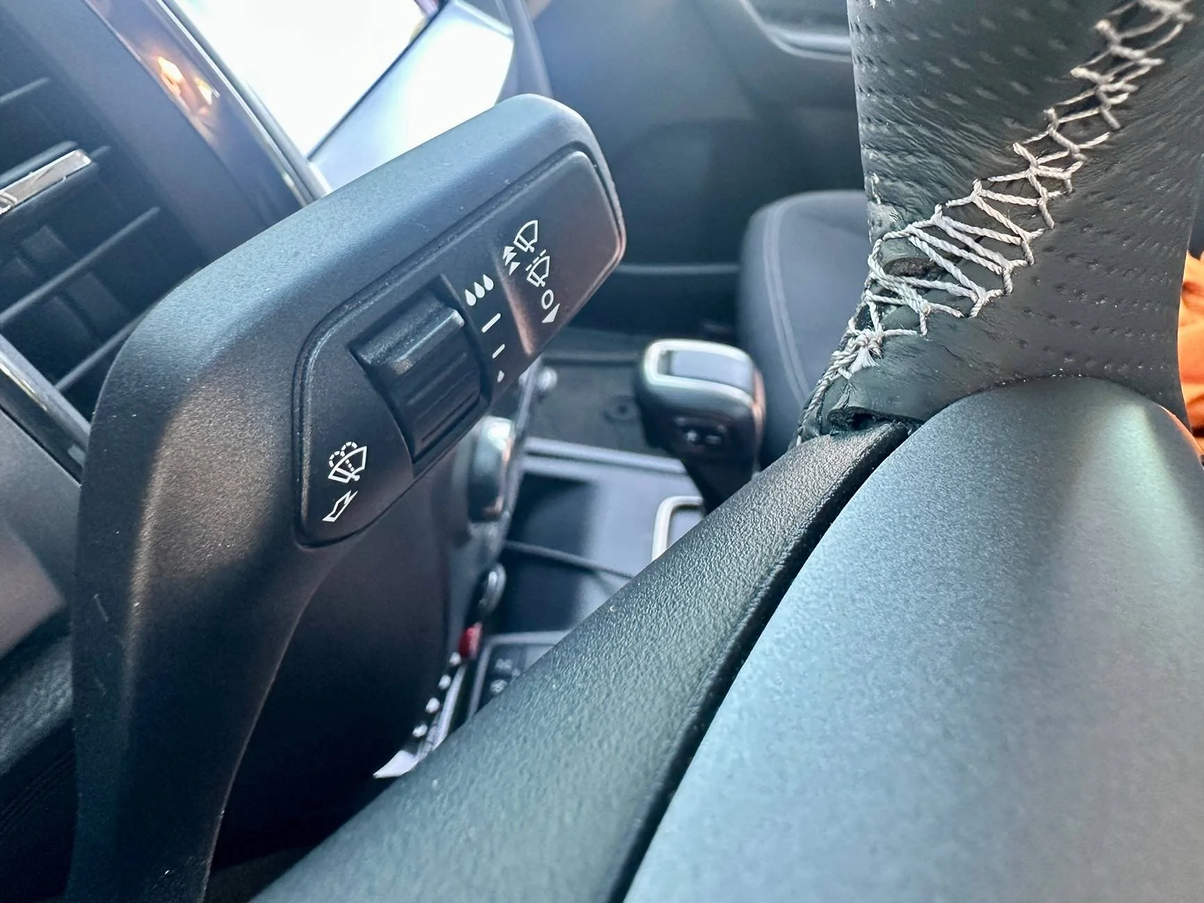

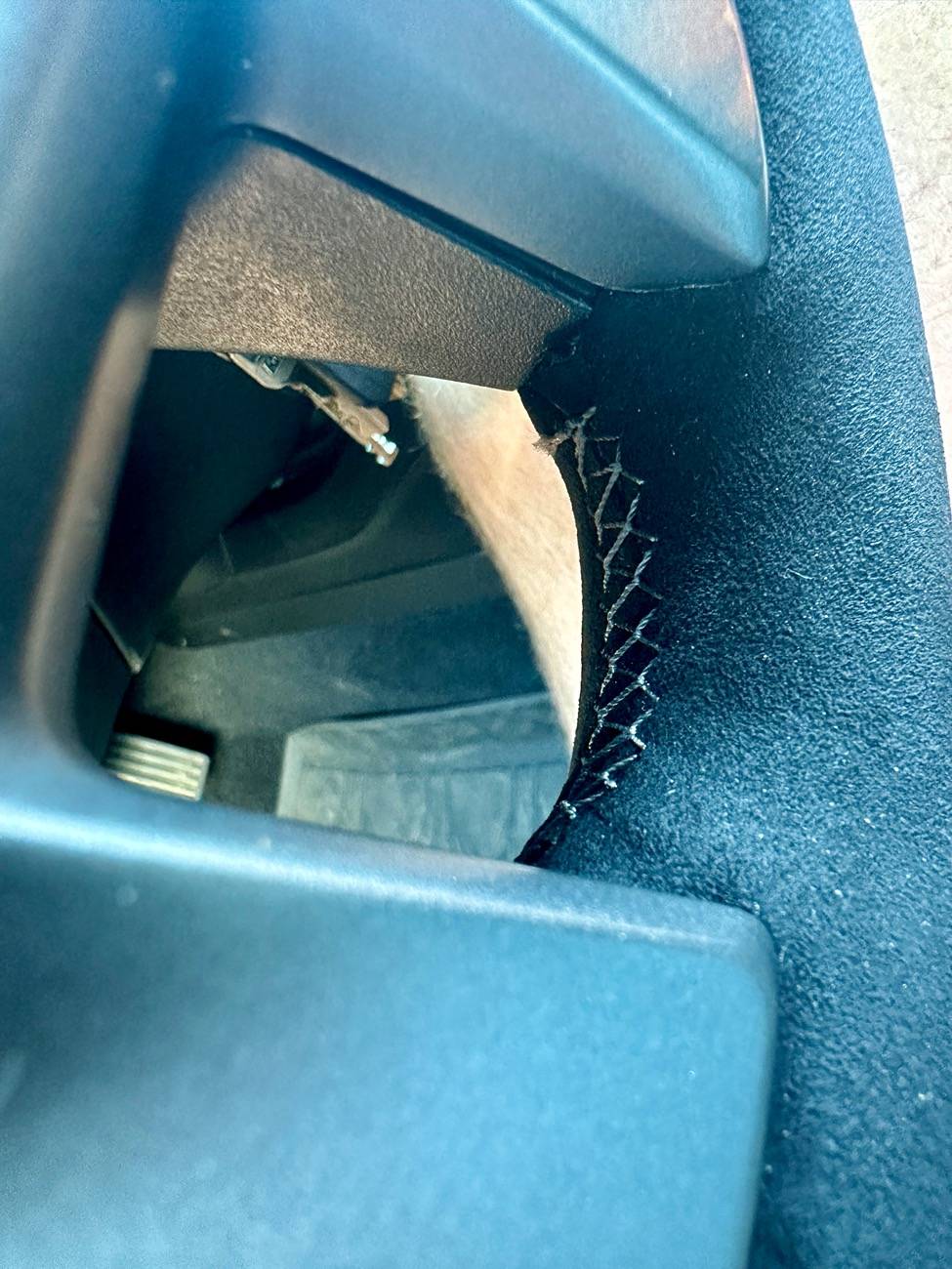

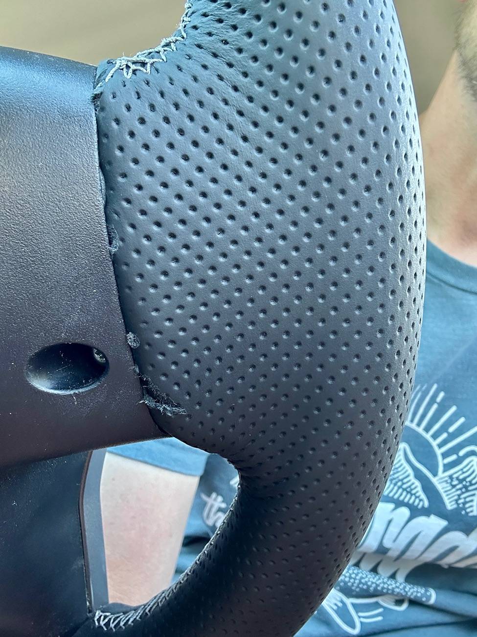

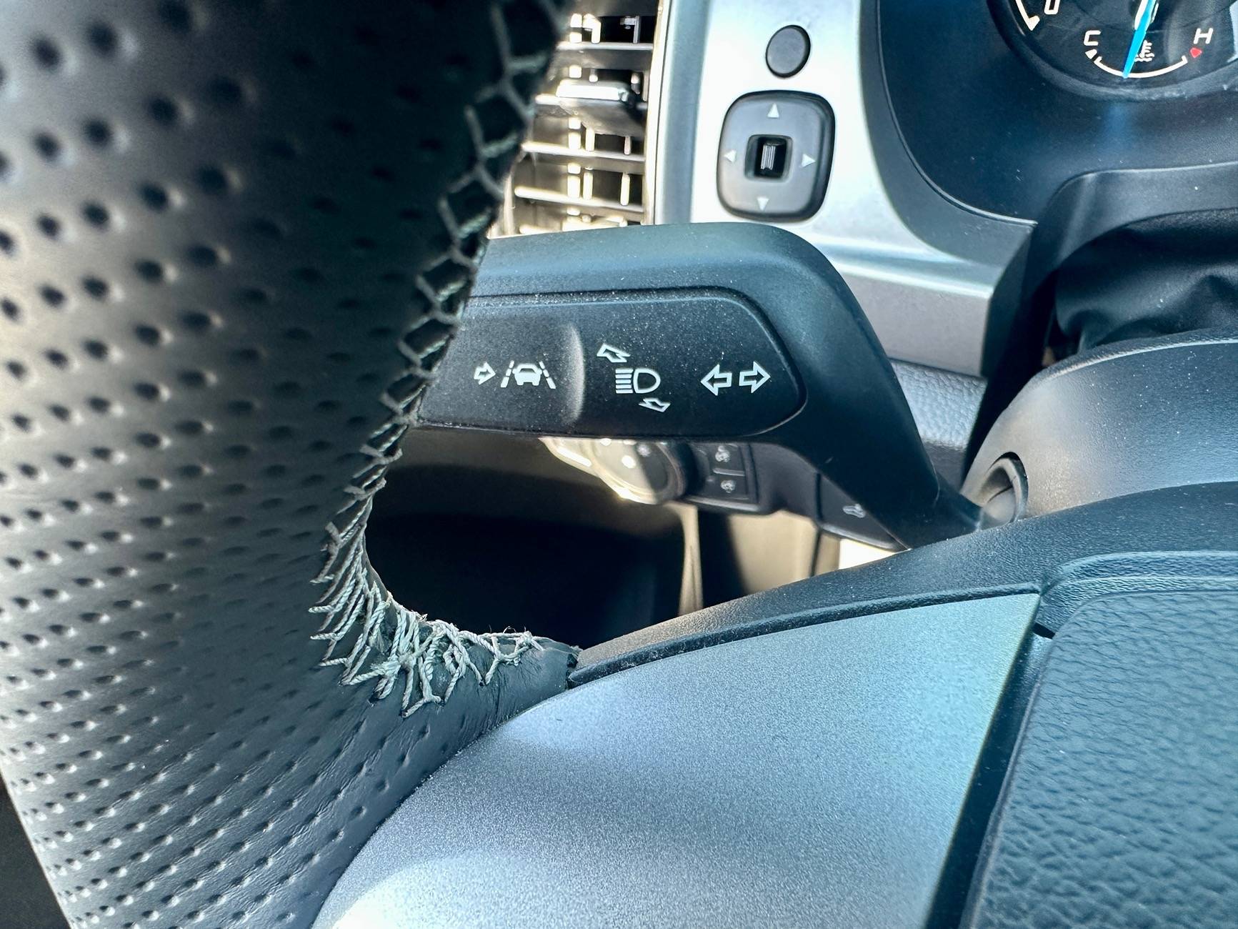

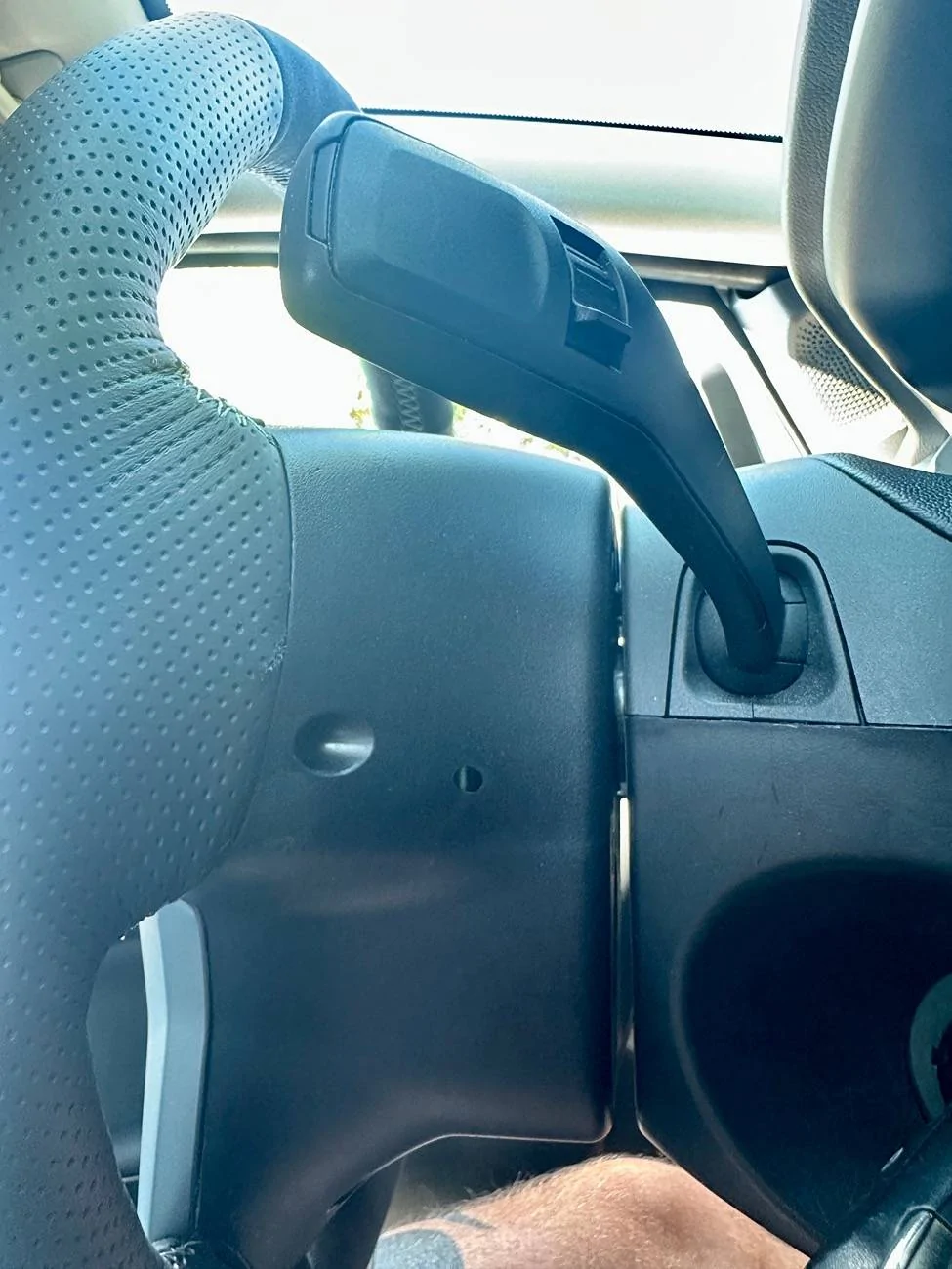

Here are some close ups of the install. It’s “good enough” for my first time. When it’s time to replace (because I get bored easily), the second install will be much cleaner as I’ve learned from the first one. Again, ten fold better than the shiny greasy looking shit it came with from the factory. The back got ripped because of user error. Should’ve watched more videos before starting. Started tucking first instead of sewing first. Start stitching FIRST and tucking once it got nice and snug around the steering wheel after stitching. Totally worth the few hours of wrenching and sprucing up my visual field and feel of the truck.

User error aside, I am blown away it came out so good looking.
