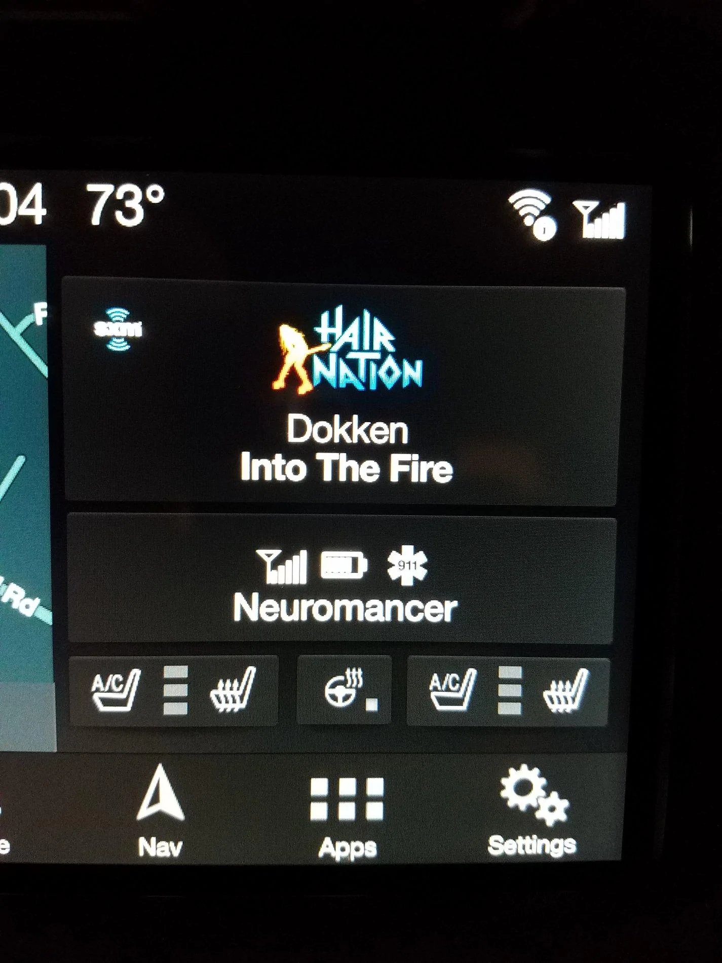

Even if it did work, how would it be turned on or off? Is the button normally right on the steering wheel?

It's on the sync screen.
Like stated above, when enabled, it's on the SYNC screen. You can enable the heated and cooled seats on the home screen as well.
I had a 2016 Explorer XLT with a heated steering wheel. I was turned on/off on the climate control screen.
